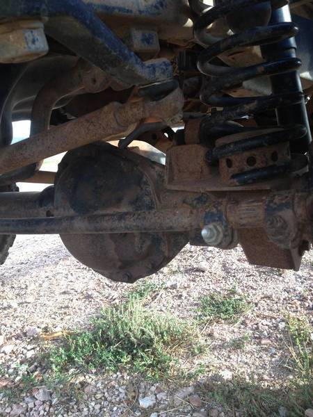

    Hi all,
    I recently purchased this '01 Tacoma and didn't realize when I bought it that it already had a SAS. Any help identifying which diff I have so I can buy some parts would be appreciated. This Toyota newbie had no clue that it wasn't stock until after I purchased it for a 'daily driver'. A clue pointing me in the right direction would be great, as I need a yoke for pinion shaft and several other parts.

    looks like a d30 literally with the links right out from under a cherokee any more pics of diff cover?

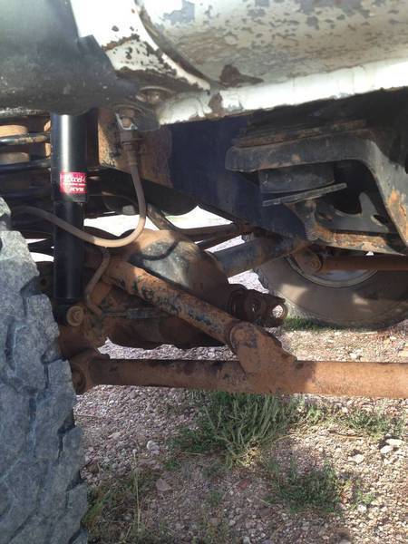

    Holy crap dude. that thing looks pretty scary. how does it drive? I would be very concerned for you if thats now your DD. Did it not come with a front drive shaft?
    How much did you pay for that thing? Any more pics?

    That front cover is not a Dana 30 on the OPs truck. Wrong bolt pattern on the cover.

    then its a jeep 44 out of a wrangler

    Ya, it's a pretty scary driver right now. The u joint on front drive shaft was literally ready to fall out, so I took it off until new ones show up. The tie rod ends are also shot, so I just drive my F350 until it's fixed.
    So best guess is its a Dana 44 out of a wrangler?

    If you really want to know what make this Dana came from, check the long side axle tube for the bill of material number. The number is stamped in and about a 1/4" tall. Will look like "605XXX-XX". The BOM will tell you the OEM and the original ratio.

    But no, that thing looks like a screaming metal death trap

    I was pretty sure that was a d30 at first because of the thin housing, till Bamatoy pointed out the bolt pattern. Most likely a d44, but I would ditch that thing as soon as you can, pretty scary... Looks to me like the steering arms are all rusted out too.
