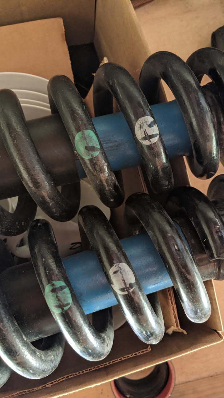

  14. Oct 14, 2020 at 9:55 AM
    Key-Rei
    Key-Rei Well-Known Member
    Jun 20, 2017
    #221942
    7,863
    Key
    Florida
    2010 TRD Off-Road 6Spd 4x4 209BSM
    Locker anytime Fog Lights anytime Full LED light conversion TRD cat back Rear cat delete Exaust Y reroute away from actuator Alloy Clutch master 2000 4Runner "Dog Leg" shift leaver Marlin shift seats and bushing Rear seat delete Rear diff breather extension Chrome grille swap Debadge Rear seat delete Honda blower motor beefy plug and wire mod Anytime 12v and USB with volt gauge in bed Blue Sea fuse box Hella AND 70's Caddy horns Low profile recessed hex drain plug swaps Alluminum battery strap 7pin relocated Backup cam on anytime Various other creature comfort and personal taste mods.

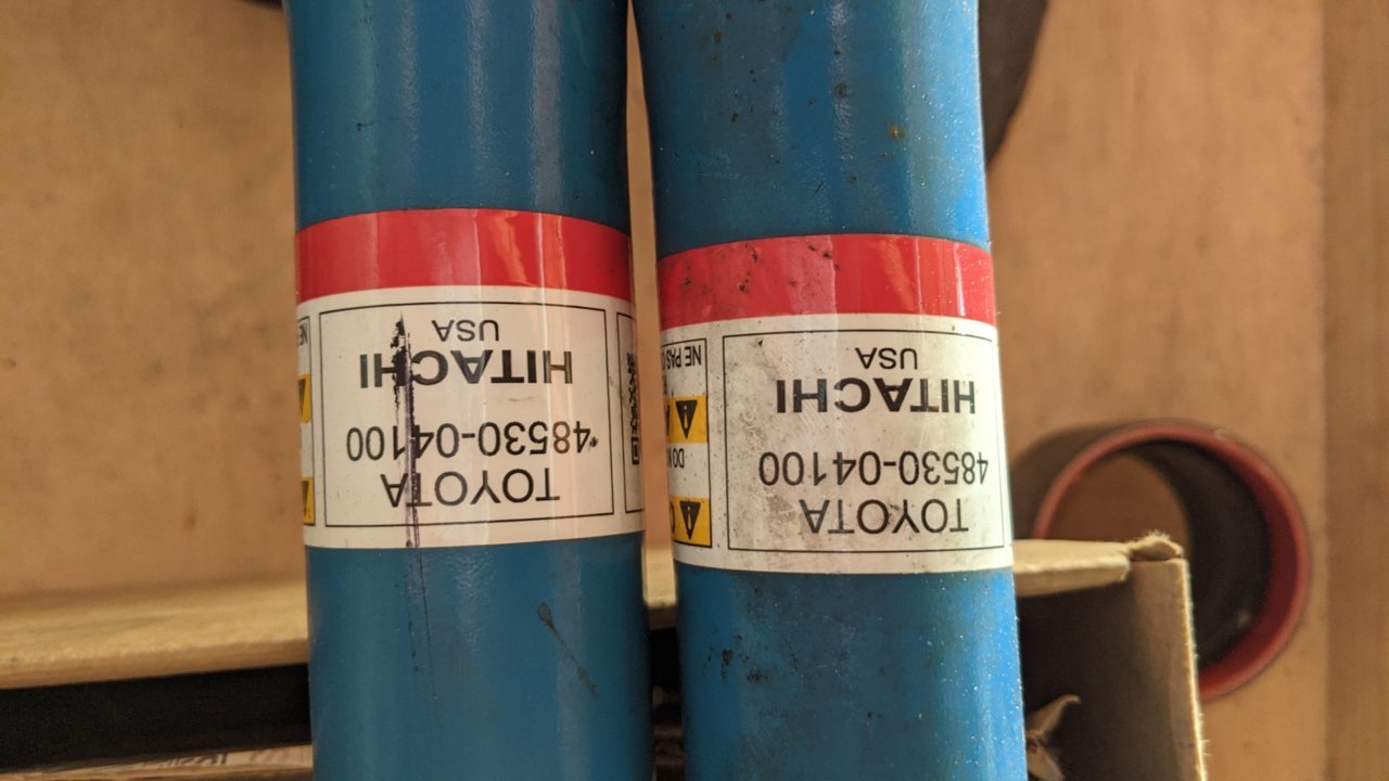

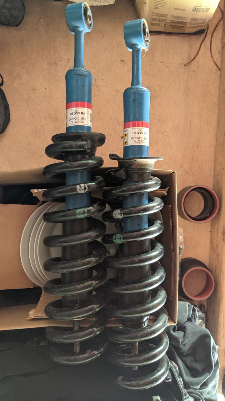

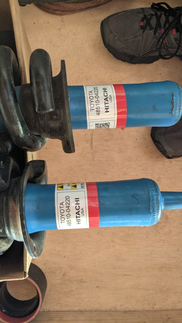

    Hey man, I did find them but now that I think about it, I want to say these are actually off of a TRD SPORT 4x4, but I do know for a fact they are off of a third gen as another member on here bought his third gen, and then turned around and brought it to me to put a lift on it, only payment I asked for was to keep his old suspension stuff. I had his rear leafs on my second gen before I got a set of Dakar MD leafs, and went 5100/OME 887 up front.
    I'm also including a picture of the part numbers for the rear shocks which you can see are the same, interestingly enough the paint marks on the springs and the part numbers for the shocks up front also appear to be identical. Does not appear to have a left or right side specific.
    :notsure:
    :thumbsup:
  15. Oct 30, 2020 at 2:25 PM
    Micbt25
    Micbt25 Well-Known Member
    Jan 12, 2020
    #315844
    602
    TM
    2015 MGM TRD Sport Access Cab 4X4 V6

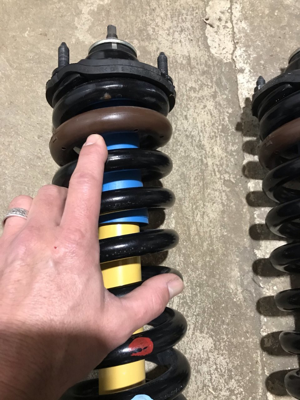

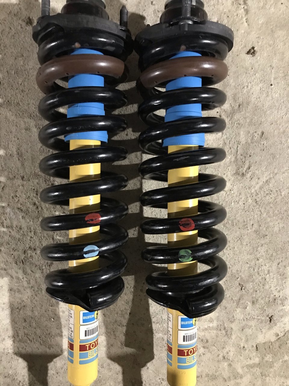

    Here are some pictures of the 3rd gens TRD Off Roads I bought, the one with the red and green dots on the right side of the picture is the drivers side. The passenger side shock assemblies have the red and blue dots. Also note the plastic insulator (Not really sure what they’re called) on the second from the top coil that I’m pointing to, these are not on the 2nd gens:

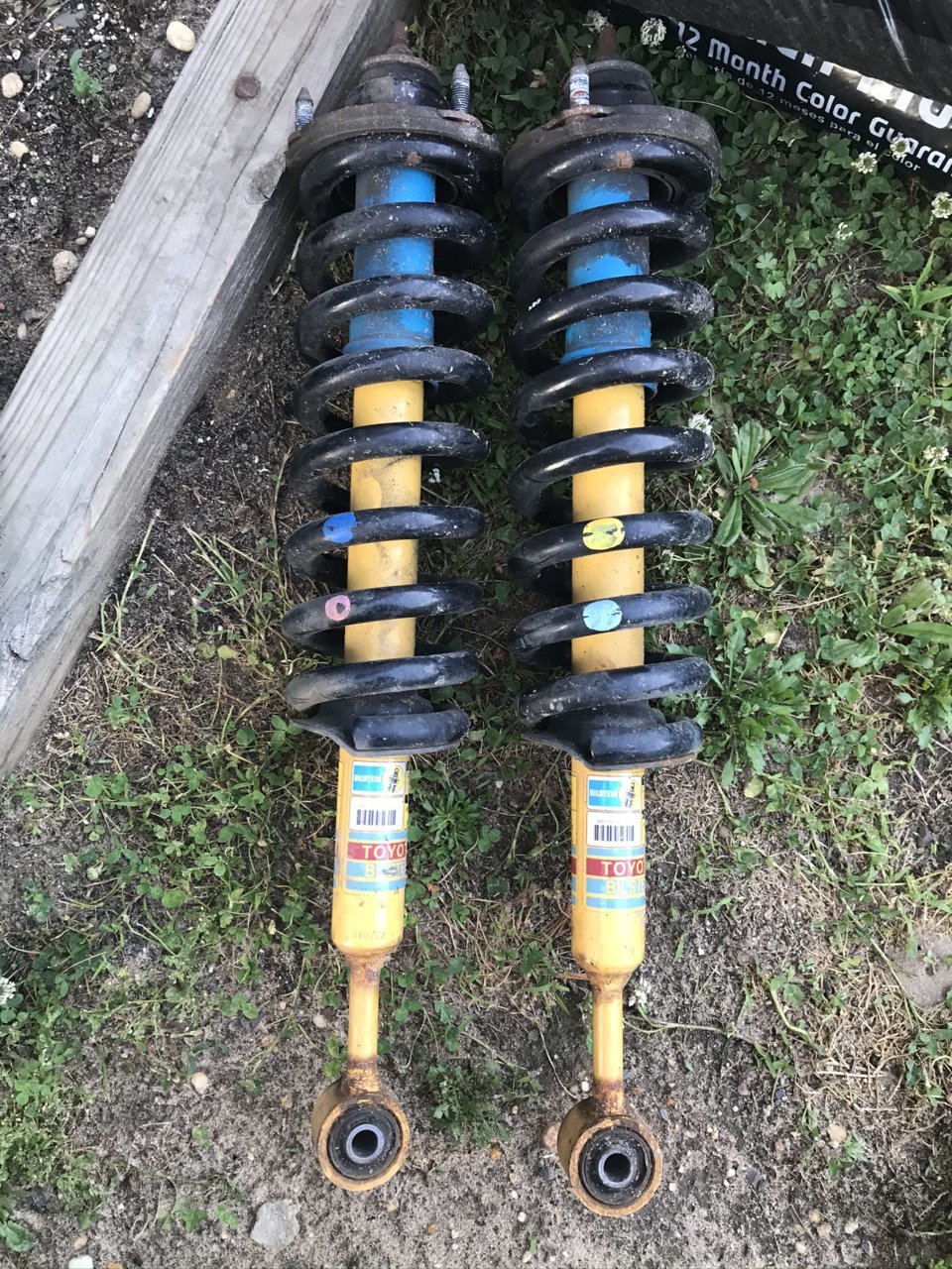

    Here are my old 2nd generation (Different color dots, no plastic insulators at the top and different color dots):
    deanosaurus and Philrab like this.
  16. Nov 3, 2020 at 8:46 AM
    #16
    dtxoreo
    dtxoreo [OP] Well-Known Member
    Sep 28, 2020
    #342153
    199
    Georgia
    '12 DC v6 4x4 / '03 Xtracab v6 4x4
    Perfect, exactly what I needed. Thank you fellas!
