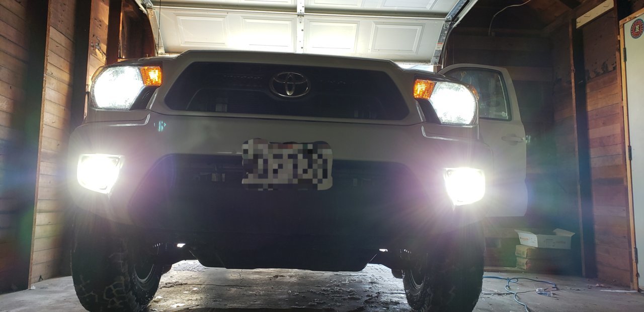

    You’re also blinding other drivers with your stock housings. Looks like you have halogen reflectors which are not designed for LED’s.
    OP, I would suggest some HID’s. The LED’s in our projectors do great, but they have no “throw”. They’re bright where the shine, but they don’t cast out very far making it essentially worthless IMO. I have been running DDM Tuning HID’s in my truck for a while now and they’re amazing. I have 4500k which is essentially the brightest on the spectrum, it’s pure white and lights up very nicely.
    DDM Tuning Plus 35W Premium HID kit, Slim AC Ballasts w / Hi-Output Bulbs, H11, 4500K https://www.amazon.com/dp/B01CJ70TOS/ref=cm_sw_r_cp_api_i_PdWBCb91WVE00

    OP, here is a snapshot of my lights. This is off my dash cam so it’s a little blurry because it gets bumpy on the road I live on. Just to give you an idea of how they light up.

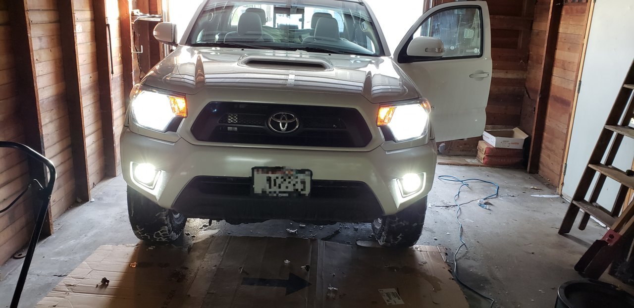

    Perhaps you're right! Haha. When it gets darker outside I'll takes some pictures. I dont think I used the correct words to describe what I was trying to say. I guess all I was saying is that, there is a huge difference between the stock halogen bulbs and these LEDs i installed. I'm getting way more distance and alot more illumination while I'm driving. Even with the stock housing, they are working fantastically.

    Those are horrible. Not only do you have massive losses in distance projection, you are also blinding everyone with glare. The reason street signs are lit up so far away is because you have lost beam control and effectively are running high beams everywhere you go with your glare, even while on low beam. Compound that with LED short wavelength light is hyper reflective off of street signs because short wavelength light scatters and you have tricked yourself into thinking you upgraded your lights when you have significantly downgraded them and are posing a danger to oncoming drivers. LEDs in a 3rd Gen projector just fail in distance projection because the projector cleans up the glare, in the 2nd gen and earlier reflectors they scatter light everywhere while also failing to project. See this thread:

    As mentioned this is due to loss of focus and loss of pattern. You are blinding everyone with your excessive glare.

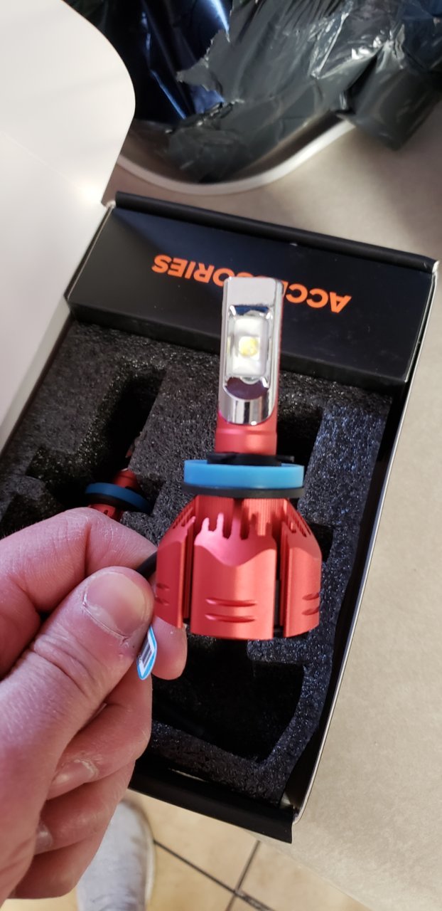

    There is no focus with an LED in a halogen housing. You are correct they lack required omni-directional output.
    The specs are way over inflated by cheap Chinese manufactures hoping you will buy into the hype, they are nowhere close to that. Add loss of focus and distance projection, non-uniform beam pattern, and they fall way short of even meeting the performance of a basic stock bulb at distance.
