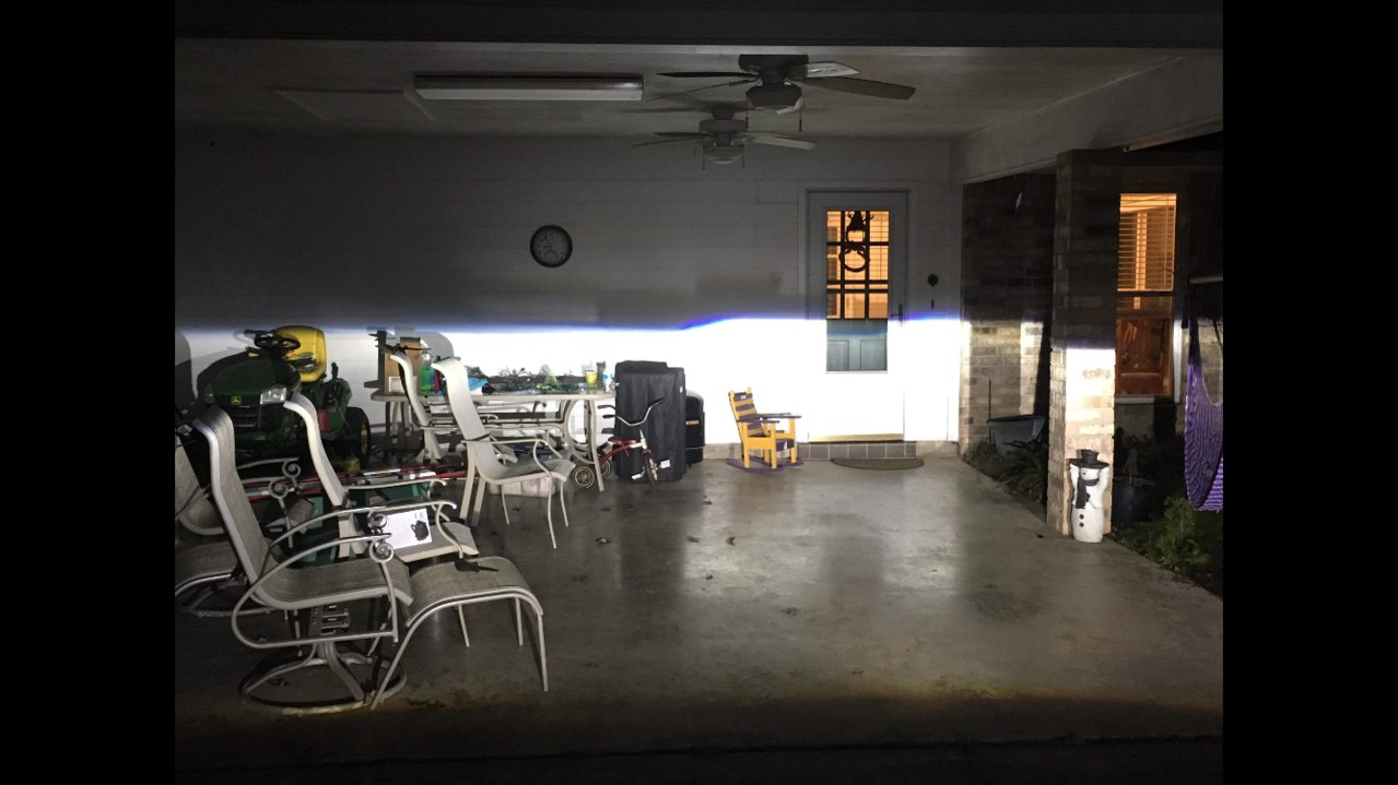

    HID for the win always.

    @SgtPuddin, they sure look bright! Not sure if I'm ready to spend the dough on a kit though.

    It’s expensive but my whole truck was expensive so that wasn’t an excuse in my eyes lol.
