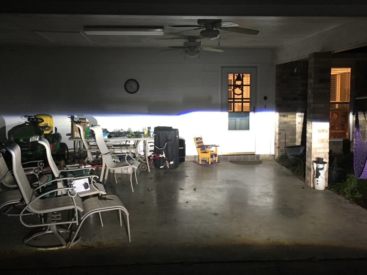

    All I have to say is you should definitely run hid’s in the stock projector and also convince many others to do the same. Funny how many other vehicles on the road have factory hid projectors and they don’t have squirrel spotters from the factory and their lights are legal from the factory. But what do I know, halogen projector really means insert hid bulb.
    Also to clarify both us and eu spec rx350 have no spotter. Only difference is the slant in the cutoff.

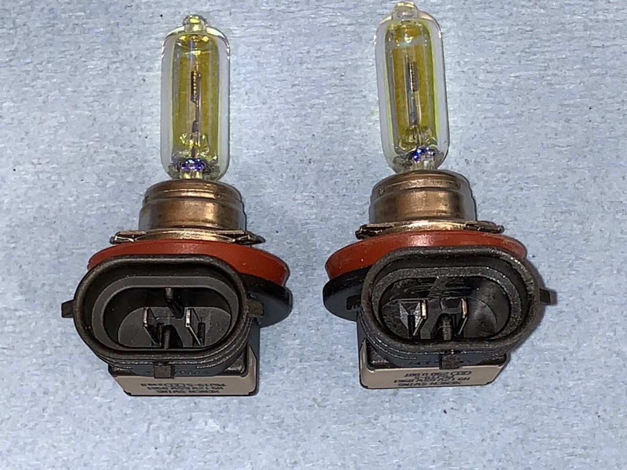

    For fuller beam output, use the Hella Osram Hyper H9s. These will require trimming a tab on the bulb or making a simple conversion harness for a few dollars like several have done.
    https://www.rallylights.com/hl78178-h9-12v-65w-xenon-bulb.html
    Different H9s, but the right bulb has the upper internal tab trimmed off using a small knife allowing it to plug into an H11 socket.

    Is that link correct that the Hella Osram Hyper H9s are only $9.14? That's the deal of the century for having to simply cut a tab to get them to fit an H11 harness!

    Yes that is correct. It is an absurdly good deal for the performance increase. The 2nd Gen guys pay 2x that for a Hyper bulb.

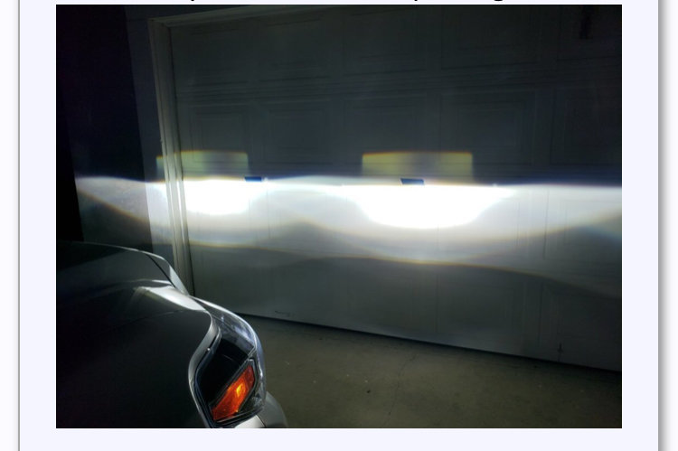

    Just dropping the H9 in, no. It will cause massive glare with no glare cap and the OEM fogs do not do a good job of glare control. But, if you do my Subaru fog mod, you get glare shields in the assembly like a headlight that while using a high power H9, actually produces less glare than the stock fogs. The Subaru pattern is much more forward facing though.
    You can see details in post #403 and afterward here. I still need to update the original post in that thread with the updated info.
    Not at all, once I've finished testing all the performance H9s I'll update the thread. I would run the Hellas, you will get a fuller beam pattern.
