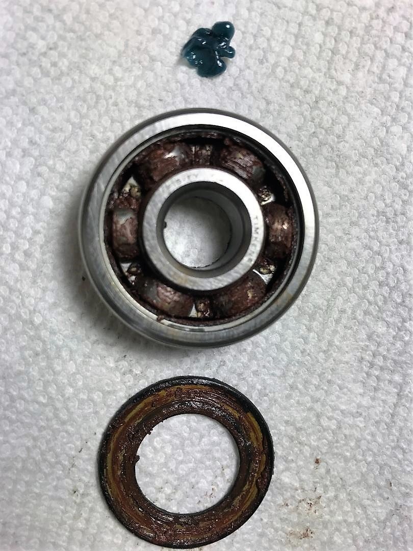

    It's a $9.50 fix to change out the 6301 2RS type double sealed bearing in the A/C idle pulley yourself. The OEM bearing in the pulley is usually a Nachi Japan: 6301-2NSE9 CM NACHI Brand Rubber Seal Ball Bearing 12x37x12 6301 2RS 6301RS: Amazon.com: Industrial & Scientific.
    EDIT: OP, verify the actual number on your bearing before ordering a new one. The 6301 2RS type bearing works on the 3.4L and 2.7L, but I am not positive that bearing works on your 2.4L. So be sure to verify your actual bearing number.
    If your OEM bearing is making noise, the inside will probably look similar to this Timken 6301 2RS bearing which started singing.
    Timken 6301-2RS repacked with WD-40 True Multi Purpose Grease failed after 1 year.jpg
    semco-inc, Kiloyard and skeezix like this.

    I wouldn't pay $40 for a pulley just because the bearing is wearing out. I would do what Leid said in the previous post. A decent bearing (I always use Timken 6301 2RS bearings) runs around $10. Do it yourself and you'll save a lot of money (current labor rate is $100+ per hour).
    Actually I've done this 3 or 4 times since 1990 by using a vise and a socket to push the old bearing out and the new bearing in. Takes about an hour from motor shut-off to motor restart to do the job. The hardest part of the job is the r&r of the splash plate under the front of the truck.
    I wouldn't wait too long to do this job. They do get noisy!
    Hope this helps!

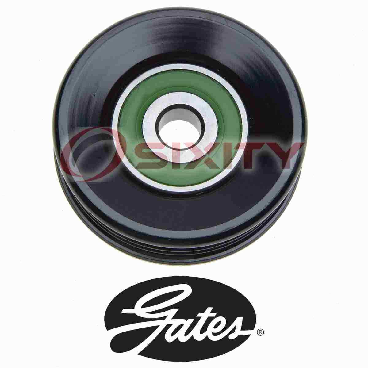

    I think you're confused....the $400 one is the one that mounts to the front of the actual PS pump....
    that does not have a bearing...its just mounted to the pump itself....
    so short of the actual pump failing ,no bearing
    That actual idle pulley thats adjustable is the $40 one, if you just get the gates replacement one....
    this and the A/C should be the same....and these do wear out, bearings fail maybe around 100K plus..
    unless they were over tightened at some time and caused pre-mature failure....
    those you can just get the gates replacement with a new bearing already in it....
    If the PS pump is failing somehow......you'd just swap that $400 pulley over to the new pump.....
    or more than likely the new aftermarket pump would already come with it...
    makes you wonder what a new oem pump is gonna set u back.....if it comes with a pulley thats $400 all by itself.........
    any chance you get a free pump....with the purchase of a $400 pulley....
    maybe they'll ever throw in a free rack...
    this is the one I bought for a 98 2.7L....the ac one is same for ps one...
    For Toyota Tacoma GATES DRIVEALIGN AC Accessory Drive Belt Tensioner Pulley a8 | eBay
