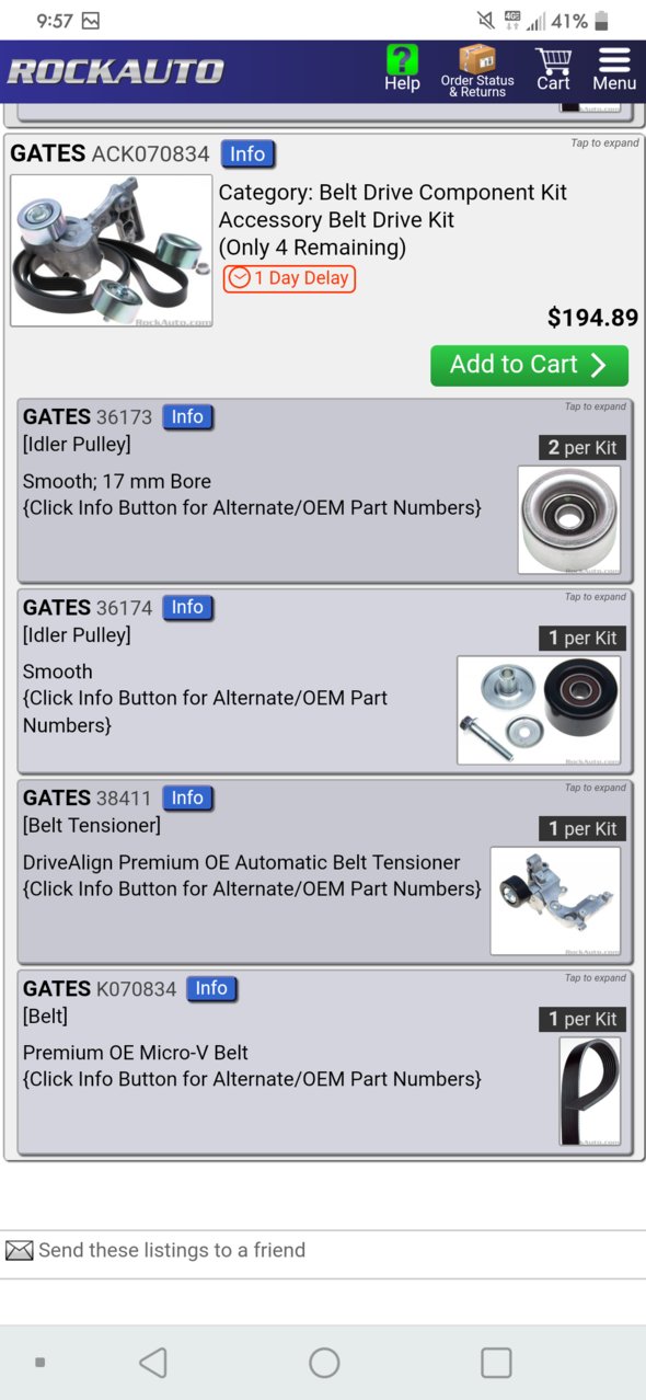

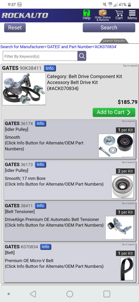

    Anyone ordered from @RockAuto lately? They have 2 kits with a $10 difference in price. Trying to figure out the difference as they have identical parts.

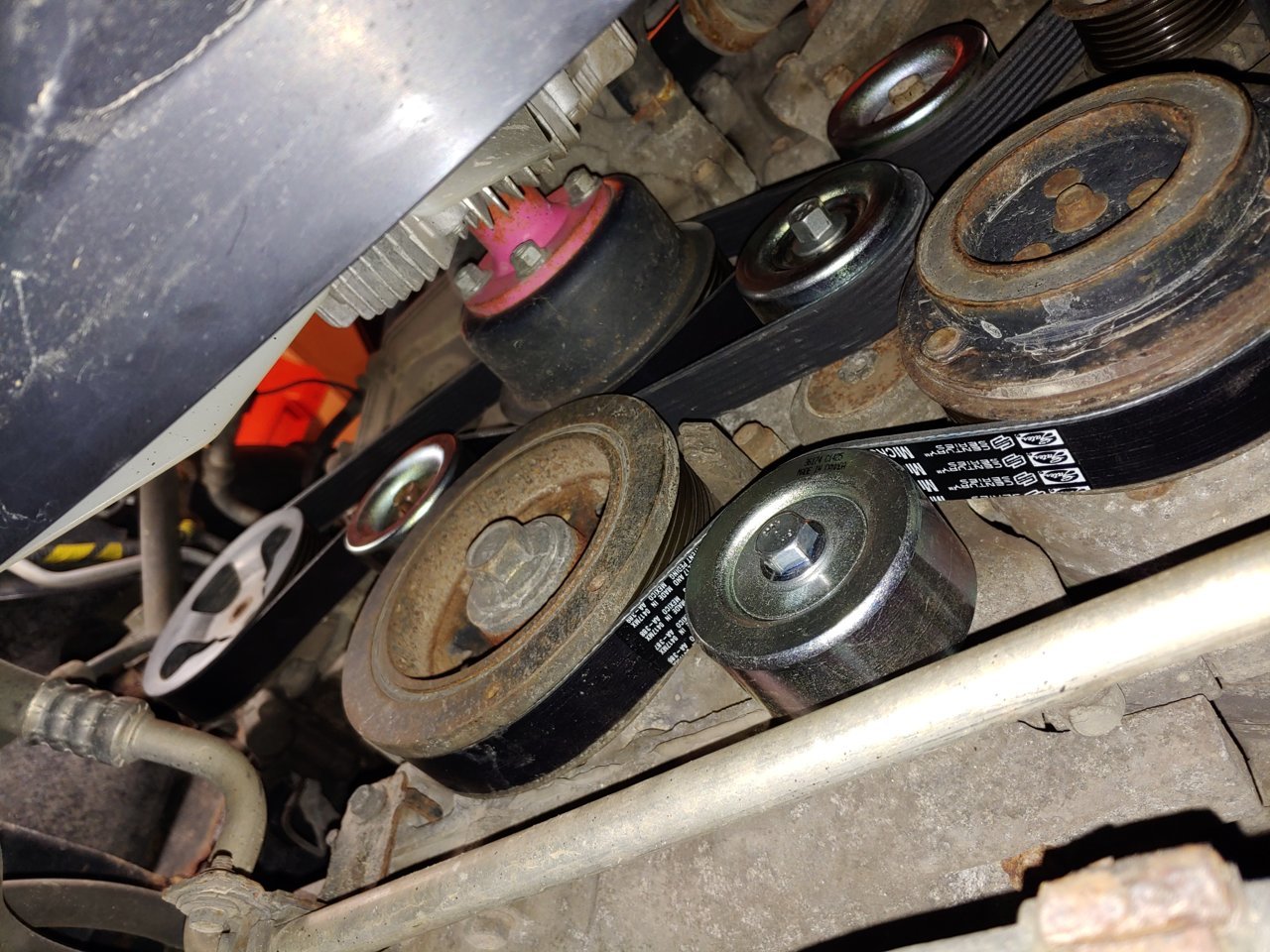

    Ordered the Rock Auto kit, everything went smooth. No issues with almost 5k miles on them.20190331_011527_HDR.jpg
