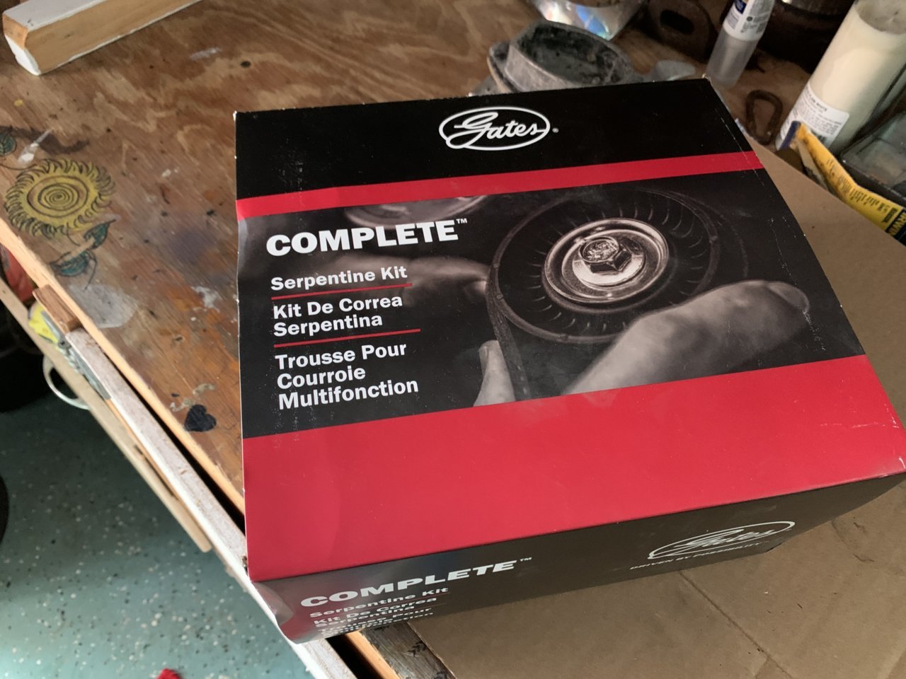

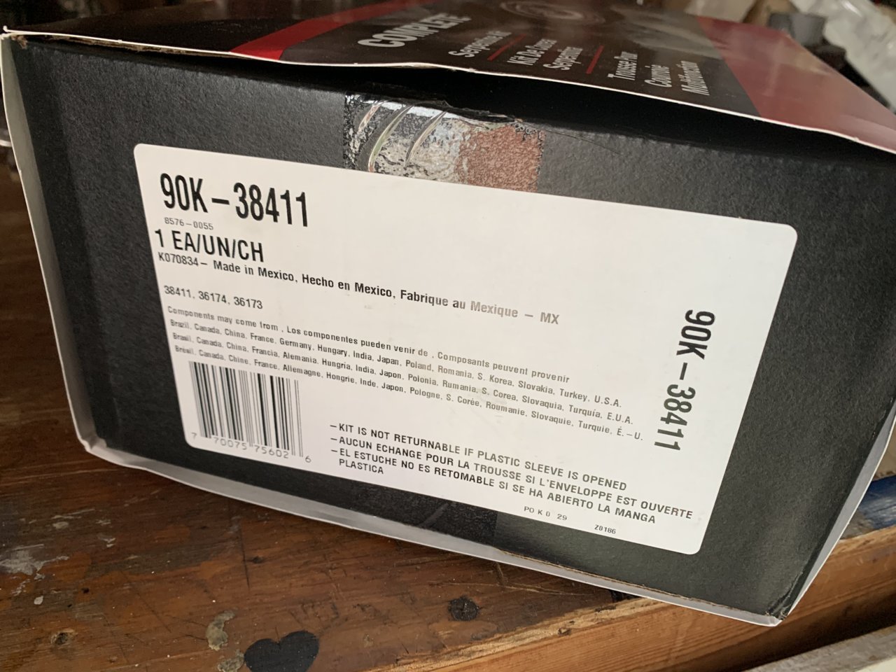

    I'll just add to this post (Again TY TacomaWorld :yay:) that I too just installed the pulley's only (removed the tensioner pulley from the assembly in the kit) using the Gates 90K38411 Kit, from Rock Auto ($185.79 >>$207.44 shipped to St. Augusitne FL) and it was simple as all the videos and writes ups indicate.
    I have no issues (knocking on wood) currently with the other accessories that need to be removed to get to the tensioner assembly bolts, so until I do, it will be on the shelf....
    The SWEET sound -of NO sound- upon first start up was a Merry Christmas to myself, and truck... :D
    grizquad likes this.

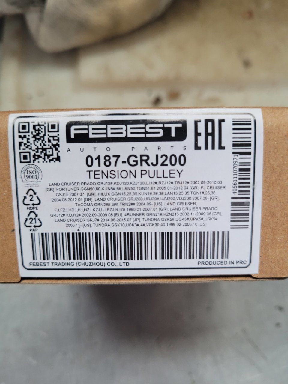

    Just changed all serpentine idler pulleys 2005 v6 4wd double cab at 250k. There was much debate about a correct replacement for the tensioner pulley. I bought this one on Amazon that was an exact match. 20230708_085552.jpg
    Kolter45, JBCjr and Crom like this.

    Let us know how long that lasts.

    Hang onto your old one and put a new bearing into it in case this one doesn’t hold up. It’s easy and relatively inexpensive to do.
