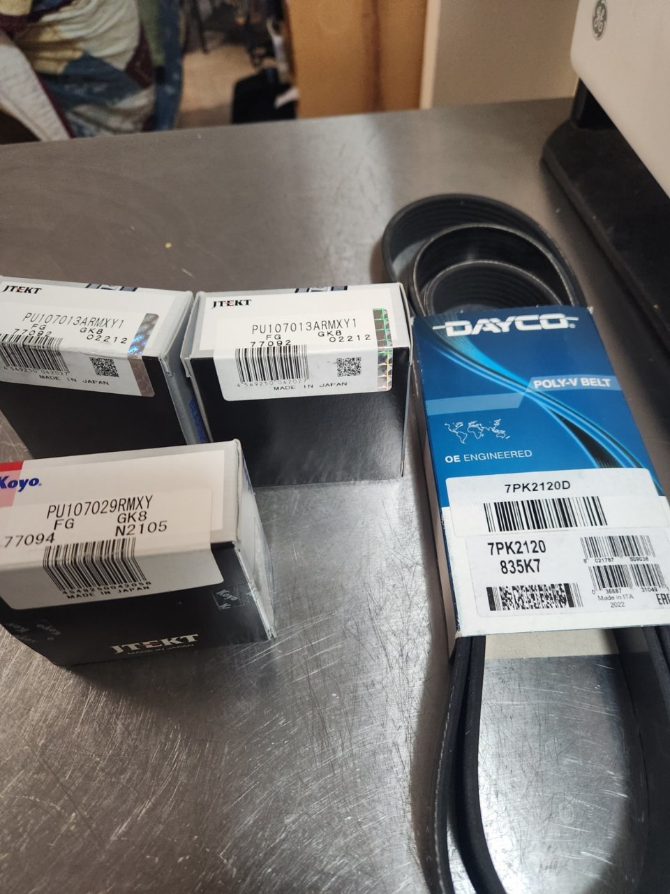

    So ordered the Ebay bearing and belt kit with Koyo bearings and Dayco belt . Downloaded WBA app and 2 of the bearing came back Koyo and 1 couldn't scan . Noticed the 2 the checked out good has the QR code and the one that couldn't scan just the bar code . Was $72 shipped

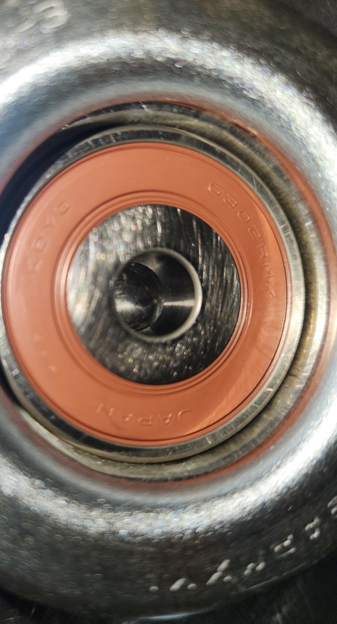

    So after looking @Chuy other thread the 6302rmx was only the sealed bearing so ... Dont know if bearing was pressed in a new pully and put in the bearing box since scan as good .
    But just going keep just in case .Ended up my bearing was good just routed belt wrong . Ran belt between PS pump and water pump ynder idler pully and belt snapped after 10000mi . Pully had rubber built up inline with groves in belt . Me:crazy:

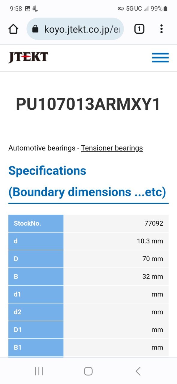

    @hemitruk I looked into the JTEKT company. The Japanese company formed upon the merger of Toyo Seiko (of Toyo Bearings) and Toyoda Machine Works in 2006. In 2009 JTEKT acquired the needle roller bearing division of Timken. Toyoda acquired Torsen in 2003, so Torsen is now part of JTEKT. So, JTEKT makes bearings but I was unable to find a legit catalog of them selling pulley/bearing units. I found several Chinese sites with them.
    https://www.prnewswire.com/news-rel...-acquisition-of-timken-division-80706827.html
    This link shows the change in the legit box design, from Koyo only, to JTEKT/Koyo.
    https://koyo.jtekt.co.jp/en/2023/02/news20230201.html

    Thanks for info . Yea box looks a little different put checked out as good on WBA app . I also looked on supposed Koyo jtek site and it listed it as tension earing . Bottom line I guess is to pick up from known distributors . Going keep set I brough if I need in future because idler pulls easy to change if it doesn't last . Tensioner will be buying oem or gates . Thanks for all your research .
