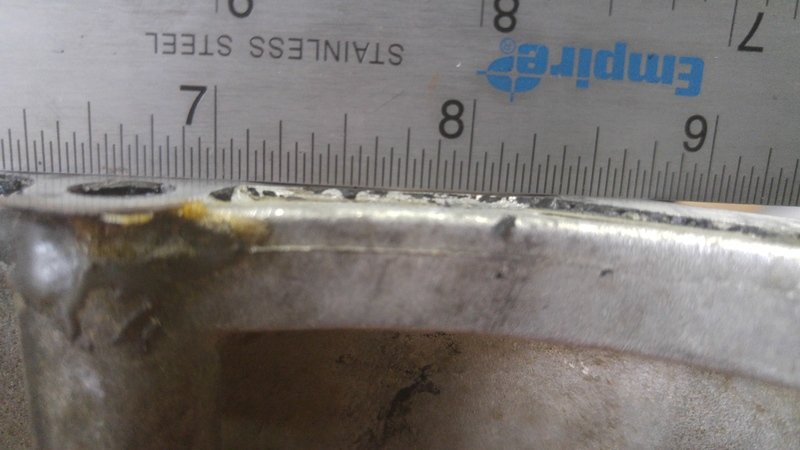

    Clean the area behind the power steering pump, on the timing cover. Use Permatex Mr. Gasket 1 minute gasket maker, and rub it into the mating surfaces with your finger. Leak no more.
    File off just a few thousandths from the power steering pump's top bolt hole, where it presses between the timing cover and head. So that it snuggly slides in and doesn't force the timing cover away from the head. Problem fixed. Unless you really do want to pull the timing cover, to reseal. Still perform the filing to the power steering unit.
    Also, I am using the Gates Racing serpentine belt if anyone is interested. However some will not, since it has one less rib than factory. Two of us have been using them for nearly two years straight. If anyone is interested.
    Crom and Lester Lugnut like this.

    I may try this. Not interested in tearing down my rig to fix such a slow leak but this seems doable. Thanks.

    I have a timing cover getting prepped to re-install on another engine of mine. I can take a picture of the area that is the reason for the leak. Two part problem.

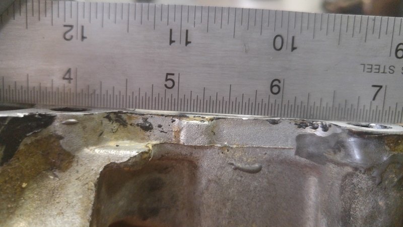

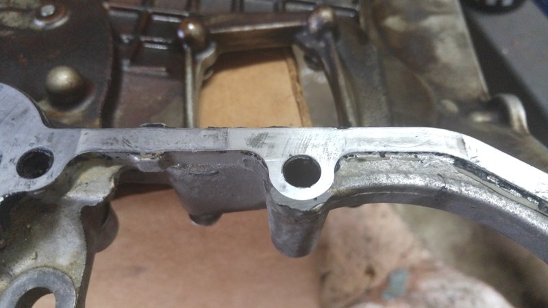

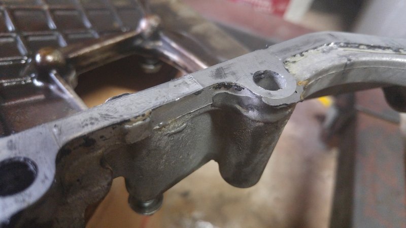

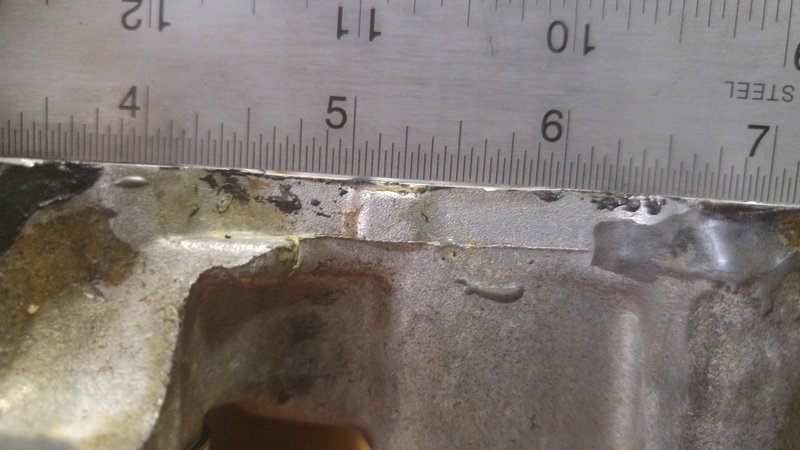

    Sorry for the delay in getting these pictures. I'll post them elsewhere as well. Not sure why I never took pictures prior to now, but at least now I have them and can share them.
    Here are the two machined locations, on the mating surface of the timing cover, in the location of where the power steering pump resides. As well as where the tsb fix is for.
    Here you can clearly see how the mating surface is not even. The first picture is of the gap closest to the top of the timing cover. The second and third pictures are the next slot a little lower.
