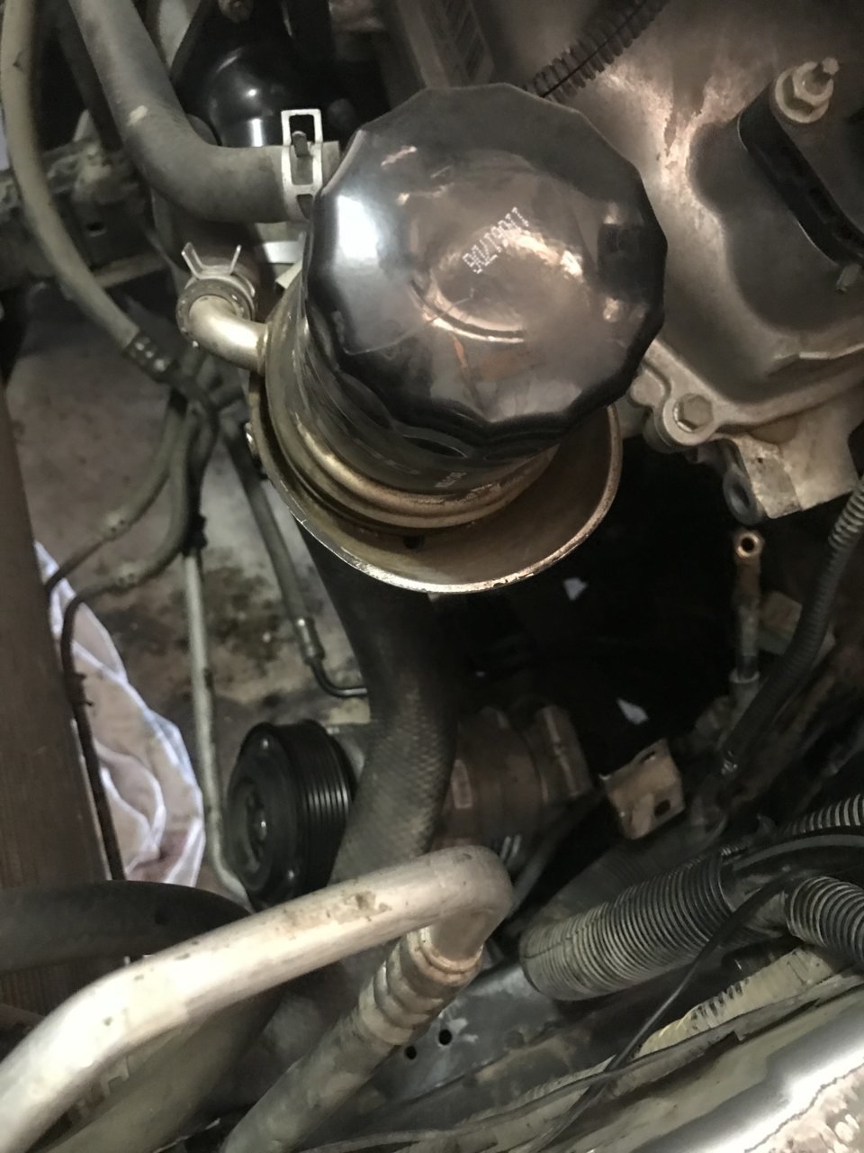

    I concur this job sucks. That tensioner pully sucks. I didn't have a way to take the fan off so I pulled the alternator through the wheel well. I found getting into the alternator ac compressor and tensioner was easier in some spots this way. I found a different step by step online with pics

    You couldn’t remove the fan? I didn’t replace my tensioner but I kinda regret that lol

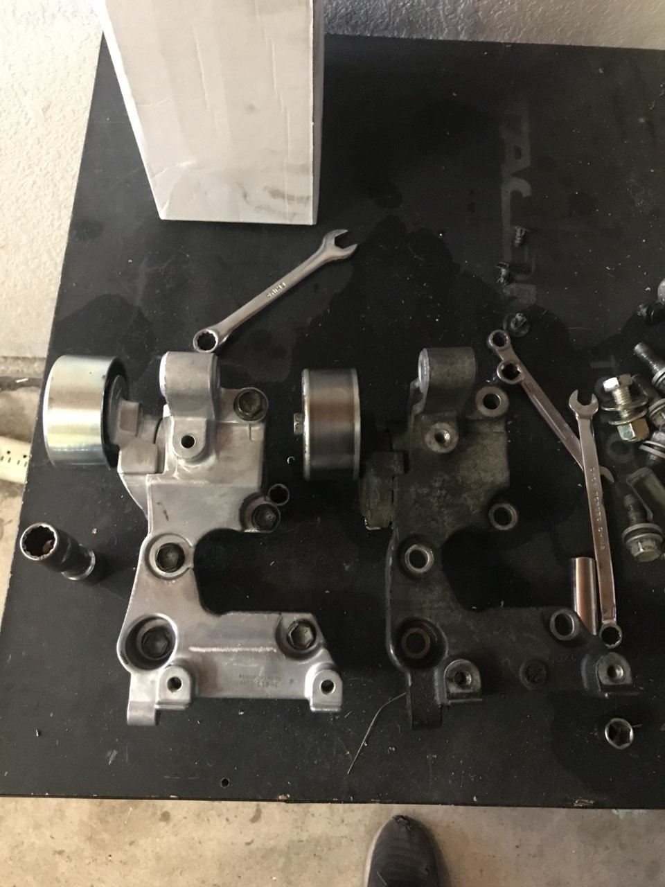

    Replaced the tensioner today. Worst job I’ve ever had to do !

    Is the tensioner worse than the rear brake lines? Looking to swap my belt finally and may change out the pulleys because they’re still oem
  16. Aug 12, 2018 at 6:33 AM
    #136
    anthony250f
    anthony250f Well-Known Member
    Feb 18, 2012
    #73066
    16,779
    Anthony
    San Diego, CA
    2008 dcsb trd offroad 4wd
    So much worse
    Just to give you an idea
    -remove battery
    -remove skid plate
    -remove alternator
    -unbolt ac compressor (bolts impossible to reach)
    - remove fan and fan shroud.
    -remove tensioner.
    It took me 4.5 hour to do solo.

    Get s stethescope. That’s how I found out my tensioner was bad. I haven’t drove the truck yet but I’m 90% sure this will fix my loud knocking sound.

    My tensioner was bad. I replaced the bearing but that didn’t fix my issue.
