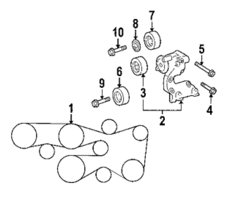

    Does anyone have part numbers for new bolts/shields for 36173?
    Want to replace #8, #9 & #10 in diagram for pulleys.

  5. Sep 12, 2018 at 12:42 PM
    #145
    05Taco4x4
    05Taco4x4 ToyotaHubs
    Jun 29, 2011
    #59085
    6,280
    2TR-FE Enthusiast
    FJ Tcase, Manual Hubs, 2017 Head unit, Mirror Riser
    1GR-FE
    Cover Plate - 16659-AD010
    Bolt - 90105-A0126 (for both)

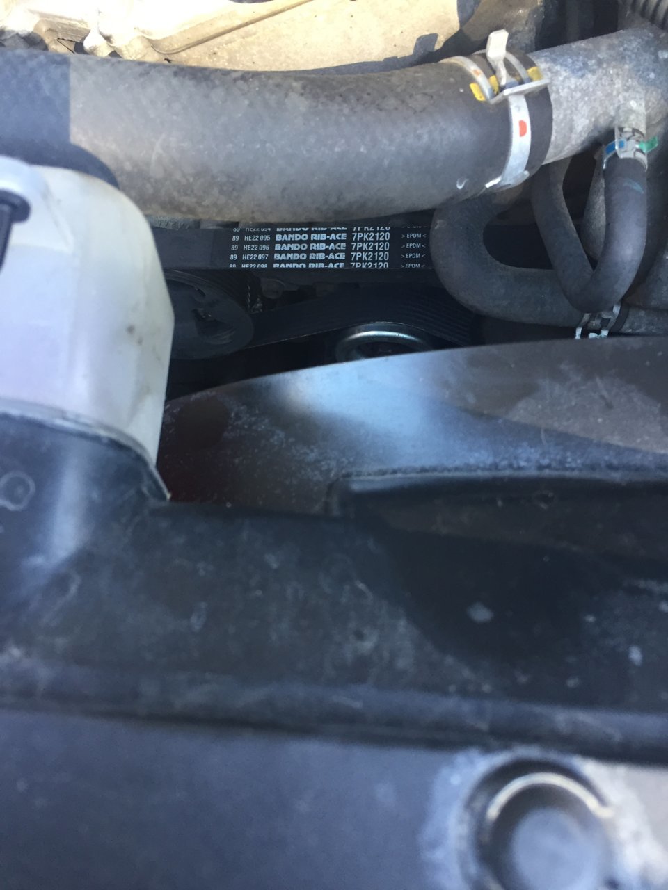

  10. Oct 4, 2018 at 11:56 AM
    #150
    TheDevilYouLove
    TheDevilYouLove You can’t polish a turd, but you can polish a TRD
    May 26, 2016
    #187953
    2,886
    Steve
    Marylandistan
    2010 Tacoma TRD Sport Access cab 4x4 silver streak
    I did the belt and three idlers. Easy and fun job! Bando belt is good to go!
    lo2hi likes this.

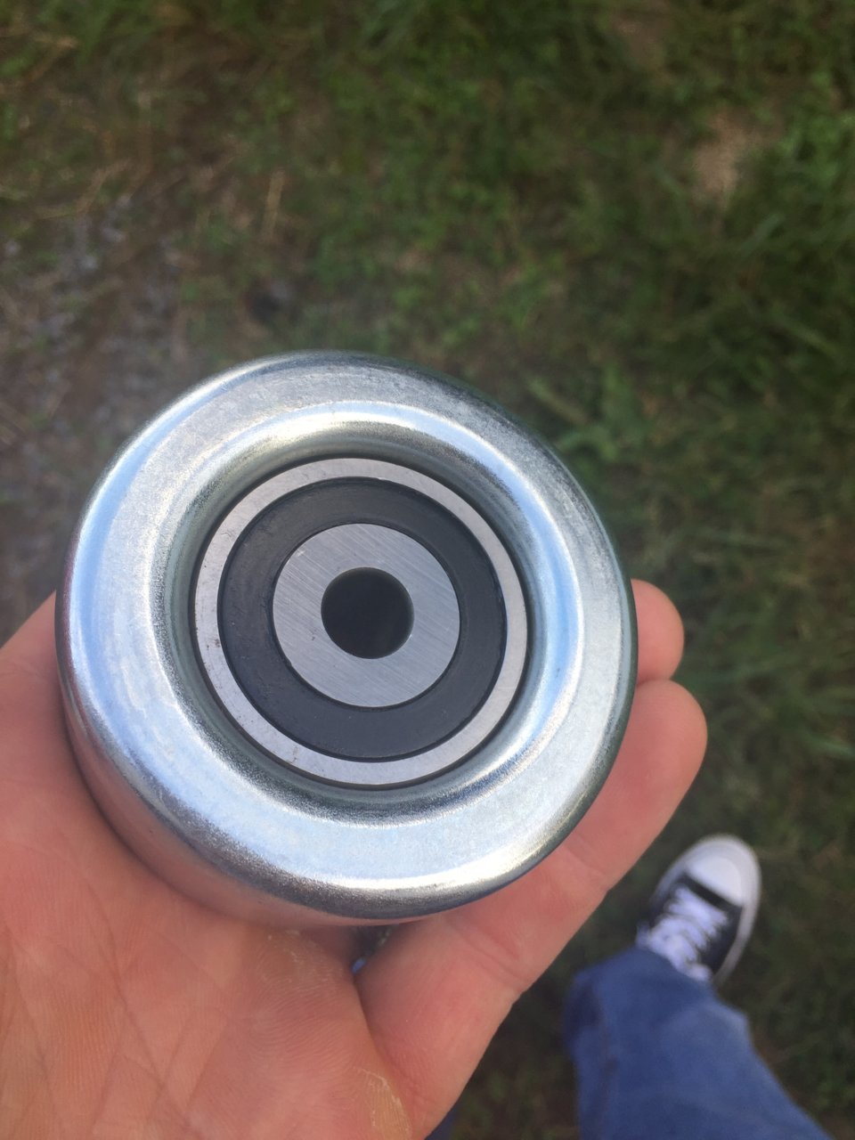

  15. Oct 5, 2018 at 6:11 AM
    #155
    TheDevilYouLove
    May 26, 2016
    #187953
    2,886
    Steve
    Marylandistan
    The Chinese would never steal from another nation!!
    J/K, yeah you're prolly right. I'll post pics when they get here. I'll be happy if I can press out the fake bearings and press in the correct Japanese bearings and have it work. Otherwise I'm out $20, sucks but not the end of the world.

  17. Oct 9, 2018 at 5:15 PM
    #157
    TheDevilYouLove
    May 26, 2016
    #187953
    2,886
    Steve
    Marylandistan
    This is what they sent me. Doesn’t say Japan on it anywhere
    lo2hi likes this.

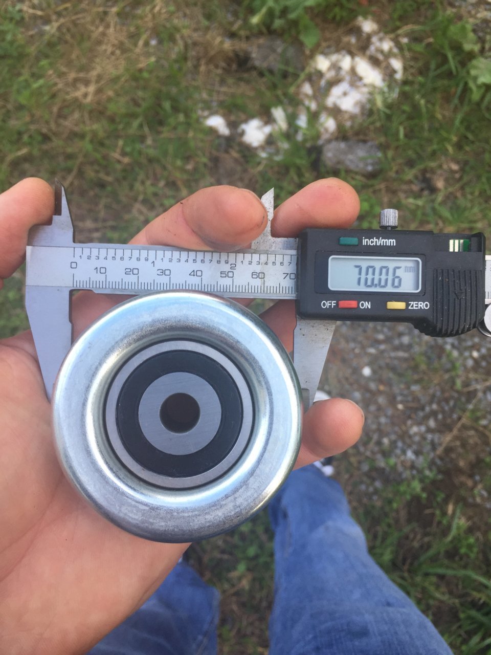

  18. Oct 9, 2018 at 5:35 PM
    #158
    07 sport 4x4
    07 sport 4x4 Well-Known Member
    Dec 24, 2010
    #48165
    1,453
    Blake
    Southeast
    2017 Duramax
    Is that a fit for the lower idler? It’s not a tensioner pulley for sure. :annoyed:
  19. Oct 10, 2018 at 3:50 AM
    #159
    TheDevilYouLove
    May 26, 2016
    #187953
    2,886
    Steve
    Marylandistan
    Why do you say that? Is there something different about tension pulleys? I think this would work but obviously it’s not Toyota quality.
    ETA: According to Amazon, the Gates lower idler pulley (36174) is 70mm in diameter and so is this ebay pulley. So maybe this is the lower idler?
