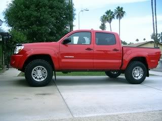

    i have a set of 5100's in the mail now. i have the rear spring TSB done and i'm hoping i can set the 5100's to 2.5" and it will be level. i dont want the front end to be higher than the back. did you settle on 1.75 because the front was too high? do you have the TSB done?

    I had the TSB done and have my 5100s set at .85 front, and after about three good loads it is setting maybe a 1/4" higher in back.. Actually looks level...

    Yo, brother ND. I'm skeptical about a lot of people on the TN board and this one who did the 2.5 setting on those 5100's and said they were level. Perhaps my truck was built on the moon but myself and others have it set at 1.75 and STILL the front is 1/2" higher than the rear.
    I waited for months now to see about suspension settling and still the same. I ordered the Toytec 1" lift block for the rear and will install that this weekend. This should give me a 1/2" rake toward the front which is how I like it.
    If I were you bro I would NOT go over 1.75...in fact if I would do it again I would lower it to the third setting at 0.85.
    So, the major issue (besides irritating me whenever I look at at and it seems only I can notice it) is my headlights. I BLIND people (which gets me to thinking...anyone know how to adjust the headlights on our trucks? I can't find an adjustment screw anywhere). I get headlights flicked on in the opposite direction dozens of times a night and when behind some people they get really pissed off. They think my high beams are on until I nail them with my real high beams and my fogs (which are Xenons). This is all because I have a slight rake upwards toward the front.
    Yeah, yeah part of me enjoys it. :rolleyes:

    Hey Viper, do you have any recent pics of your truck from the side so i can see what it looks like with the tsb and the 5100's at 1.75? i measured the center of each rim to the fender. Technically there is exactly a 2.5 in difference between my front and rear. so the shocks shoudl "level'' it but with teh design of our bodies it may look like the front is higher. i dunno

    I don't have the rear TSB and even when pulling by tent trailer, I have plenty of rear travel left, so I went with what would give me a level stance. Before I picked 1.75", I jacked the front up to 2.5" and it didn't look right.

    Ok, well do i have any options for lifting the back other than blocks? I cant use an AAL since i already have the TSB

    I measured mine too and the front was definitely a 1/2" higher. Perhaps the springs are different? I thought the 4 leaf pack was all the same. Here is the picture from the side, it's not horrible but enough to bother me. If I'm on a rear incline it looks horrible because it makes it stand out! I just got the 1" Toytec yesterday.
    Not terrible but noiticeable to me...1"2 higher in front.
    Here is another. I am on an incline but it never looked THAT strange before in this parking spot. The front looks WAY higher...this is why I got the lift. Overall tires included it will be 3" higher than stock when I'm through
