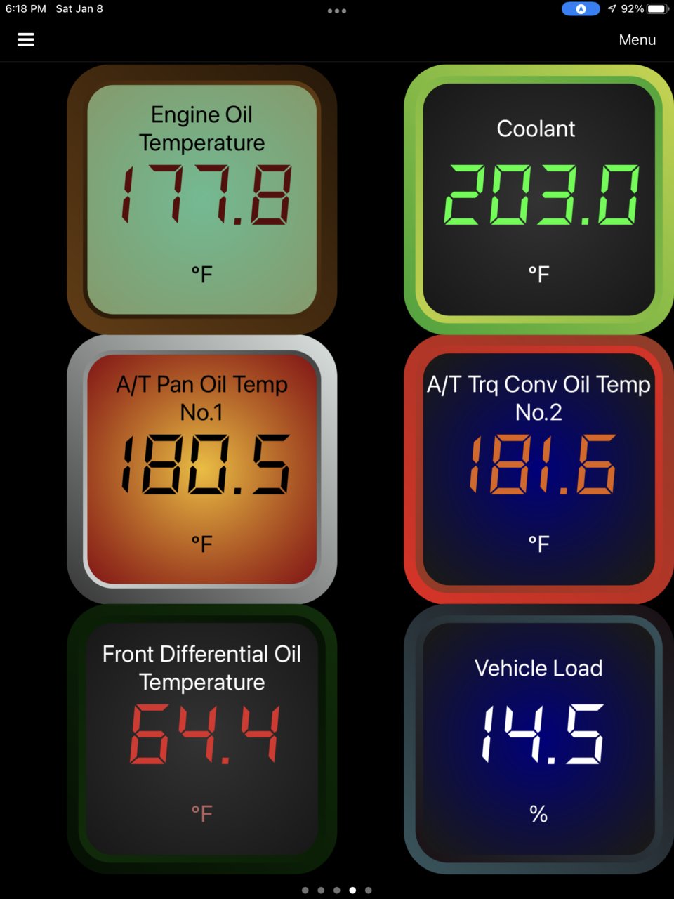

    I have read here that there is no oil temp sender, but those with a Scanguage, or running OBD Fusion as I do, can read it, and the number makes sense (IE it’s not some random gibberish). It has been said here it’s a calculated value based on other factors.
    I watched it on a long drive, and it was it’s own number that trended and changed like you would expect it to (IE it’s not just the same number as the AT temps or coolant temp). This screen shot shows the value in the upper left.
    Does anyone here know how this number is produced/calculated? Why would they need this calculated value?

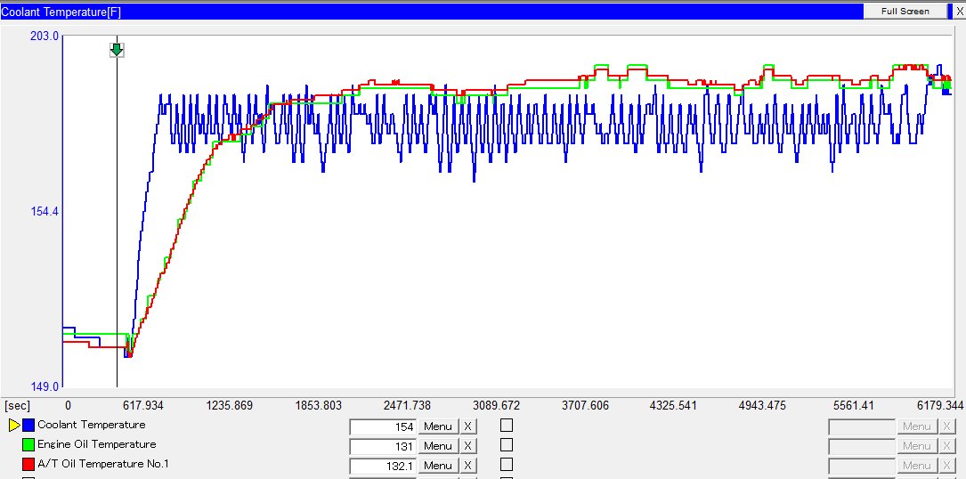

    I put 3 temps over each other . Looks like AT1 and Oil flow close to each other with a similar pattern .
    It seems there is a pattern of the coolant temp to influence the oil temp.
