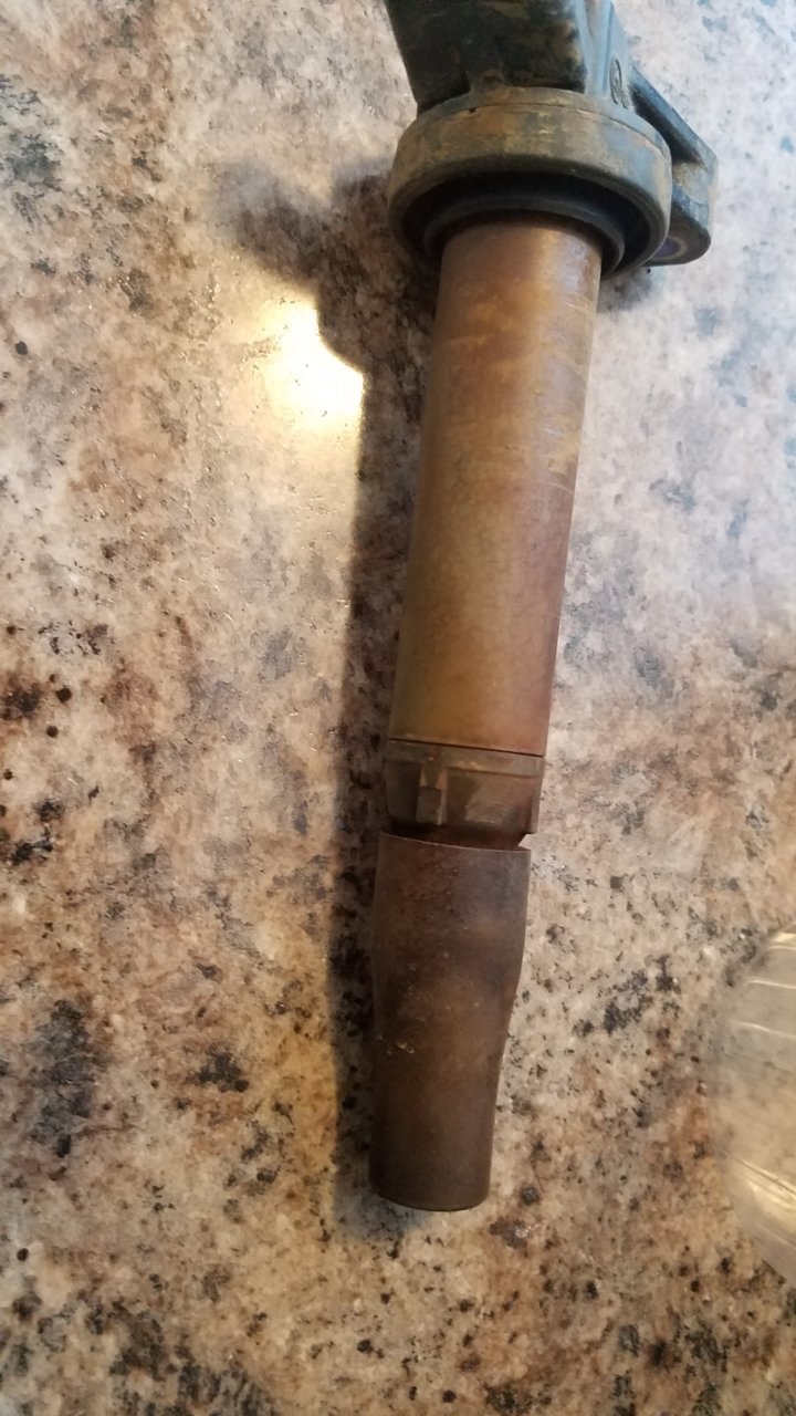

    Changed ignition coil today.. fixed the problem. Runs a lot better. Idle still isn't 100 percent smooth all the time.. but night and day difference

    What was the plug boot looking like and was there any carbon tracking on the plug or cracked ceramic? Some good dielectric grease is a must when installing plugs or coils.
