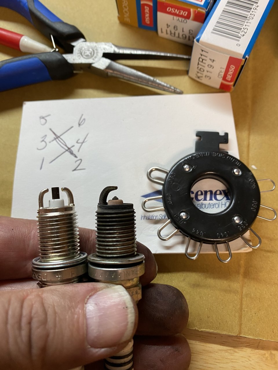

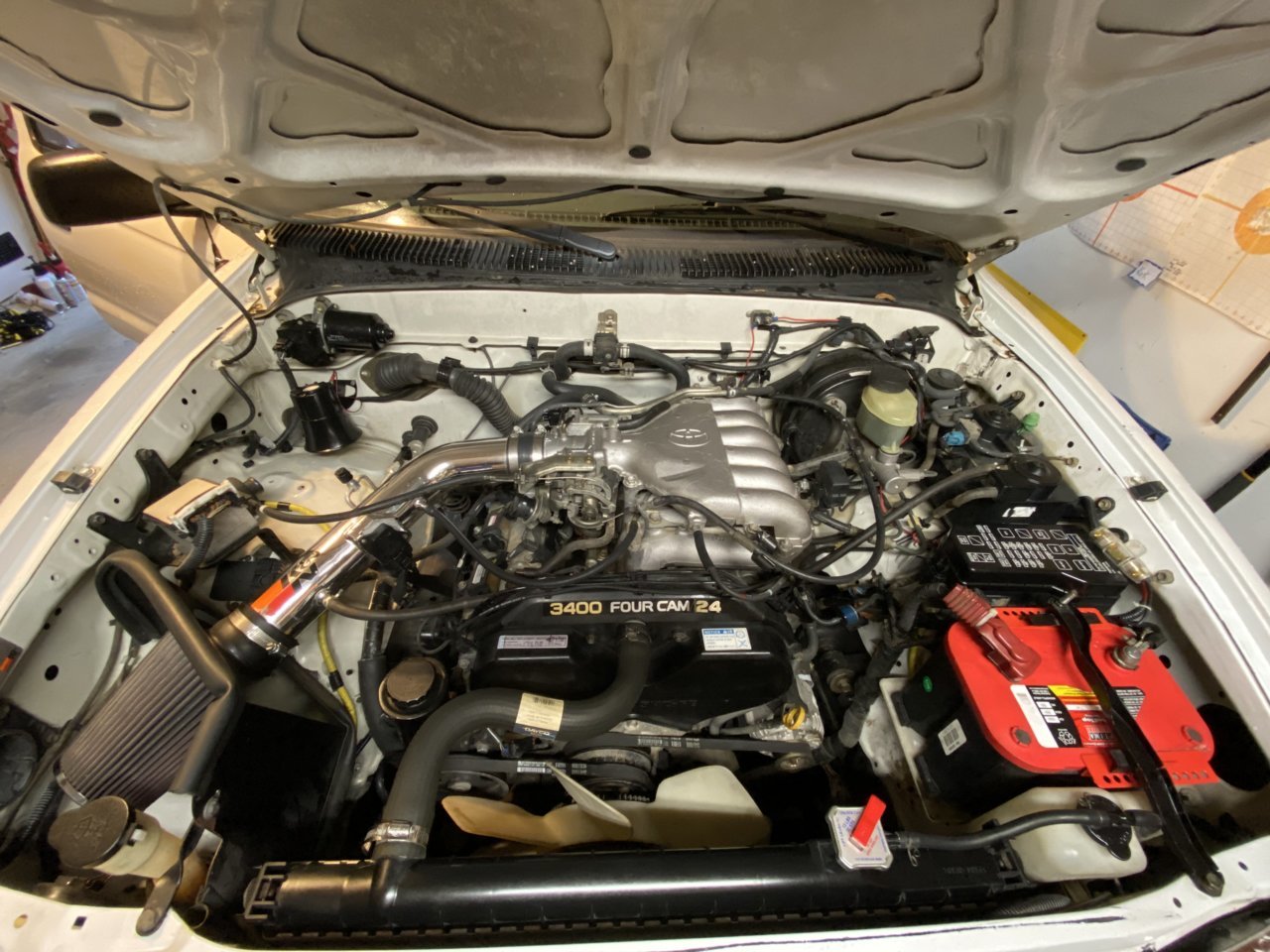

    I just received the new set of OE Denso coils, plug wires and plugs today from Yotashop. They shipped and were delivered in two days. I believe a total OEM refresh should help. I also cleaned out the intake, MAF sensor and filter. Heck, it's new to me so I detailed the engine bay while I was there. Should be a nice project this weekend. I will update when finished. Thanks for the help.

    Wow! Coils, wires and plugs replaced. I haven’t seen plugs so worn in my life. Barely a nub, I’m surprised is wasn’t missing more and throwing codes. Test drove it on the freeway and feels much better. No hesitations! On to the next project.
