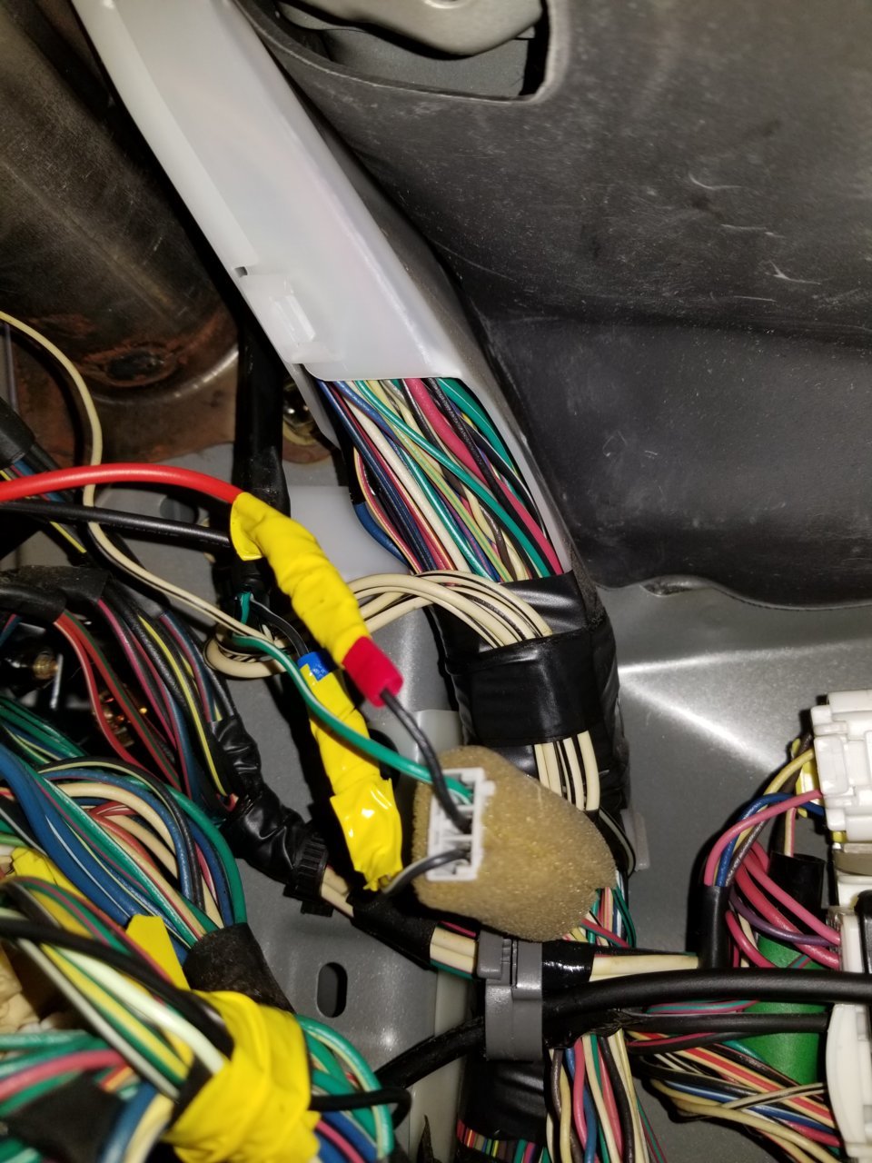

    I found the plug behind my dash. I didn’t have the female end of the plug, so I simply cut it off and tried it both ways (swapped the positive and negatives) but still can’t get the light to come on
    these two wires right here red/blue and green/black. This plug was taped up around some other wires and not used in my truck. Isn’t that the correct plug and wires?

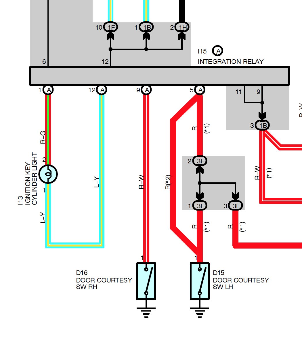

    I'm pretty sure I've posted this before, but here it is again. Also here is a screenshot since most people want to see something rather than download something. Still, download the PDF, it is better quality.
    The light ring plug only has 2 pins. It will have a Light Blue - Yellow wire and a Red - Green wire. Keep in mind Light Blue looks more like dark blue.
    This goes to connector A at the back of the integration module (interior fuse panel) pins 1 and 12 if you want to trace it.
    @4x4Taco09 that is not the correct connector.
    I cannot remember which is positive vs negative on this, but if you use a incandescent bulb it doesn't matter. If it doesn't work with a LED, then you need to switch the wires.

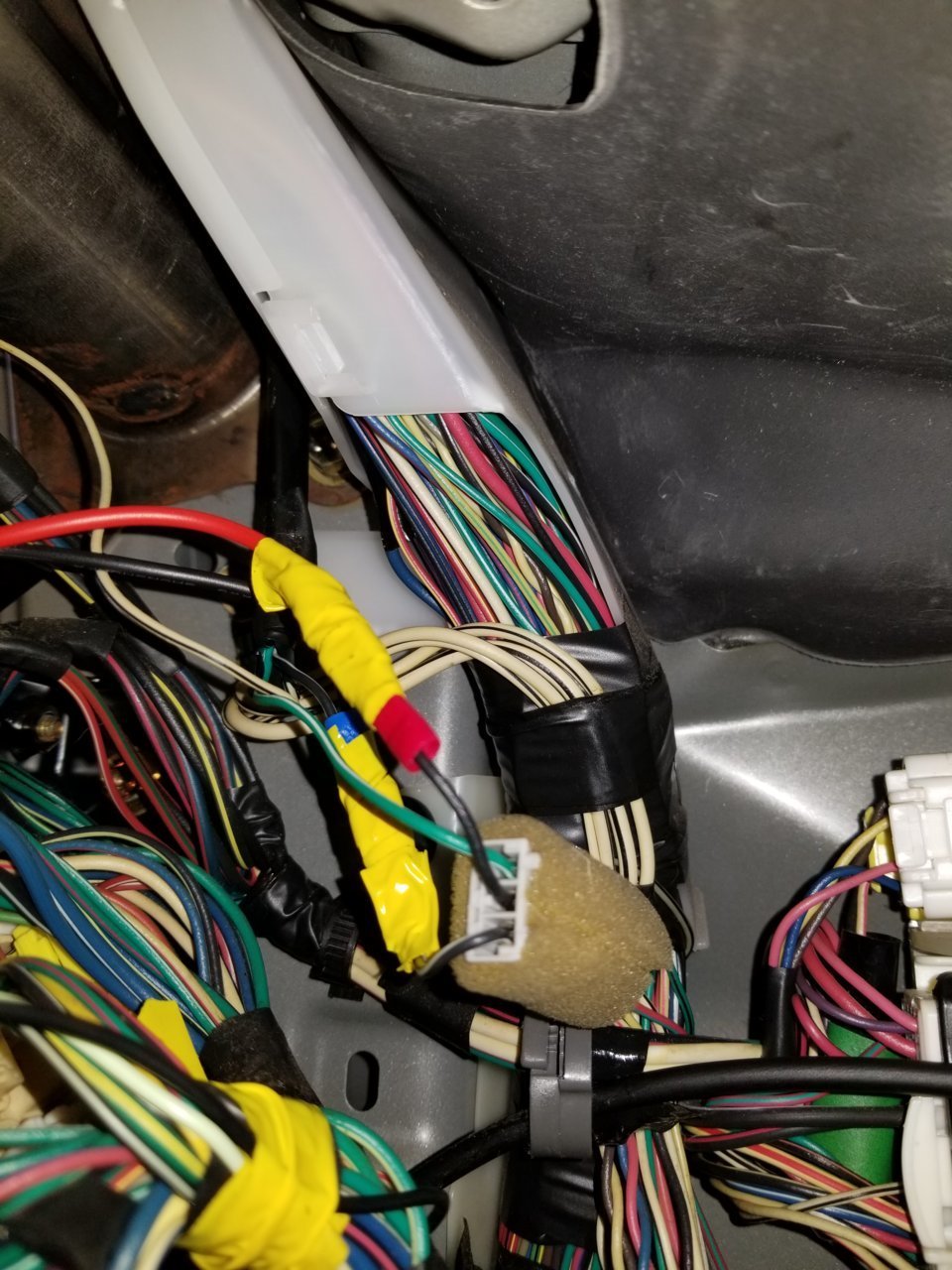

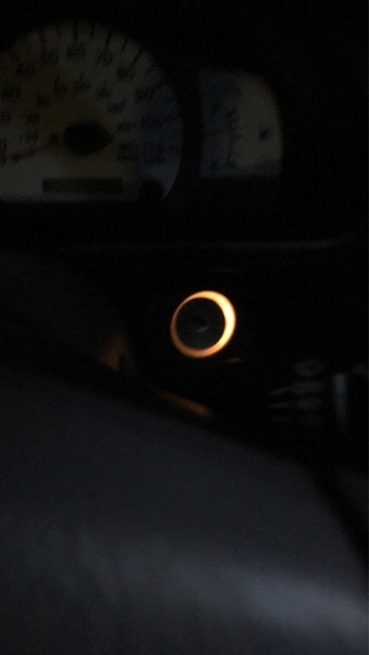

    Ring off my 1996 SR5 4Runner parts truck finally made it into my truck.
    DYWY-Xj9jf8PoTWnhZYbLeY0rtkk0lgYrUmvouL4_3a6fc063b7cbc6f1f9f78ad5dec49a51d85bf8b8.jpg
    Removed the green rubber off my 4Runner bulb. Looking for an amber LED or an amber rubber thing to get the color closer to stock. But it's close enough for now. Tapped into the black/white and black a pillar wires.

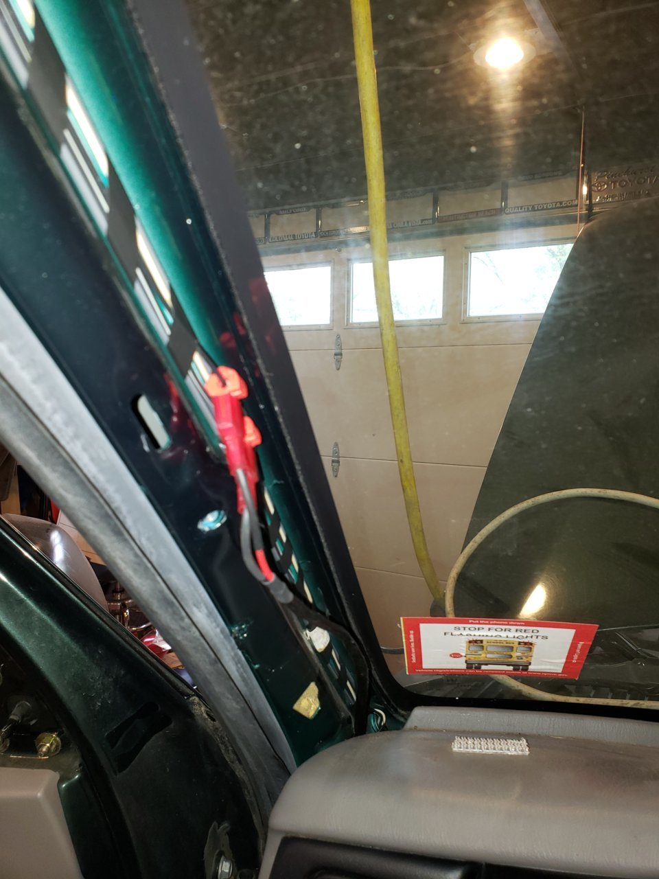

    Not to beat a dead horse, but I wired up and it works. However the light is always lit up. Was hoping it would turn on with running light or courtesy lights. I used the black and black with white in the a pillar.
    **Update**
    Not thinking i had the door open the whole time. Once I used my brain and shut the door, 16 seconds the light went off. Now I have 2 more truck to complete this on. Thank you everyone for all the photos and write ups. Very easy. About 15mins and 45mins wondering why the light wouldn't go off.

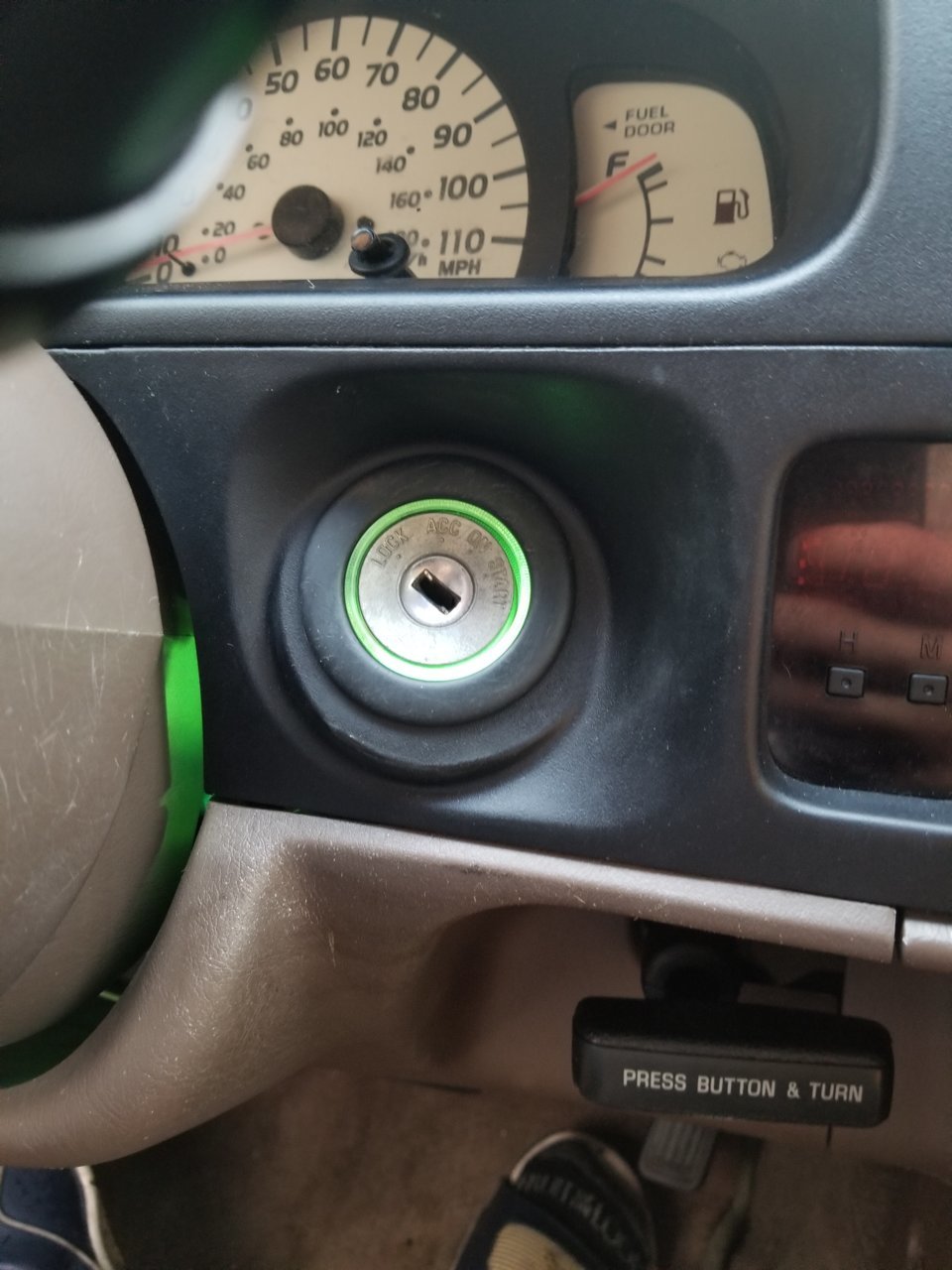

    Well mod was a secuss. I tapped into the wire in the a pillar after making my own harness to look OEM. Very pleased with the outcome. Thanks to the write ups and photos. Just remember the light will on while the door is open. Turns of once door has been closed and 16 seconds passes.
    **this was all done on a 02**

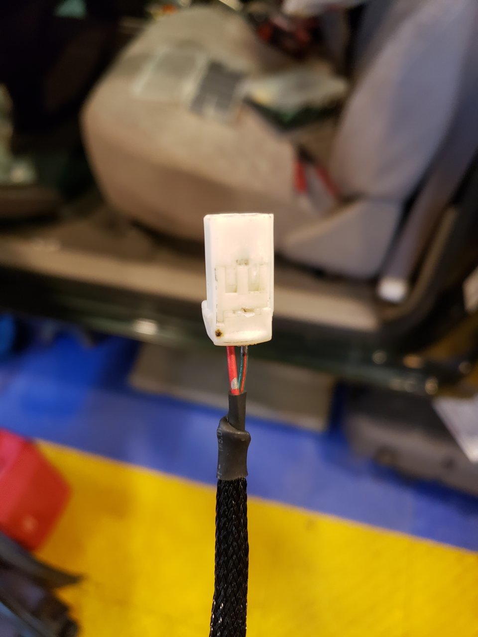

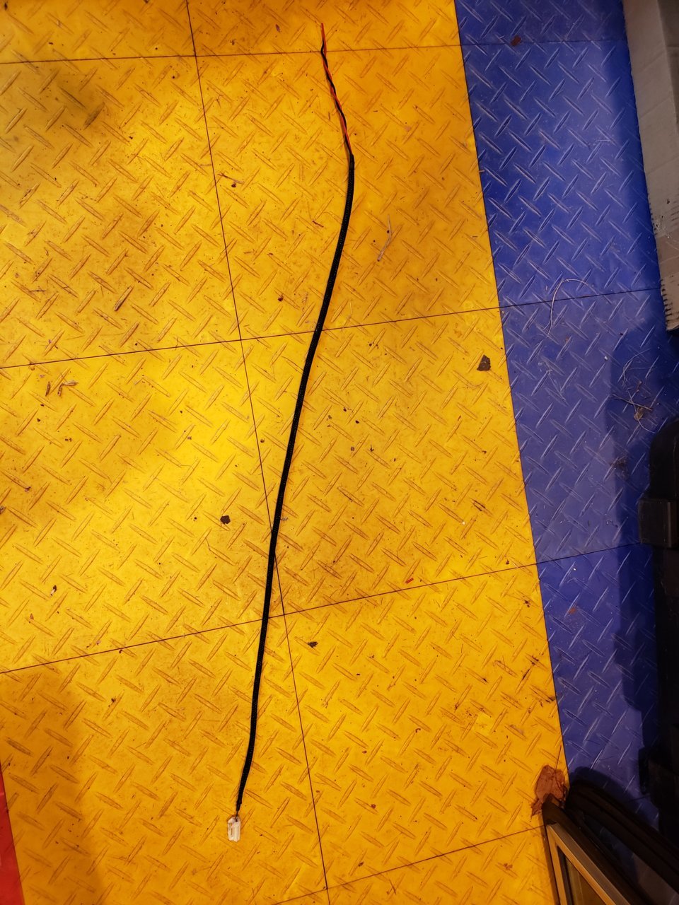

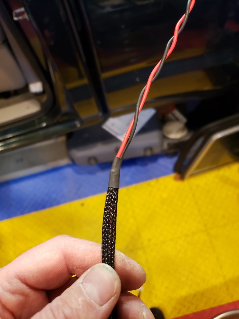

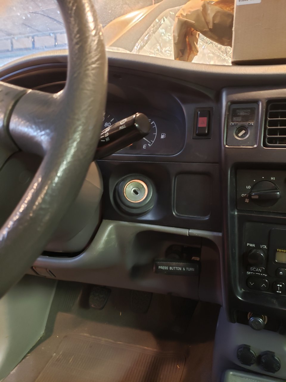

    You guys are gonna hate this.

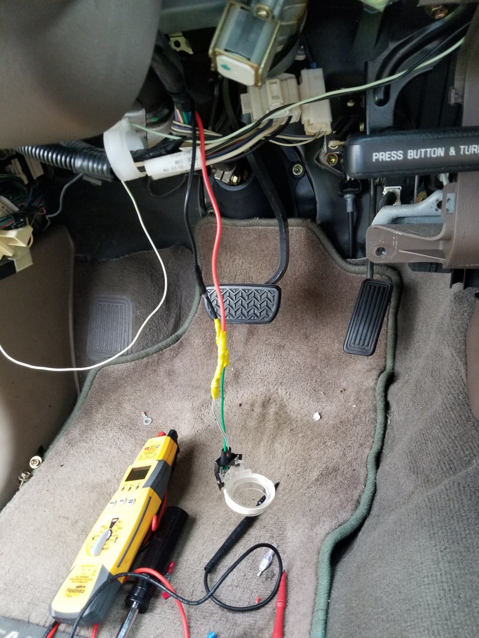

    Just went to wire mine tonight. While looking around for a better way I found out the truck has the factory connector under the steering column!! How the hell did no one figure this out yet?! (edit: never mind just went back through the thread and seen some people discovered it.)
    This mod is 100% plug and play.
    Legit plugged mine in and was done.
    OP, you should put this at the top post to save people the hassle.
    Works just like it should, with the done light.
