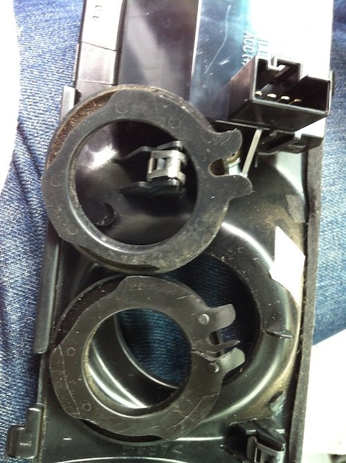

    I haven't found any pic or info that the black ring is or not sent with this bezel.. I hope so

    So if I have the clock with the bezel and regular key ring just not a lit key ring, will I need a different bezel, black ring so it fits altogether with the lit key ring?

    It seems so.. Posts in this thread say that the new ring is bigger so the old ring and probly EXISTING bezel won't work

    Well shoot! I wonder if that means you the clock will be in the way with having to install a bigger bezel?

    No.. clock area is still included in the new bezel too.
    overall, bezel is same size and same mounting

    I really wish the Lil black ring was sold separately..

    Yeah if you have to get the new bezel just to acquire that black ring you might as well use the brand new bezel too!
