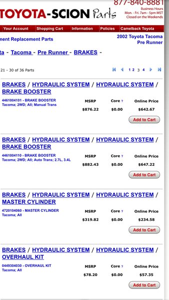

    Good thing you have this here. All of a sudden my brakes went soft. I checked when I got to work and saw brake fluid. Wiped everything down threw down fine dust on everything. I came back to the truck 5 mins later and saw a wet line of brake fluid coming from the bottom of the booster. Not very happy right now knowing it's my own dam fault by adding a little bit to much pressure to the rear with the valve. Well fuck now I'm going to have to replace my booster. Thanks for the write up. I still need to read it tho. All well....
    Edit: read through looks simple enough now the hard part telling my wife I need money for truck parts.
    Mother of fucking shit! $647.22 fuck up

    Wait, the booster never has any brake fluid in it. ever.
    So the MC is what is leaking or one of the lines coming out of it.

    Yeah that's what Tim told me. It was dark when I saw it. It might be between the MC and the booster. Both lines coming out of the MC are dry. I'll check it later now that the sun is up.

    ah if its coming out the back of the MC then you blew a seal.
    That sucks.
    But a lot cheaper then $670 haha
    Id offer you one of mine but they are the 4 bolt flange ones that i have left over. wont fit sadly.

    Thanks for considering it. But no big deal. I have a dealer next to me where I could get a seal from if need one. I'll keep you posted.
