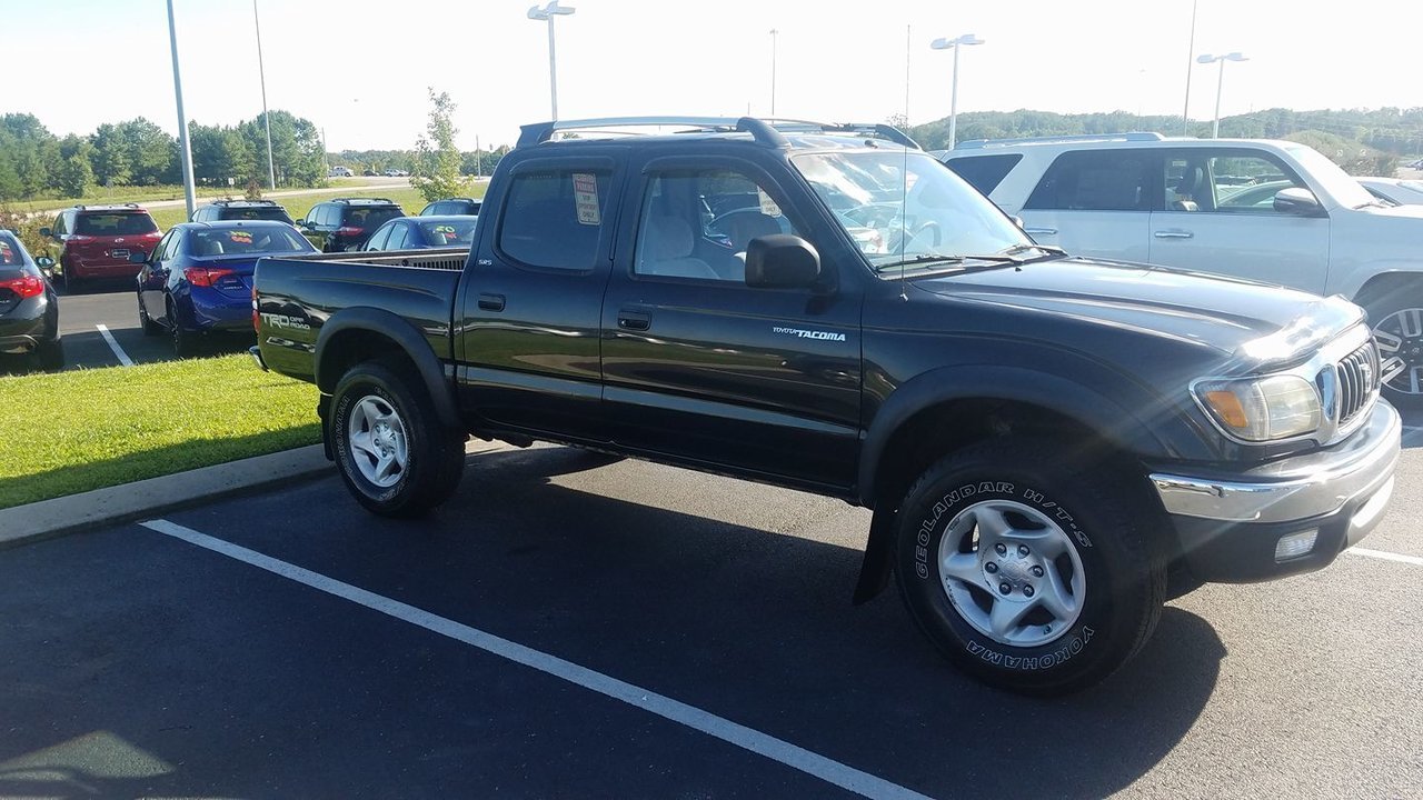

    Igor is totally being an inspiration for my new truck! Subbed!21427468_842169772624535_4479448785505371499_o.jpg

    Nice looking rig! Factory roof rack too!!
