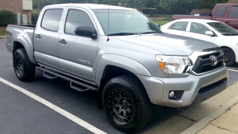

    The transformation of the "Mostly Modest" build:

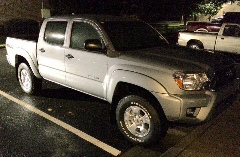

    Purchase Night, September 28, 2015: Didn't make it home from the dealership until well after dark.
    Swapover Day, September 29, 2015: Dealer agreed to swap my wheels and step bars over from the PreRunner and give the truck a quick detail.

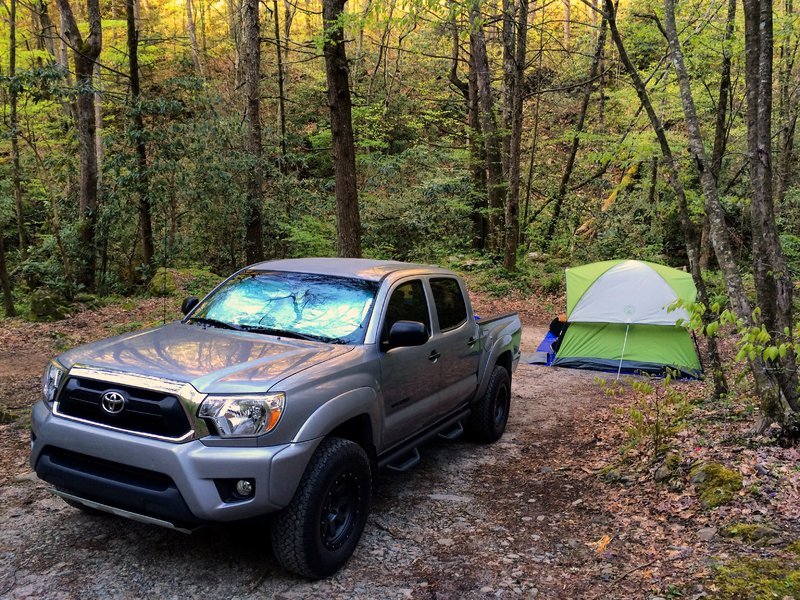

    Camping Trip, April 24, 2016: Only real full shot I have after the badges had been dipped and breather mod done. Not that you can tell much about either from this shot. Still a great camping trip!

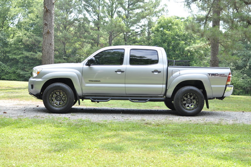

    Bilstein 6112 Install, June 11, 2016: The first real trophy shot after the lift was installed and the springs had settled.

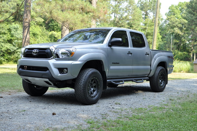

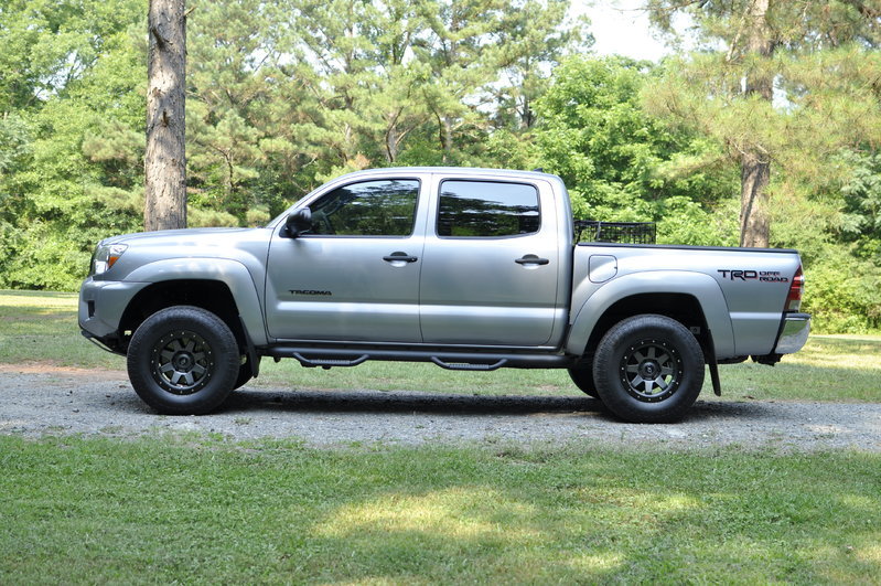

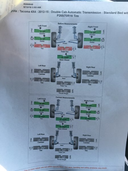

    Bilstein 6112's have been installed! Here's my fresh out of the garage post-installation report copied from the big 6112 thread. I'll provide a more thorough performance review once I get a few miles and a trail or two under my belt.
    ______________________________________________________________________
    Finally, happy to say I can give a post-installation report! (6112's installed at 12,700 on the ODO)
    For the most part, the install went exactly as expected. I followed the numerous videos and tips posted throughout this site and used the "no spring compressor" method and let the tuck and lower control arm do the work for me. I didn't have any issues with disassembly, and didn't have any issues with re-compressing the new coilover with the weight of the vehicle. The total install time was around 5-6 hours, but this was my first time and I went slow and meticulous. On re-assembly every single bolt was re-torqued to spec, then marked so that I can keep track if any bolt tries to back out. Can I also take time to say F^#K that damn swaybar!!! That thing gave me so much trouble trying to re-bolt it to the frame that I almost left the booger off. Also in reference to the cam bolts, 2 of the 4 required slight re-adjustment, but I did re-torque them at full droop, not sitting on the ground. Truck has no issues with pull or incorrect tracking right now.
    So with all of that said, I assembled the 6112's on the #3 (middle) notch hoping for 2" of lift. When everything was said and done, the first time the truck was lowered to tires on the ground I had an insane 4" of lift in the front. One loop through the yard settled it down to 3" of lift. I did a +2 mile loop around the block and it's dropped down to about 2.5" of lift right now, very similar to @HB Taco .
    Stock Measurements: 20" Hub to Fender / 35" Ground to Fender
    Post Measurements: 22.5" Hub to Fender / 37.5" Ground to Fender (#3 setting with 3/8" driver side spacer)
    Rear Measurements: 21.5" Hub to Fender / 36.5" Ground to Fender
    The following photos are right before and immediately after installation. I am nose high, but knew I would be until I take care of the rear suspension. If the suspension settles down into the 1.75" to 2" range as so many other guys have reported, it'll look even better in a couple days.
    BEFORE:
    AFTER: Measured at approx. 2.5" of lift. Expect this to settle within the next few days.
    As for the ride... LOVE it. I've only put about 4 miles on it to give it a test drive, but the ride seems to be as smooth as silk. I'm coming from stock TRD-OR suspension that had 12,000 miles on it. So far my wife nor I don't notice any uncomfortable stiffness, everything is an improvement across the board. Big bumps are MUCH smoother, small bumps are felt a little less in the seat. My only real performance test was hitting a really rough railroad crossing near the house. In every vehicle I've driven, if you crossed it over about 10MPH it'd rattle your teeth out. With the 6112's I was able to cross the tracks at 35MPH and didn't even feel them. Smooth as butter. It surprised the hell out of my wife and I.
    I'll report back in a couple of days when I'm able to hit the apartment complex's speed bumps a few times and see how it really compares to the old suspension. But so far I'm very happy and it is a noticeable improvement over the stock TRD-OR suspension.

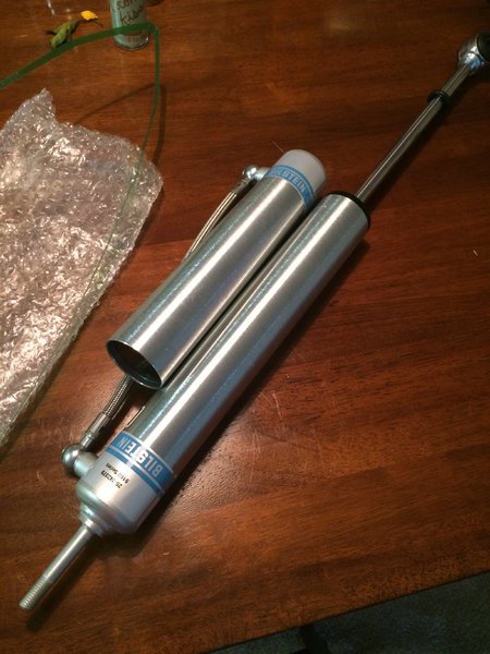

    Got the 5160 in. As with the 6112's they're a lot beefier in person than they look in the pictures.
    If that passenger's side shock doesn't go on sale by this Thursday, I'm going to end up ordering it anyway so that I can get these things installed this weekend. The suspense is killing me just staring at this lone box in the corner.
