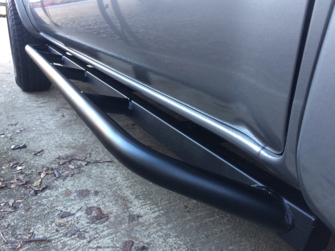

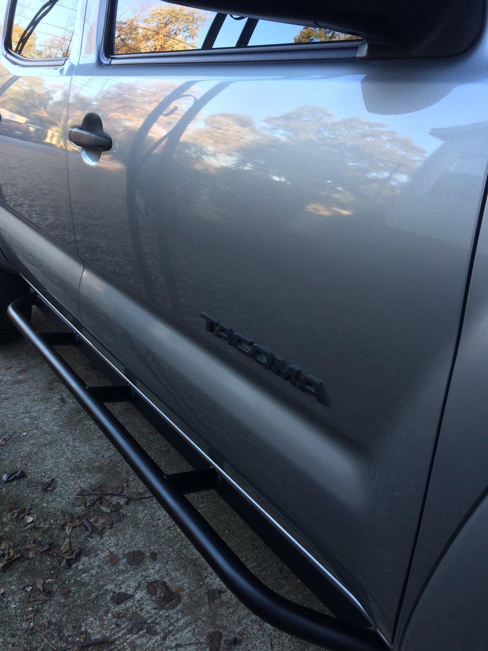

    Snagged a set of SOS Concepts sliders during the 4th anniversary sale back in October. Took about 6 weeks to get them, and another 6 weeks to finally get them installed. Battled the cold and weather, but finally got them primed, painted, and installed.
    After a cleaning with acetone and paint thinner, I coated them with 2 coats of Rustoleum Self Etching primer, 3 coats of Rustoleum Protective Enamel Flat Black, and topped them with 2 coats of Semi-Gloss. Time will tell how tough the finish is, but the final outcome looked really nice.
    Install was about as straightforward as possible. Other than the forward 2 bolts on the driver's side, everything went on quick and lined up perfectly.

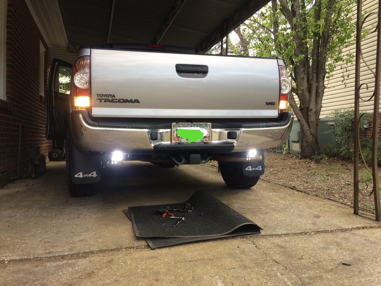

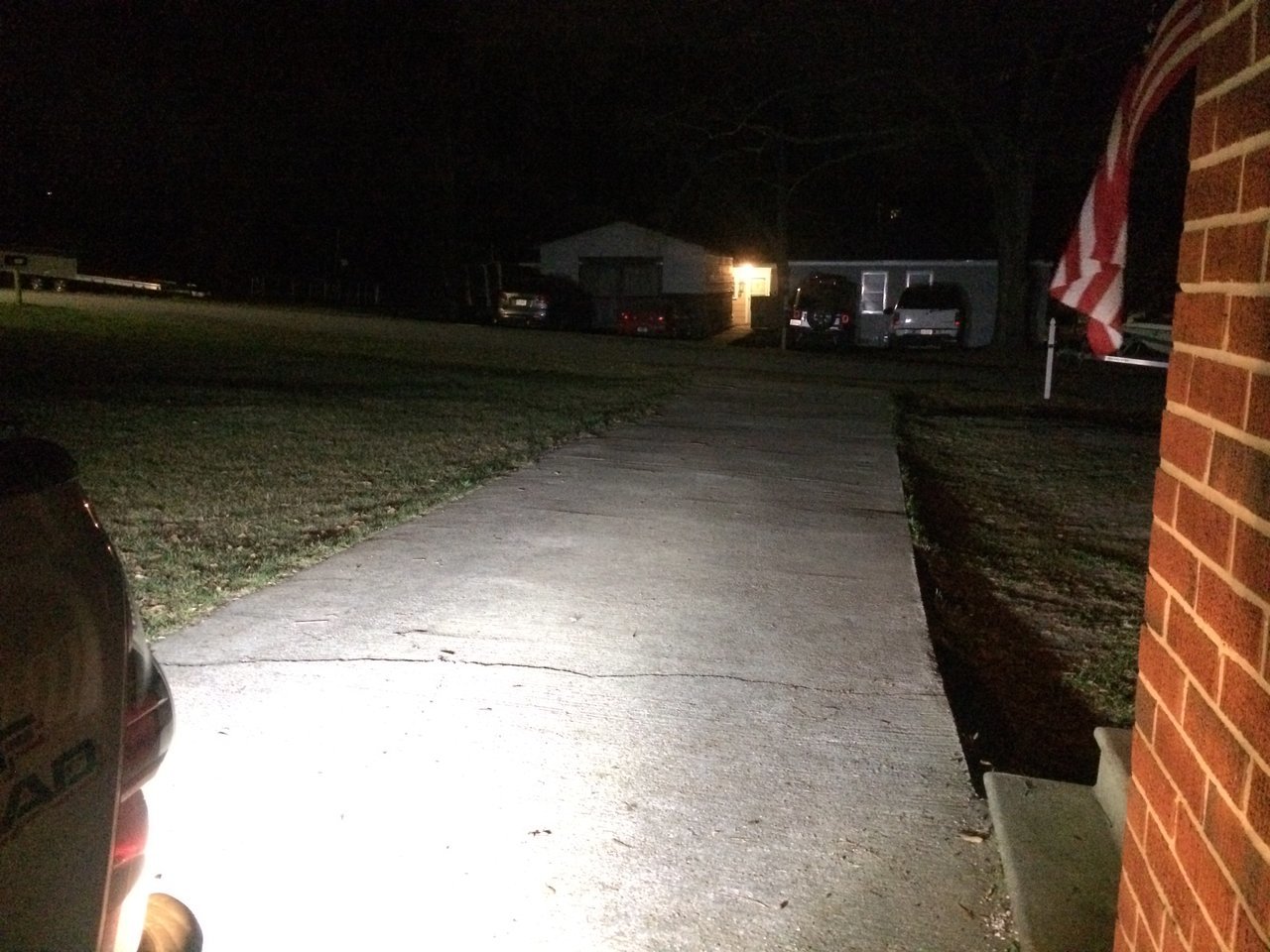

    Finally got the rear LED pods wired up. Pulled power from the trailer harness reverse wire and ground.
    These are just Amazon special 2x3 LED pods but they are crazy bright. I actually had to aim them higher up than expected because the bright light was making the backup camera too washed out. Got them dialed in and love the outcome.

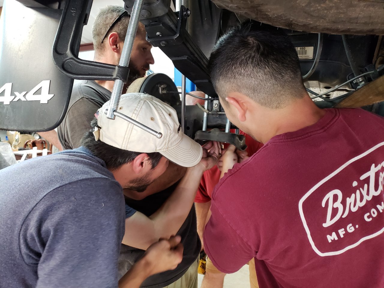

    Post Installation Report: Icon 3-Leaf AAL (Installed with 48,100 on the ODO)
    So the 3-Leaf AAL has been a long time coming. About 6 months ago I started noticing that my factory 3+1 leaf pack was making the rear of the truck look a little sad. On level ground there was a noticeable 1/2" or so of negative rake (bro lean). With the help of quite a few TW friends, we removed the overload and installed the leaf pack at the end of August.
    Disappointingly, my post-lift measurements weren't quite what I was hoping for. I rode around on the kit for about a week to see what would happen, but the rear end sat firmly planted at 22" hub to fender... only 1/2" higher than where it was stock. Icon was gracious enough to admit the ride height could be an issue with the AAL pack, and sent me a replacement AAL. GREAT customer service. Swapped the AAL pack out over the weekend.
    Unfortunately, the replacement pack from Icon didn't really help me gain anything so I'm at 22.5" at the rear hub to fender. I'm still not at the 23" - 23.5" I was hoping to be at. Long story short: my 2015 stock leaf pack is already a problem at only 45k miles.
    Now I'm debating on whether or not to rip everything out and replace the entire leaf pack with a Dakar Medium, or give the configuration one more convincing push by re-installing the factory overload.
    The end goal of all of this is to eventually be able to support the weight of a RTT and bed rack in the near future. I'm having a lot of doubts right now.
    With all of that being said, my impression on the 3-Leaf Icon pack is that it rides great. The rear suspension is a lot less bouncy, more plush over big jolts, and even with the overload gone I manage to hit the bump stops less. It is a very noticeable improvement over the stock leaf pack configuration.
    Now I get to debate on what to do from here.
