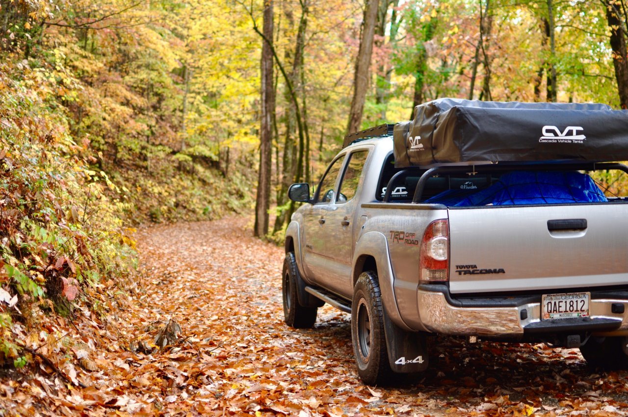

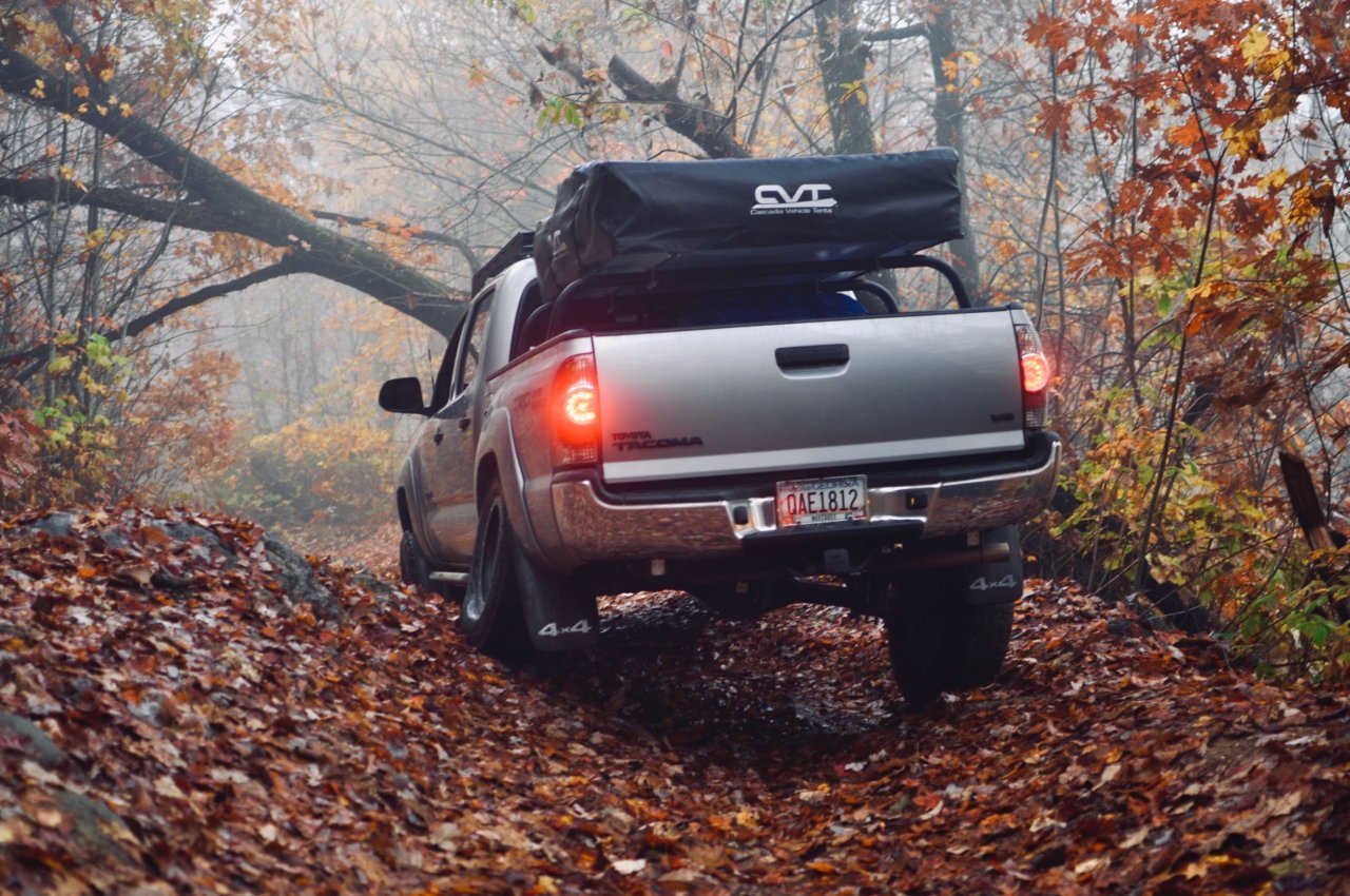

    Annnndddddd RTT is on. CVT Mount Shasta Pioneer Standard, Earth Tone Green.
    Got SUPER lucky and managed to snag this one during their "End of Summer 2018" sale. The wife and I made a trip up to Chattanooga, TN to pick the tent up in person. I cannot say enough good things about @Cascadia Tents and their staff. The owner, Bobby, was super helpful over the phone and their branch manager, Tim, was awesome during purchase.
    The tent is supported by 2x AllPro bed bars. Prior to install they were cleaned, primed with self-etching primer, and painted with truck bedliner spray paint. I also added 5/16" lock washers to each attachment point on the bed rails to compliment the setup. These things are rock solid, and fit perfectly.
    So with this we're all geared up for next weekend's trip.

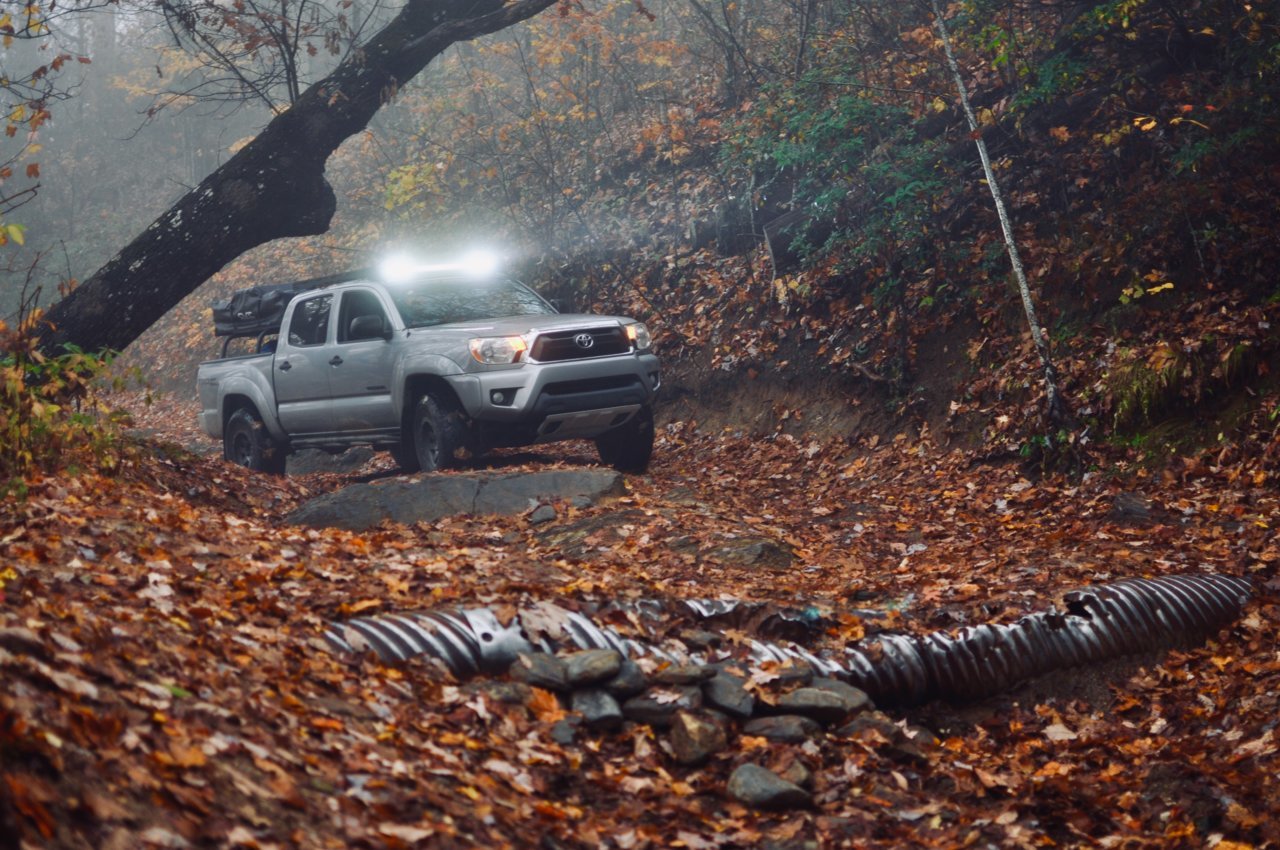

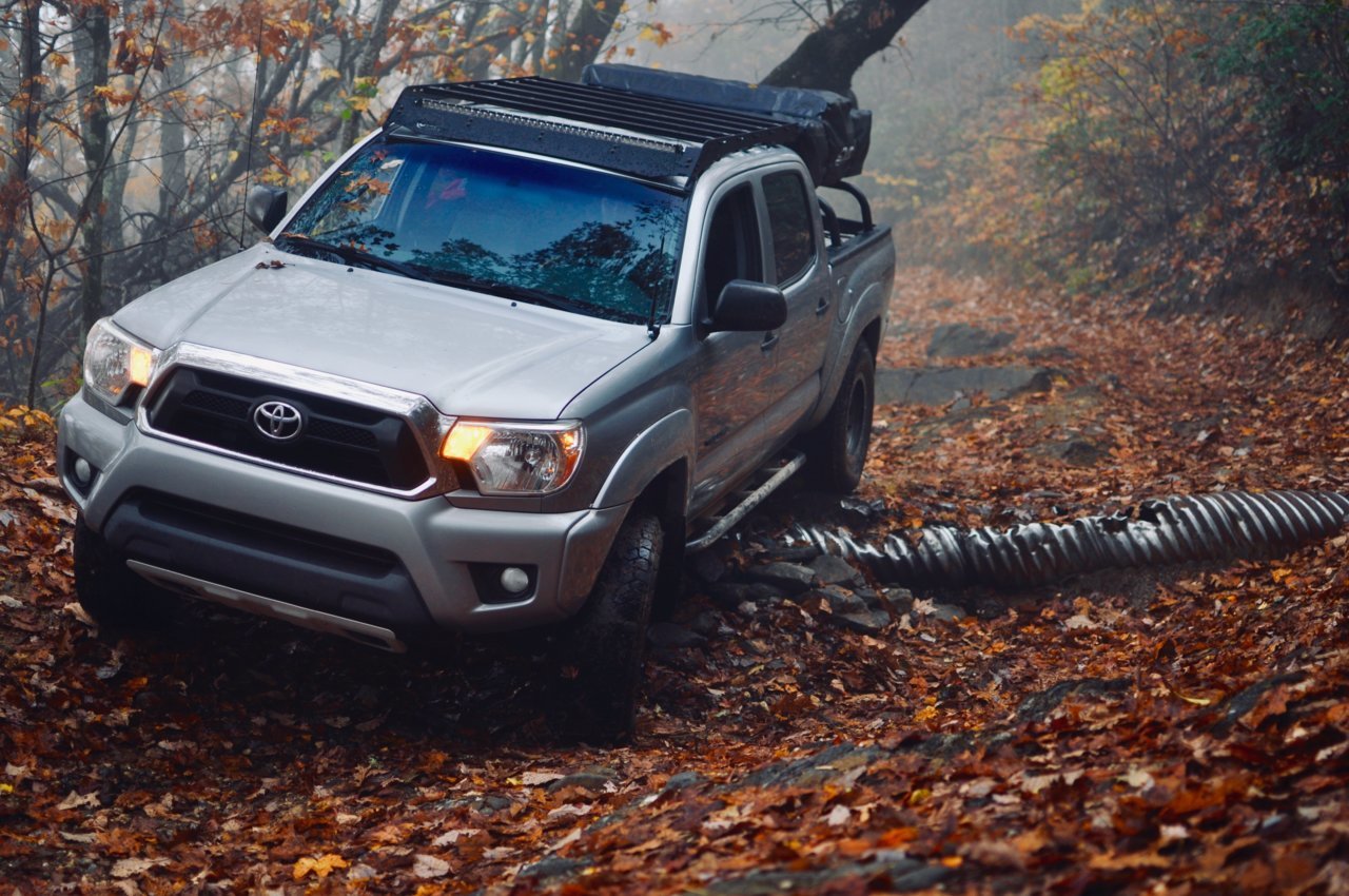

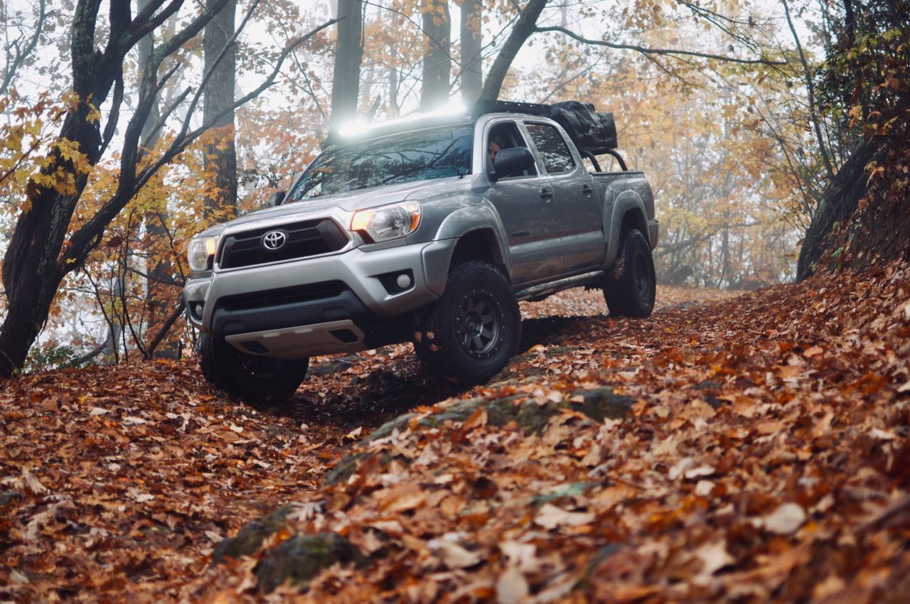

    Trip Report: Tray Mountain & NE Georgia 11/9/2018
    Planned route: https://drive.google.com/open?id=1JuhTuxHflXIj8LjtftfMy9kljEdYHGk2
    The original intent of the trip was to take the new CVT RTT out for its maiden voyage and to do a portion of the northeast leg of the Georgia Traverse. Unfortunately rain pushed the start date back by a full day, so we ended up hitting the road early Friday 11/9 to start the rainy trip towards Helen. Once we made it to Helen, the first stop was the Tray Mountain trail head. We'd attempted Tray on 2 previous occasions, but due to time constraints and road closures, we were unable to do the entire trail.
    Despite the rain, we were fortunately met with some amazing fall colors at the start of the trail.
    The first section of Tray, which is the ascent from highway 75 north of Helen, was very easy. 2WD and good music got us to the top of the mountain. About 1/4 of the way in, we were high enough that we hit fog, which continued for the remainder of the trip.

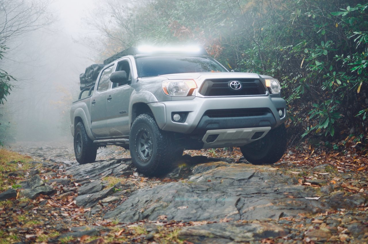

    Once you make the split at the top of Tray and begin the descent towards Chimney Mountain Rd, the trail gets very rocky. Nothing overly technical, but you definitely need to pay attention. This starts slowing progress down to a crawl.
    About 1/4 of the way down you start to run into the real obstacles Tray Mountain is known for. The first of the off camber sections pop up and picking good lines becomes critical. As always, photos don't do the trail justice, but having suspension stuffed on opposite corners was a regular thing and 4WD was a requirement.

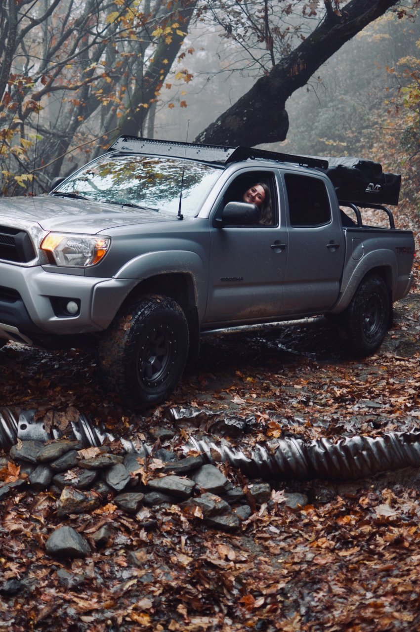

    Then you come to what's one of the worst obstacles on the trail. An exposed metal pipe that's rutted away the trial. It's difficult to show how severe this section is, but for reference that exposed pipe is approximately 15" so the dropoff in the right side of these photos is about 2' or more straight down. Luckily previous trail riders had stacked rocks on the shallowest side of the pipe which made the crossing more tolerable. For this section, I had my wife at the wheel while I spotted for her. We were able to navigate the section in one pass, but the drop off over the pipe was still very tricky.
    Past the exposed pipe, there's a few more off-camber sections, also very rutted. Here we are at full stuff, almost stuck. Had to use the rear locker here. I was very impressed with the articulation that the factory springs & Icon 3 leaf AAL offered.
    The remaining descent from Tray is less technical. There's more rocky areas, a few mudholes, and a huge washout. 4Lo was our best friend until we made it to Chimney Mountain, but needless to say Tray Mountain was an absolute blast. We met a group of awesome overlanders from Miami who were doing the Georgia Traverse. Awesome group of guys who had some amazing rigs.
    https://www.instagram.com/p/BqAZ5tzHhTo/?utm_source=ig_web_button_share_sheet

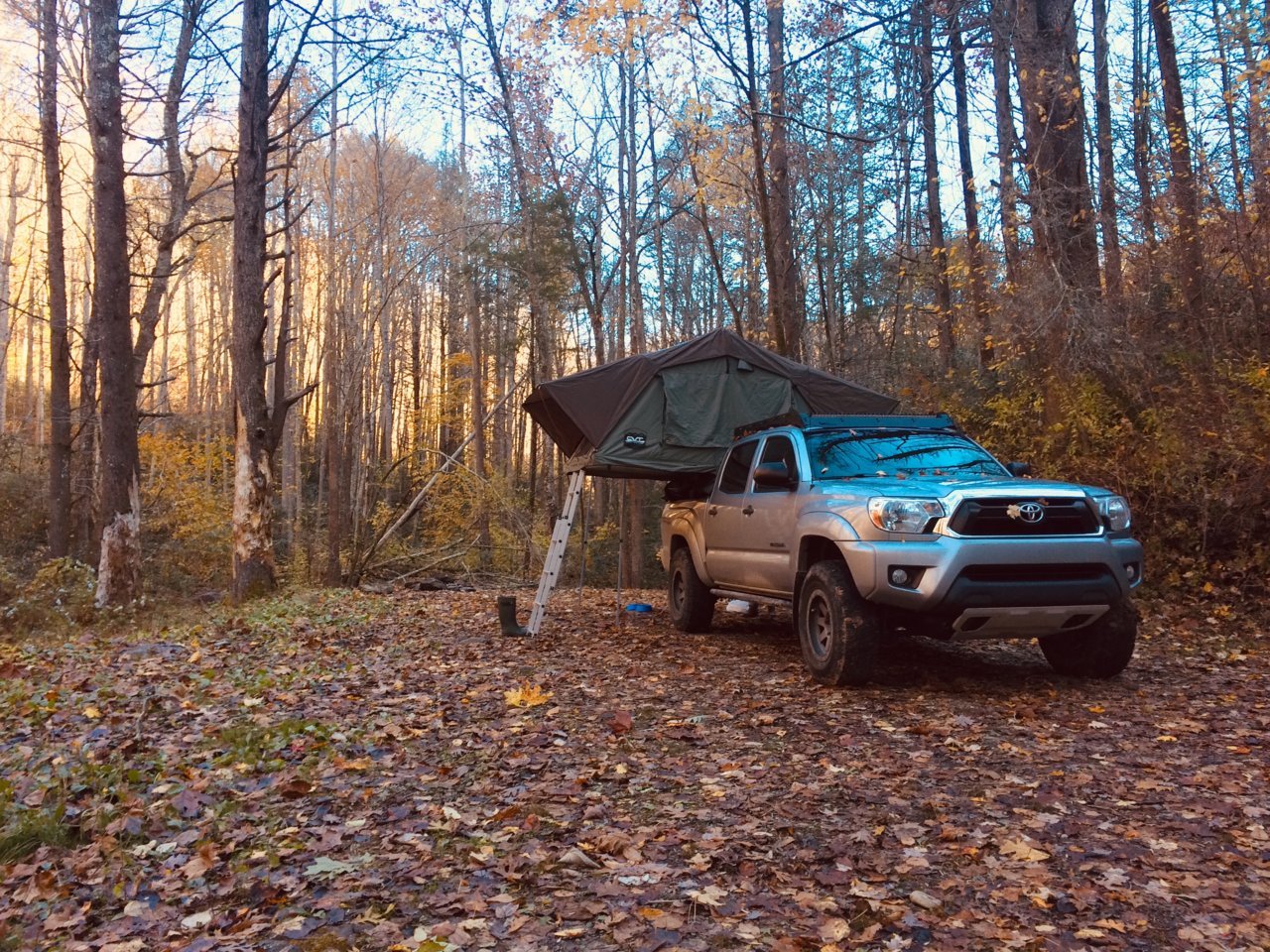

    After dodging rain, we ended up setting up camp in the dark and turned in for the night.
