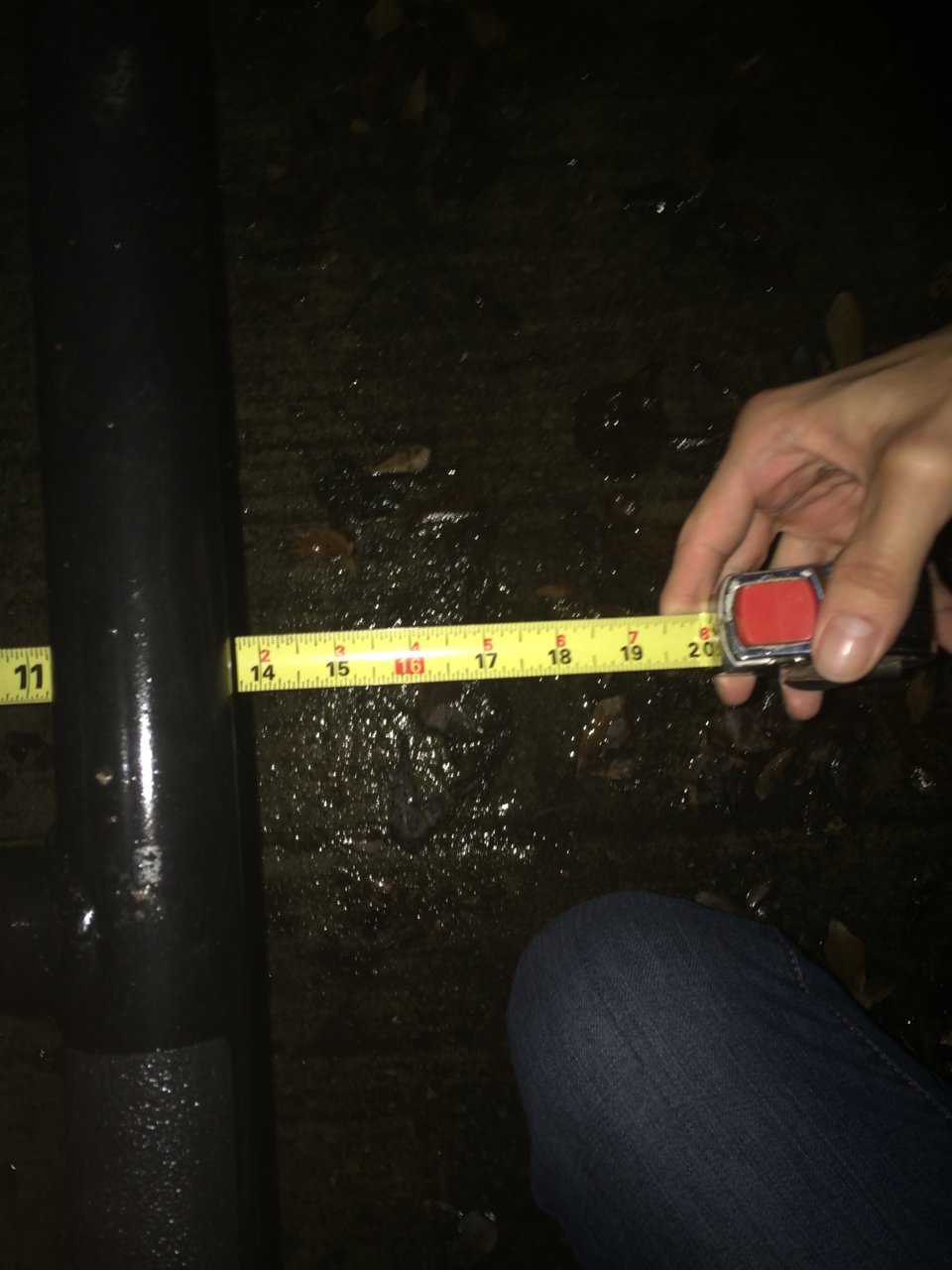

    Would you mind measuring how far those non kickout sliders stick off your frame at the drivers door? I’m working with Eddy on a custom set for my truck. I’m undecided at the moment on kickout or no kickout.

    And yeah, not a problem. So you want from the frame to the outside edge of the slider, right?

    Here ya go!

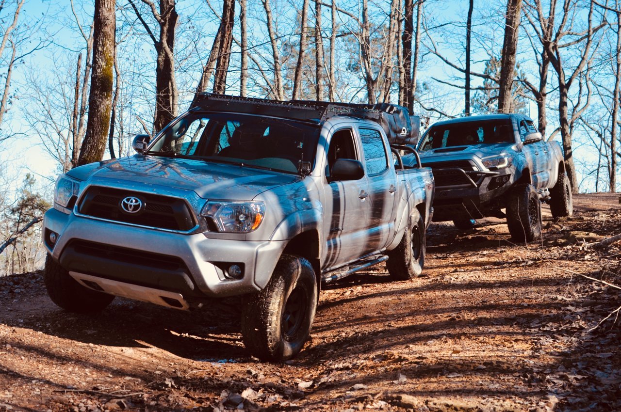

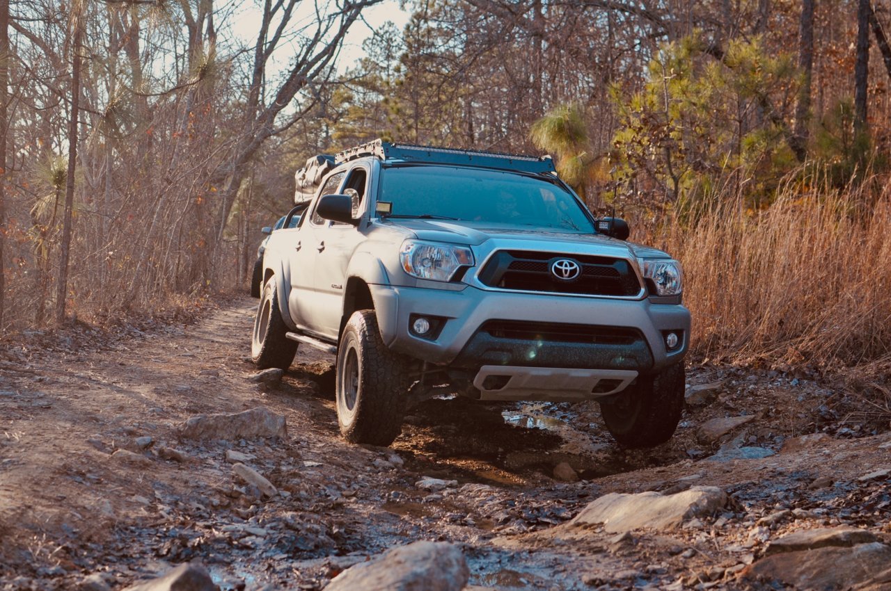

    Trip Report: Talladega National Forest (Alabama) 12/22/2018
    Planned route: https://goo.gl/maps/J2Gx1oU9BZK2
    I think it's best to preface this trail report with a shout out to SwellRunner, who sparked my interest in a trip to the Talladega National Forest. After watching his two series on his Talladega Forest trips, I reached out to him and was able to get a .gpx file of his trail ride. Once I had that, the gears started turning and a couple months later we had the trip planned.
    Saturday morning, my wife and I teamed up with @taco_bach & his fiance for the journey. We met in Columbus & started out towards Talladega. Halfway there we stopped in Alexander City, AL for fuel & lunch. After getting back on the road, we arrived at the Talladega FSR600-1 trail head at the southernmost section of the forest around 1PM.
    Hitting the dirt, we were surprised at the mildness of the trail. Truth be told we weren't sure what to expect, we just knew that at some point along our route we would hit some fairly difficult terrain. There were a few very small washes, but overall the first half of 600-1 is very mild. After a few miles we decided to make our first stop and enjoy the outdoors with friends and pups.
    Once again on the move after our short break, we'd gained quite a bit of elevation and the views through the trees were beginning to open up. We were finally hitting something more than washboards on the trail. Again, we weren't sure all of what to expect, so we took our time and snapped pictures every chance we had for the first couple of hours worth of riding.
    Continuing on, we were awarded with some really breathtaking views. The 600-1 trail is high atop the Cheaha Mountain ridge and offers some gorgeous scenery for miles away.
    The remainder of 600-1 was also smooth sailing. As we started a mild descent, the pace picked up and we were able to cruise 20+mph along the service roads headed to 600-2. After crossing AL209, a couple bridges, and a train track, we were finally at the 600-2 trail head.
    Less than a mile in on 600-2, progress had slowed to a crawl. We were encountering mud, switchbacks, limbs across the road, but nothing that would be challenging enough to stop us. A trail report from @BamaTaco56 mentioned that 600-2 had recently been graded, and that proved to be accurate for the most part. There were no longer 3' deep ruts and exposed pipes across the road, but weeks of rain had already started taken a toll on the trail.
    Finally, after around 4 miles, we were getting to the good stuff. The trail got steeper, rocky, and rutted. With the sun tipping over towards 3PM, we were crawling through off-camber sections with slow progress.
    With our wives behind the wheel, Michael and I guided & photographed this really fun stretch of 600-2. The highly eroded trail had numerous exposed rocks that required careful, slow navigation to keep the frame and diffs off of rocks. His 3rd Gen PreRunner was a spectacle to witness, showing that 33" MT's and good lines almost completely negates the need for 4WD on these off-camber trails. Despite some doubts, we were consistently amazed at how well the 2WD handled the terrain with literally no issues that a little skinny pedal motivation couldn't fix. Once through this section, 600-2 calmed down and leveled out with muddy sections being the only thing slowing us down.
    As the time eased towards 430 and the sun already starting to set behind the highest hilltops we made a judgement call to stop at the first campsite we came across, as opposed to continuing into the night to our pre-planned site. Luckily, about 30 minutes before dark, we found an awesome (but wet) site under the power line to set up camp for the night. A few hotdogs, drinks, and campfire stories later, we were out for the night.
    Surviving the brisk ~38* night, I was the first out of the tent with our pup, Lily, to check out the camp and plan for the day ahead. The CVT Mount Shasta proved once again to be invaluable for the cold weather camping. My wife, Lily, and I stayed warm and toasty inside the tent. Michael & his fiance had some difficulties with their ground sleeper and swore off ground camping for the rest of their lives (we'll be welcoming them to the RTT club soon!).
    After breaking camp and a quick breakfast, we decided to make attempts to complete the planned loop & try to make it to DeSoto caverns later in the day.
    With morale mostly high, we finished 600-2, 637, 637C without issue on smooth gravel, dodging hunters and waving at fellow Toyotas. Unfortunately the progress stopped somewhere around 4 miles from us completing the Talladega loop. The mud was getting deeper and thicker from the 2 days of previous rain. Unsure of what else was in store and not wanting to risk getting stuck in the middle of no where in thick mud, we decided to double back & take Gunters Rd. to the 600-2 trail. We finished out the day on 600-2 running the reverse route south on the descent.
    After another hour of rough terrain, we finished the reverse 600-2 and stopped for a break. DeSoto wouldn't be open for another couple of hours, and wasn't pet friendly. We decided to call the trip after a huge success and instead make our way back home ahead of schedule.
    After 5 hours and 70 miles worth of trails, we'd had a blast and couldn't have had a better time. The Talladega Forest was an awesome experience that we were all able to learn from. I suspect that as the rainy winter continues, the trails will only get funner and more challenging with time. We'll definitely be back.

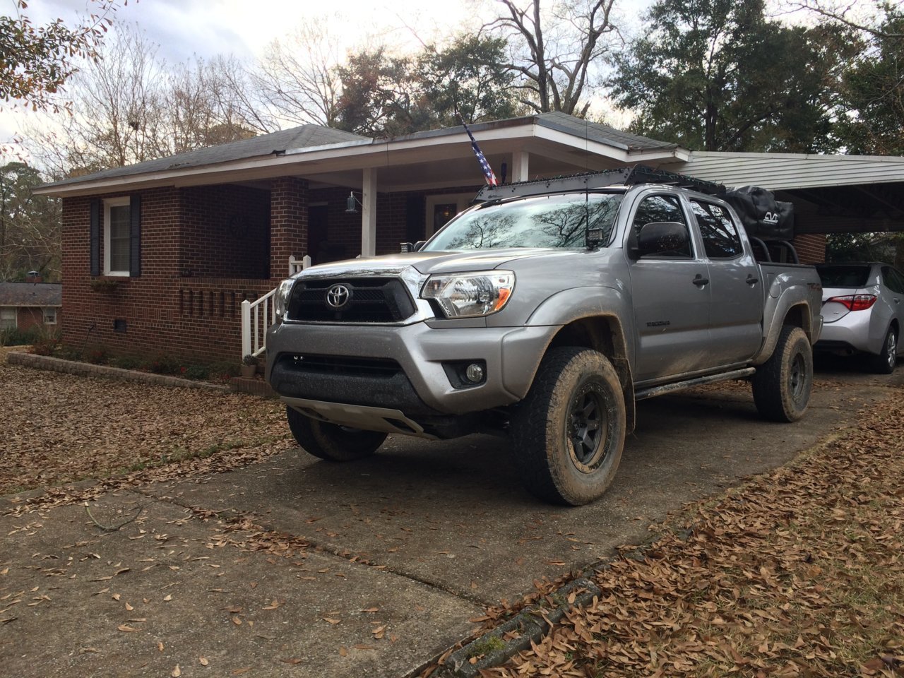

    What were the rear measurements before you put on the AAL? Have you sagged much since putting the RTT on there?
  18. Mar 11, 2019 at 11:56 AM
    #98
    iK0NiK
    iK0NiK [OP] Insert custom title here.
    Jul 31, 2015
    #160743
    1,739
    West
    Columbus, GA
    2015 DCSB V6 TRDOR 4WD
    Bil 6112/5160's etc.
    Unfortunately I forgot to take rear measurements before we put the AAL on, but it was something around 21" - 21.5".
    The 3-leaf kit doesn't help with the weight hardly at all. When I'm loaded down with camping gear and have the RTT on, I'm nose high again. The factory springs just don't like weight, and an AAL doesn't really help that problem.
    I remove the RTT when not in use, so I haven't upgraded, but if you plan to leave your bed rack and RTT on full time, skip the AAL and go straight to a leaf pack. Save yourself the headache.

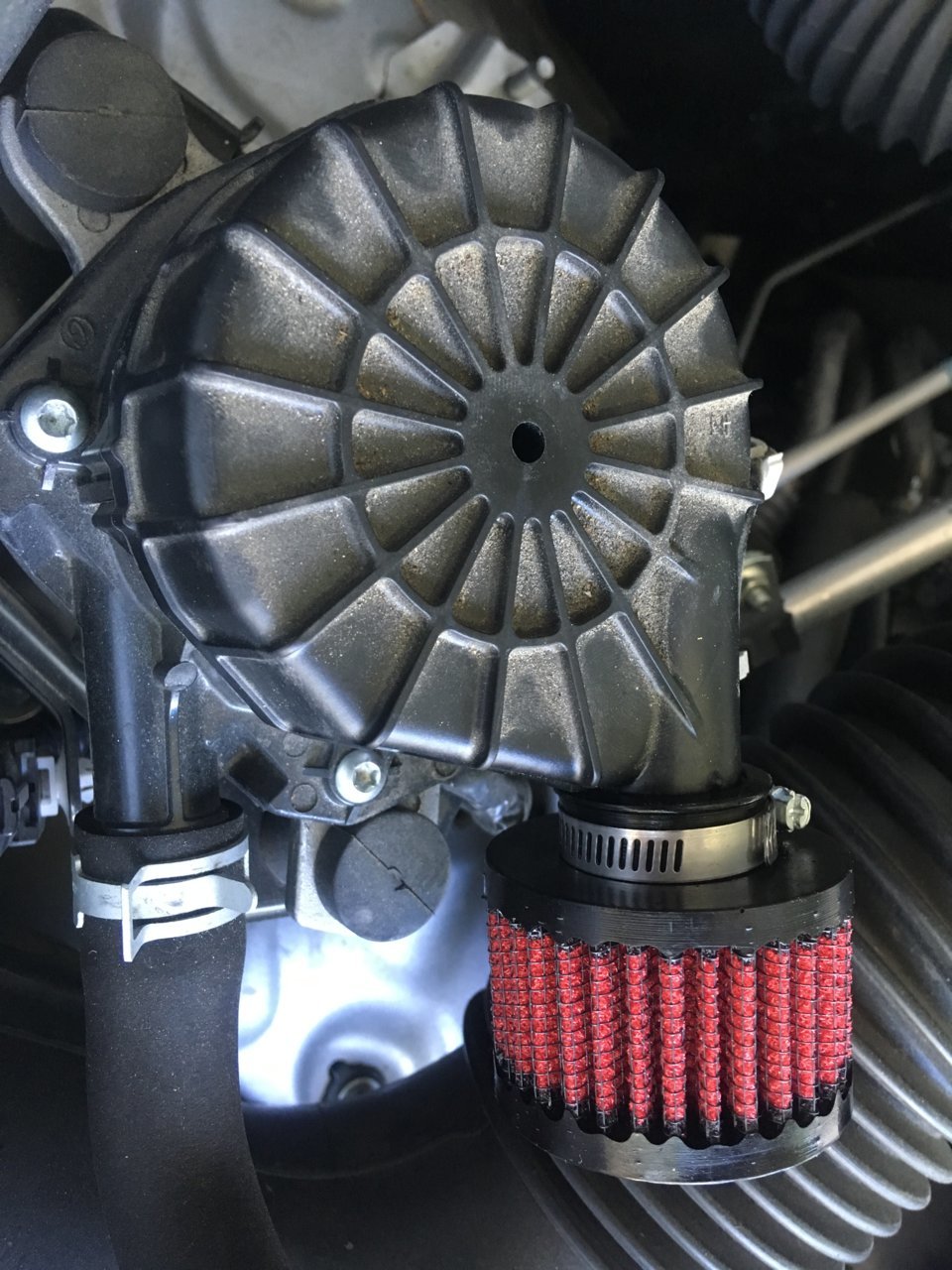

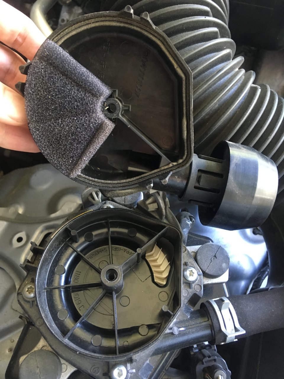

    Secondary Air Injection Filter mod complete. (~56,253 on the ODO)
    SUPER simple, 5 minute mod. Requires a T25 Torx head bit & a 1" UNI (UP-107) air filter.
    Pop the cover off of the pump (it just snaps off) then remove the SINGLE T25 Torx head screw from the top of the pump. Pop the top off and you've found the culprit to everyone's failure problems.
    Remove the foam filter & plastic pre-filter (also just snaps off). Install and tighten the Uni filter. Re-install everything, tighten the Torx screw back down.
    Pop the plastic cover back on and it's done.
    UNI filter used: https://www.amazon.com/gp/product/B003CJOTSA/ref=ppx_yo_dt_b_asin_title_o00_s00?ie=UTF8&psc=1
