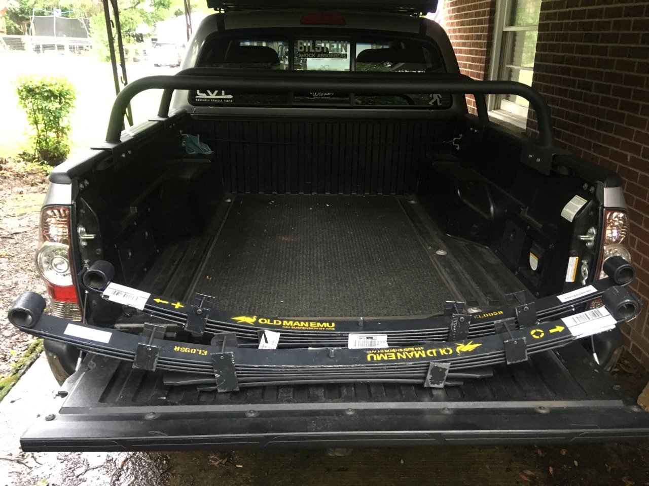

    OME Dakar EL095R Medium-Duty Leaf Pack Install, 6/15/19 (56,380mi ODO)
    So after much back-and-forth and continuous research, I decided to finally take the plunge with a full new leaf pack upgrade. As mentioned previously in my build thread I've been fairly disappointed with the weight carrying ability of the stock leaf pack combined with the 3-Leaf AAL kit from Icon. The system rode great, and soaked up rough terrain like it was pillows, but I lost a lot of height (nearly 2") when fully loaded with the RTT and camping gear. Not a big deal when you've got some rake, but I was already sitting leveled empty, and was nose high any time I was loaded down. That meant less suspension travel when offroading, and a very top heavy feeling when riding loaded.
    Queue the OME Dakar Medium-Duty leaf pack. I purchased from @HeadStrong Off-Road and was treated with excellent customer service. The pack arrived in record time on Monday and by Saturday I was turning wrenches. I lucked up and received (+) Spec & (0) Spec packs.
    Overall the install went surprisingly well. I followed this video, which outlined the installation process perfectly: YOUTUBE
    With the help of my dad, we started on the Driver's side. Unbolting everything was the longest part of the process. Once we had the old leafs unbolted and out, the new leafs went in without a hitch. I chose to install the Energy Suspension bushings from Headstrong instead of the standard OME bushings. Due to the difficulties people have with swapping out the lower shackle bushing I elected to not do that step. Post installation everything was torqued back to factory spec except for the lower shackle bolt. The passenger's side was even easier (partly because we had the process figured out by that point). Once both leaf packs were in, the tires went back on and she was on the ground. I cycled the suspension a few times to flex all of the bushings, then re-torqued everything including the lower shackle bolts.
    Altogether the entire process took probably around 3-4 hours. No major snags or surprises.
    After the install, I took a 30 minute trip around town to give everything a workout. Once I made it back I took post-lift measurements.
    Net Gains:
    Passenger +1.75"
    Driver +1.75"
    Driver to Passenger Difference: ~1/2"
    Keep in mind, this is a lift gained over a factory leaf pack with a 3-leaf AAL.
    Overall I'm very happy so far. The right is a bit stiffer than the previous setup, but there's less body lean and I've finally got some rake back. I opted to skip shimming anything and so far I do not have any significant driveline vibrations on acceleration. Time will tell, I know from experience, but for now everything's feeling really good.
    Edit 6/20/19:
    As seen in the 3rd photo above, the brake line is making slight contact with the bolt head on the leaf pack. Since the 5160's have more droop than the factory shocks or the OME shocks, I cannot use the pre-tapped screw hole or the factory brake line stand-off. I added some wire loom to the backside of the brake line where it contacts the bolt head on the leafs to avoid direct rubbing and contact. We'll see how it holds up. There's barely any friction at the contact point and this is a very low-maintenance fix for now.

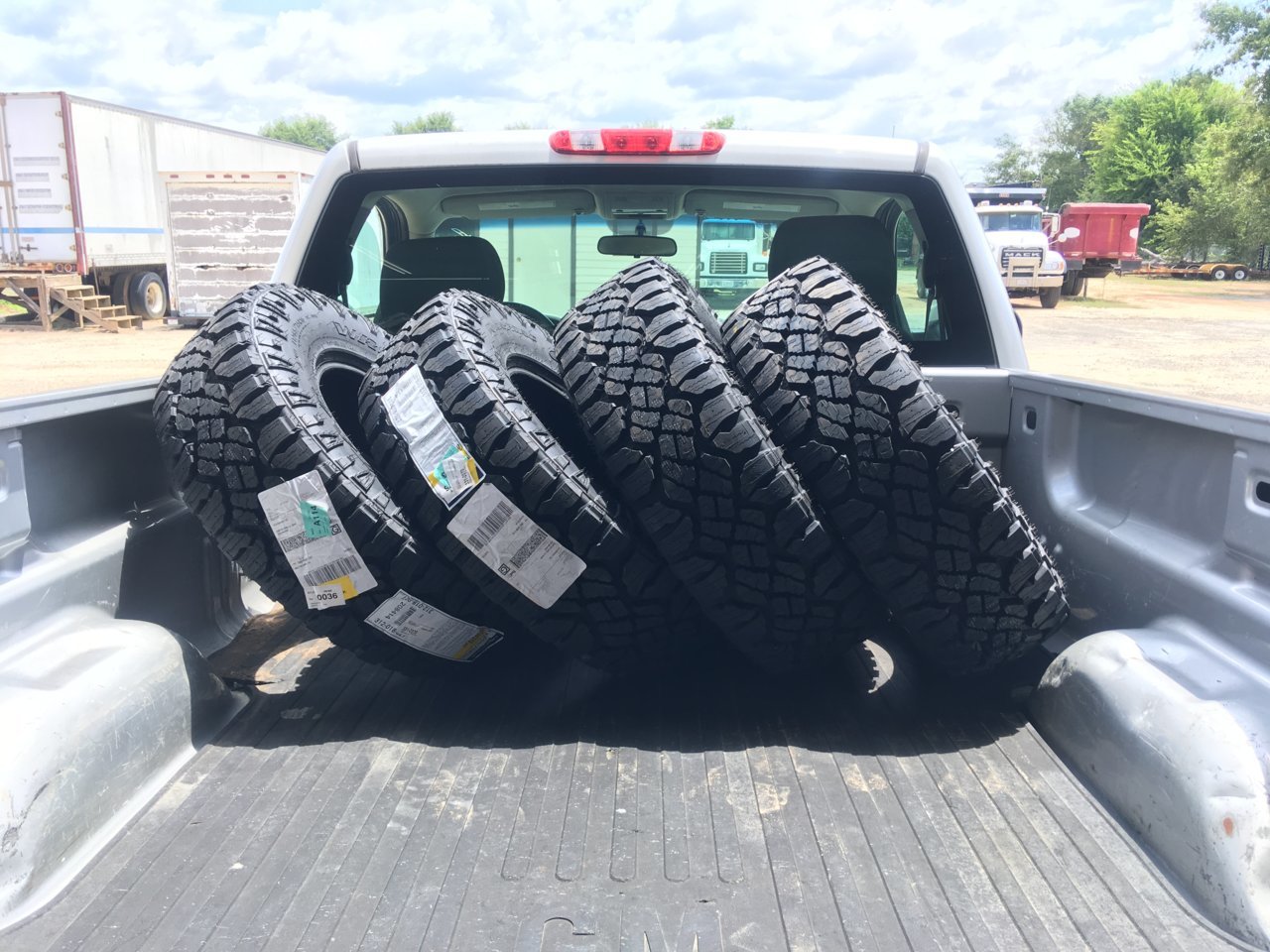

    Goodyear DuraTrac 265/75R16's Load 'C' installed. (57,570mi on ODO)
