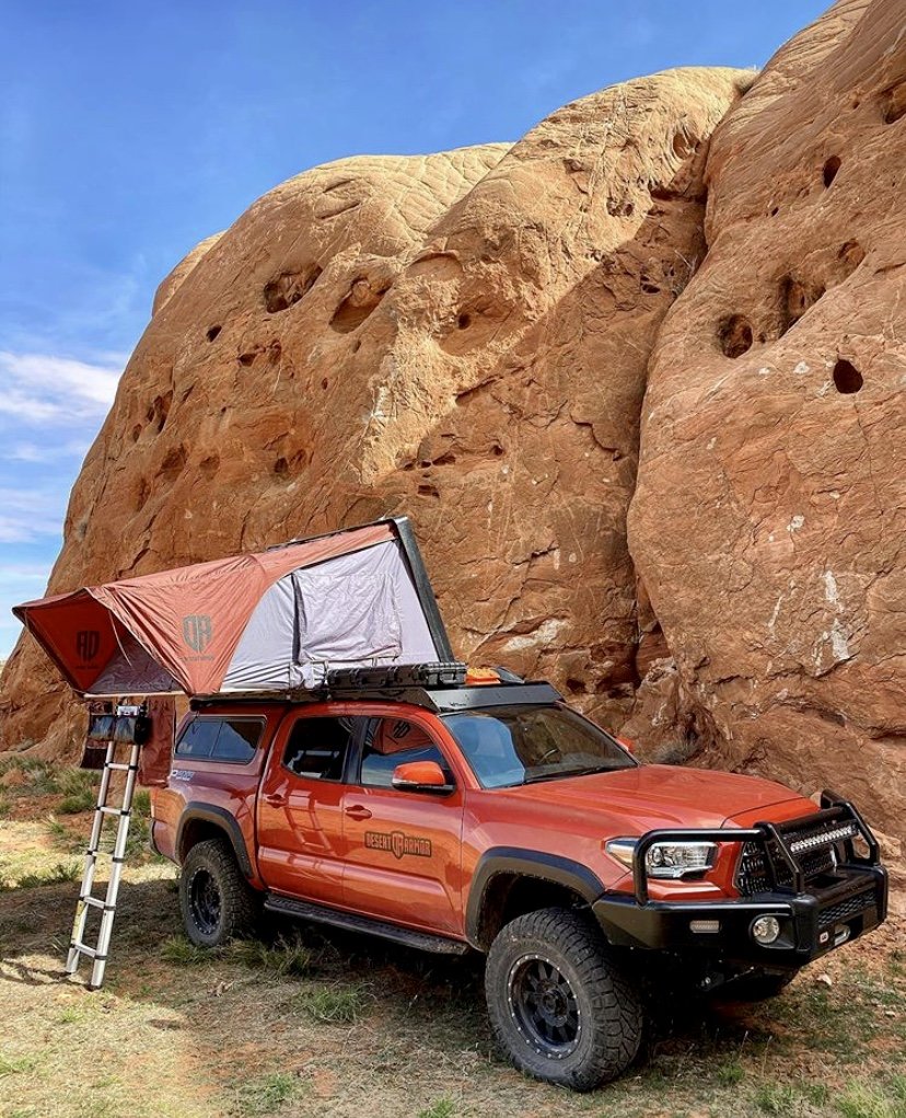

    I've canceled my order of the Leer topper, finally got the DWL (200lbs) and SWL (600lbs). I then looked into building a brace and found many people who have weatherproofing problems, and what's the point of buying a hard topper if it's not even weatherproof. I then looking into an exoskeleton but I don't know how to bend and steel tubing and not the greatest at welding tubing. I got quotes from local fab shops and they were between $500-$1,500, which puts me in the range of either an ARE CX HD, or an even better a full steel topper. Now looking into the RLD designs steel canopy, it has a 700lbs DWL, which is close to the SWL I need so it won't be a problem. The dealer I bought my tent through is also a dealer for the RLD canopy, so hoping they might throw me a discount. Anyone have any negative things to say about the RLD?

    @mariazimmerman Sorry, I never saw your message before but logged in tonight and saw the notification! I'm sorry if this is too late but thought I would reply anyways. I went with the RLD topper and have loved it! The waterproofing is nice, the stainless steel has held up very well, and I have no complaints. The only regret I have is not doing a flat bed with a full canopy. Between the price of the topper and my rear C4 bumper, I would've been a little shy of the cost of a flat bed and would have rather done that. The side access of a flat bed is nice. Granted the RLD has the side wings which I REALLY APPRECIATE. I wouldn't get a topper or rack without side access ever.
