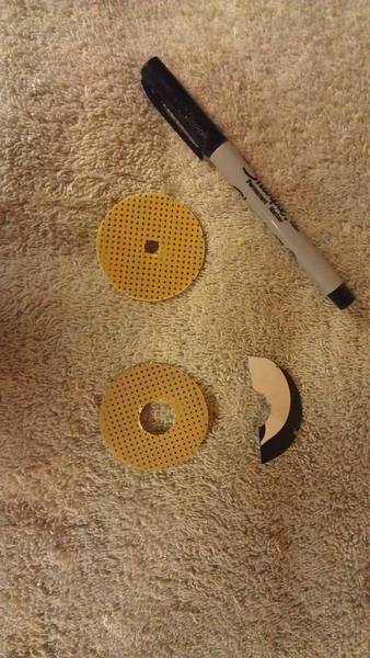

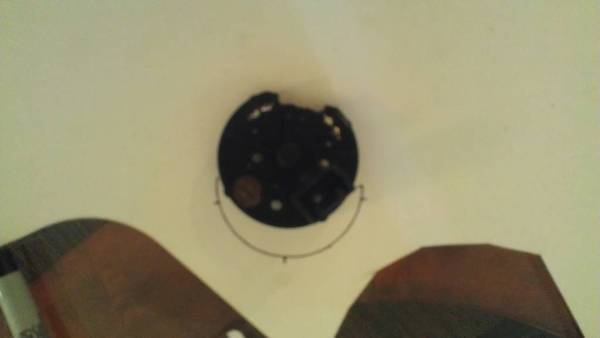

    I first started off by using the back of the switch to trace my template on paper.
    Trimmed the template, notched it and marked general locations for LED's then transferred it to a more ridged medium. (used my unused beer card from Old Chicago, could use an old gift card)
    Test fit the new template in switch, reassemble switch to make sure everything moves freely and works.

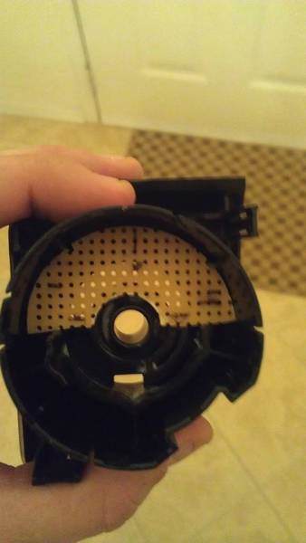

    I then measured the template and it turns out it is 2", so i used a 2 1/8 hole saw (2" inner diameter) to cut board out.
    Use Unibit to drill hole in center of board to match template.
    Cut board in about half to match template.
    Test fit board in switch housing, trim/sand where needed and mark locations for LED's with sharpy.

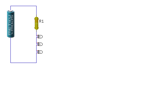

    Here is a simple series circuit for one of the two LED's/resistor set up where R1 is a 150 ohm 1/8 watt resistor. Then just parallel the +'s, and -'s. FYI this is based on a 14.4v supply voltage, 4v max/20 milliamps LED's, different color LED's may use different voltage or draw different amperage.
    Also the circuit's total current consumption is only about 32mA... so no you do not need to put in a larger fuse, but i do suggest that you fuse the 4x4 switch individually if you are not 100% confident in your work.

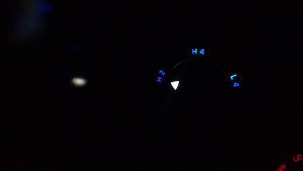

    Test switch... don't forget to turn on your headlights...
    Reassemble, and enjoy!!!
