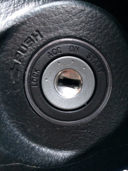

    Awesome that the Tundra ring is white! I think what I am going to do is remove the 4Runner Amber colored ring and sell it at a good discount to a forum member who wants to do the mod and has the amber dash. I am going to pickup one of these Tundra rings so long as it works out for you.
    Yep just like the link Up2NoGood posted, 4th gen 4Runner knobs work, they just protrude a bit. I haven't manned up and pulled my dash yet to install it but it will get done one of these days lol. Most importantly you can change the LED to whatever color you want since it just uses a neowedge bulb.

    Everything checked out great. Fits like it belongs there and more importantly the truck starts with it hooked up

    FEELER: Anyone who has a pre-2012 Tacoma (or 2012+ if you don't mind amber) with the amber colored dash interested in a lit 4Runner ignition ring?? Bought it for $108 (not including shipping). Would entertain offers :) I'll throw in some wiring pins for free, 2 + a couple extra just in case you goof up the first 2.
    Only thing is the "lock/ACC/On/Start" text doesn't line up like it should since the 4Runner ignition markings are oriented different.
