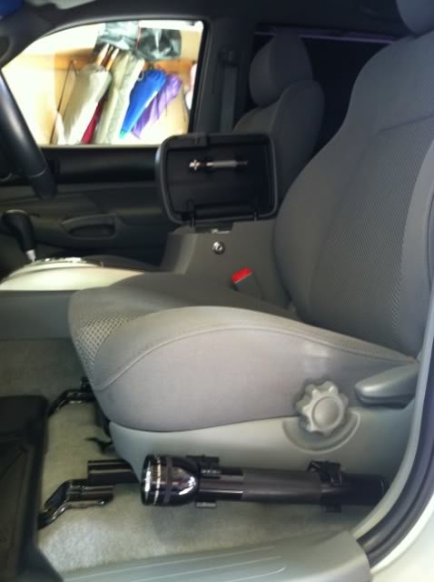

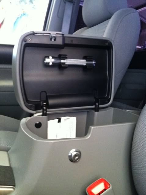

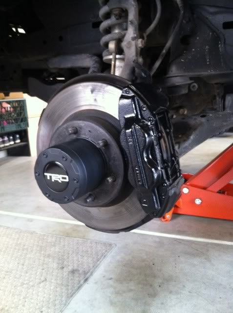

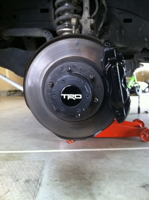

    Got a few things done yesterday...
    Mounted a Mini Mag Lite >>> How to <<<
    ...and painted the calipers black

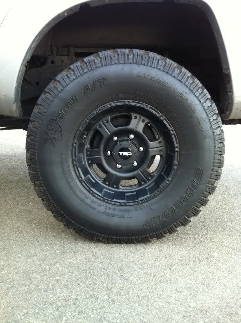

    nice build. did you have any problems with the 16x8 mojave wheels binding on the calipers? im trying to order some and every tire dealer in santa barbara claims they will hit and i have to go with 17's. i have an 09 4x4 access cab. also, do you think ill be rubbing with 265/75/R16 BFG MTs with the bilsteins set at 1.75. thanks. beautiful truck dude.

    They fit but very tight. The problem is the wheel weights. If they are double stacked then there is a good chance they can rub the calipers. So when you have them installed & balanced just make sure to tell the tire shop not to double stack the weights.
    Those tires will fit. You will probably have to remove the front mudflaps and trim the small plastic nub that hangs down in the front.

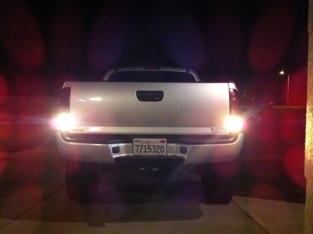

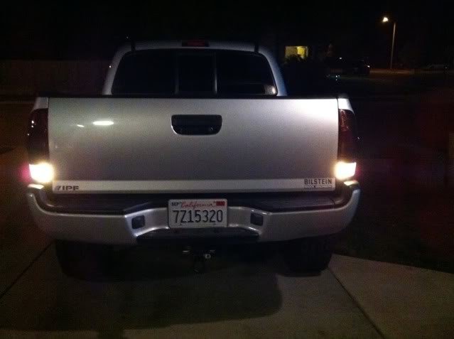

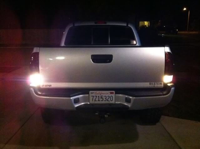

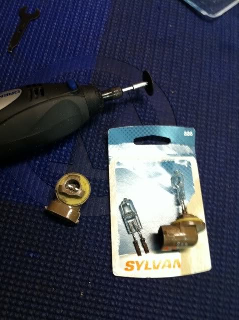

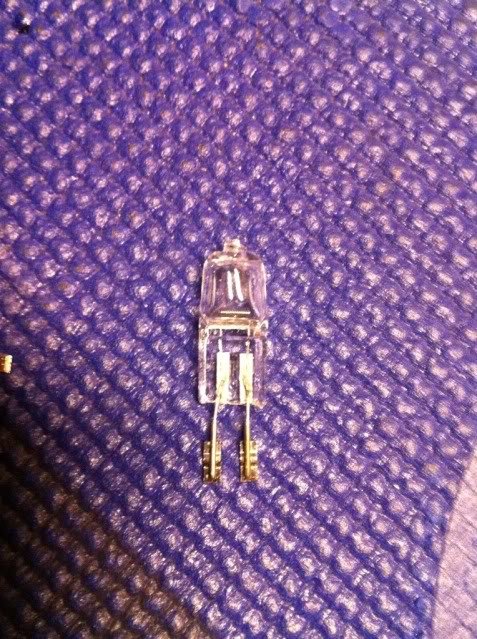

    Installed 886 bulbs for my reverse lights. They are much brighter than the stock bulbs help out because I have really dark rear window tint.
    886 bulbs

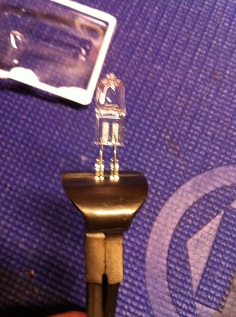

    Cut the bulbs from the plastic base with the Dremel
    I then shortened the exposed connections with End Cutting Pliers

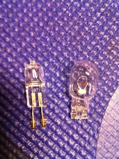

    vs. the stock bulb
    Before:
    Comparing (Left = 886 <-------> Right = Stock)
    Done:

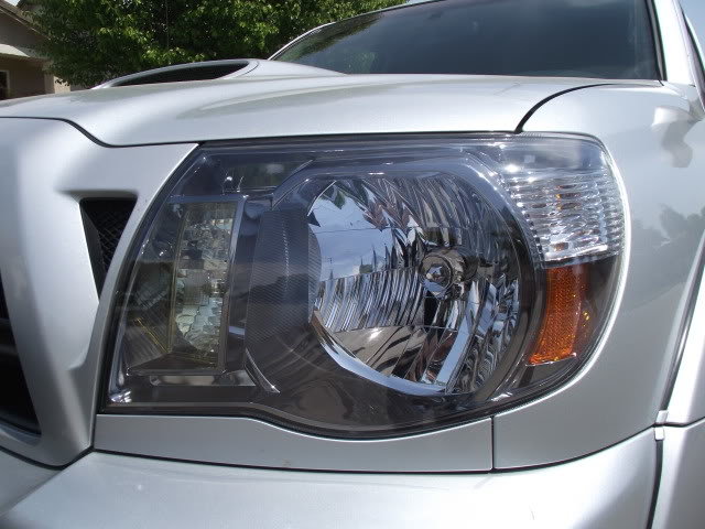

    Finally got some 2010 OEM Headlights. I've been looking for these ever since they came out and finally came across them on Craigslist for only $75.00!

    Looks good! I'm gonna do that reverse light bulb swap too.
    I'll buy your old Headlights. Are they yellowing at all? Missing tabs?
