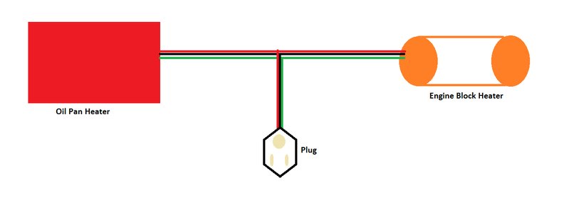

    So I'm moving to Anchorage in February. I bought an engine block heater and an oil pan heater. My question is is it possible to splice the two together into one plug? This way I have one plug up front and only have to plug it in for both components. I tried searching but couldn't find anything. Thanks for any input. Here is a drawing that I'm sure a 5 year old could've done better to "help" out.

    First off, where in Alaska? You won't need one really in Anchorage. In Fairbanks you might. Just get one of those 3 to 1 120V plug in adapters from a hardware store. Thats what everyone uses with more than 1 heating device. Zip tie those wires out of the way and you are good to go.
    Something like this.
    https://smile.amazon.com/Iron-Forge...01&sr=8-5&keywords=1+to+3+power+cord+splitter

    It "could" work. I would worry about the balance of the current draw between the two heaters depending on how you hook it up. This first assumes you have enough wire gage inline to handle the combined current.

    These are the two that I'm getting so since it seems you are much more electronically inclined than myself, how can I make it work safely?
    http://m.ebay.com/itm/281808952156
    http://www.wolverineheater.com/mobile/Product.aspx?ProductCode=9.1
    Then I want to combine them and use this plug for a nice, clean look.
    https://www.amazon.com/gp/aw/d/B009ANV81S/ref=oh_aui_i_sh_post_o0_img?ie=UTF8&psc=1

    I can't find amp draw on either .. just make sure you're comfortable with your electrical skills before splicing wiring together, I wouldn't imagine both of those pulling more than 10 amps total.

    I'll do some research on how many amps they're pulling. What would be a safe max to keep in mind?

    Probably 10 .. I wouldn't do anything more personally. The oil pan heater pulls 1.01 amps according to ohm's law.

    Awesome, thank you. I'll keep looking into the engine block heater. So as long as that number isn't too high, to connect the two together should be as simple as positive to positive, negative to negative, and ground to ground, correct?
