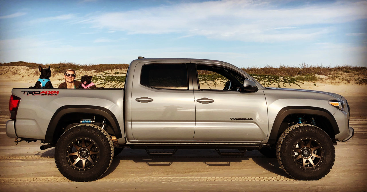

    King 2.5s front / rear Icon AAL, Icon UCAs, Icon Rebound wheels Nitto Ridge Grapplers 285/75/17 OVTune
    Kings 2.5 front/rear
    Icon AAL
    Icon Delta Joint UCAs
    Icon Rebound wheels; 0 offset, 4.75” backspacing
    285/75/17 Nitto Ridge Grapplers
    Zero rubbing.
    With the predator steps, getting in/out is easy. My wife is 5’ 5” and has no problems. 012E5C50-734C-4ABC-B4FE-21E94C102ED3.jpg

    Ohh.... and those kings are niiiiice

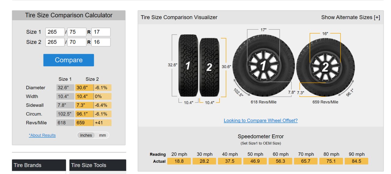

    Not quite sure what you mean by "not risk hitting the brakes" but 17" wheels will be fine for you. On 265/75/17's you shouldn't rub anywhere under "normal" driving conditions, especially if you do not remove your sway bar.
    This website is a great tool for learning and checking tire/wheel info. 265 is the width of the tire, 75 is the height, 17 is the wheel size. This picture can help, the size you want compared to stock.
    King is definitely the "best" most people will tell you. I personally don't have them(yet) but a lot of people I wheel with do and they love the ride. The front coilovers are adjustable. I think anywhere between 1.25" and 3". So if it is too tall for your wife you can crank them down lower. Remember every time you adjust them you will need to get an alignment. Also, if you decide for whatever reason to have them higher than 1.75", you will need to get aftermarket UCA's(Upper control arms) to allow you alignment to get back within spec.

    Thank you so much, your post was a great help. (Hitting brakes?) I have read that on some 16 inch rims the calipers hit the weights put on the wheels for balancing purposes. At a reputable 4wheel shop the salesmen told me to go pick a wheel in the 17 inch class to eliminate that chance.
    I messed up in my post you read. I made an edit, 265/75 tires don't come in a 17 inch but does in 16 inch.
    I would be thrilled to get into some 275/70 on a 17 inch rim. The site you suggested I have been on every night for the past 2 weeks. The site tells me I would be 1.5 inches higher then my truck stock now,per my wishes. I was hoping with Kings and only an inch lift it will leave me some clear sailing.

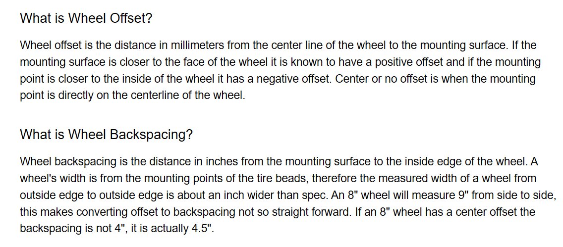

    Your specs of 0 offset and 4.75 back spacing sounds like what I need. Are there specs that are even more optimum for our truck?

    Stock wheels are 16” so that’s dumb if thy told you that. 16” and 17” are both good choices. I’ve been rocking 17” mainly at first due to what was available but also ended up swapping to T4R breaks than Willwood that required 17” wheels if you ever feel the need to swap.

    They don’t stick out at all. If I remember, I’ll post a pick after the sun comes up.
    IMO; that wheel configuration (0 offset; 4.75” backspacing) is perfect.

    I'm wondering if the ray 10 17 inch 8.5 4.3 backspace -10 offset is OK. If 0 is perfect is 4.3 almost perfect.
    I read in another thread where a guy was having tons of drama with the 17 9 3.5 backspace and 38 offset.
    I like these https://www.wheelsforless.com/D5791...XWYIOz7wuvTWmspidxkcE75WfheTEOfhoCDTcQAvD_BwE
    But they are 16 8. 20 offset 5.25 backspace. I'm going crazy and need help.

    I have a 1” lift all around with 275/70/17 with Ray10’s that have -10mm offset. No rubbing issues whatsoever and I’ve taken it off-road quite a bit. At 1” you will be fine.
    OP, no disrespect but from your post I’m assuming you’re fairly new to this. Just keep in mind with Kings, you will have to rebuild them at some point. I’ve read it’s in between 50k-60k, I could be wrong but that seems to be the general census around here. Depending on you’re driving if you go off pavement and utilize your shocks for what they’re intended, that’ll significantly wear them down sooner and warrant a rebuild sooner. So just keep in mind that you will have to pull your suspension ever so often and either do it yourself or pay a shop to do it for you. I may suggest going with something more practical, such as a Toytec Boss kit or Bilstein 5100’s paired with OME 887 up front and a add a leaf in the rear. I’m no expert but I’m passing on what I’ve picked up from here.

    There is no such tire size available as 265/75 r17, only 265/70 r17 which is 31.5”
