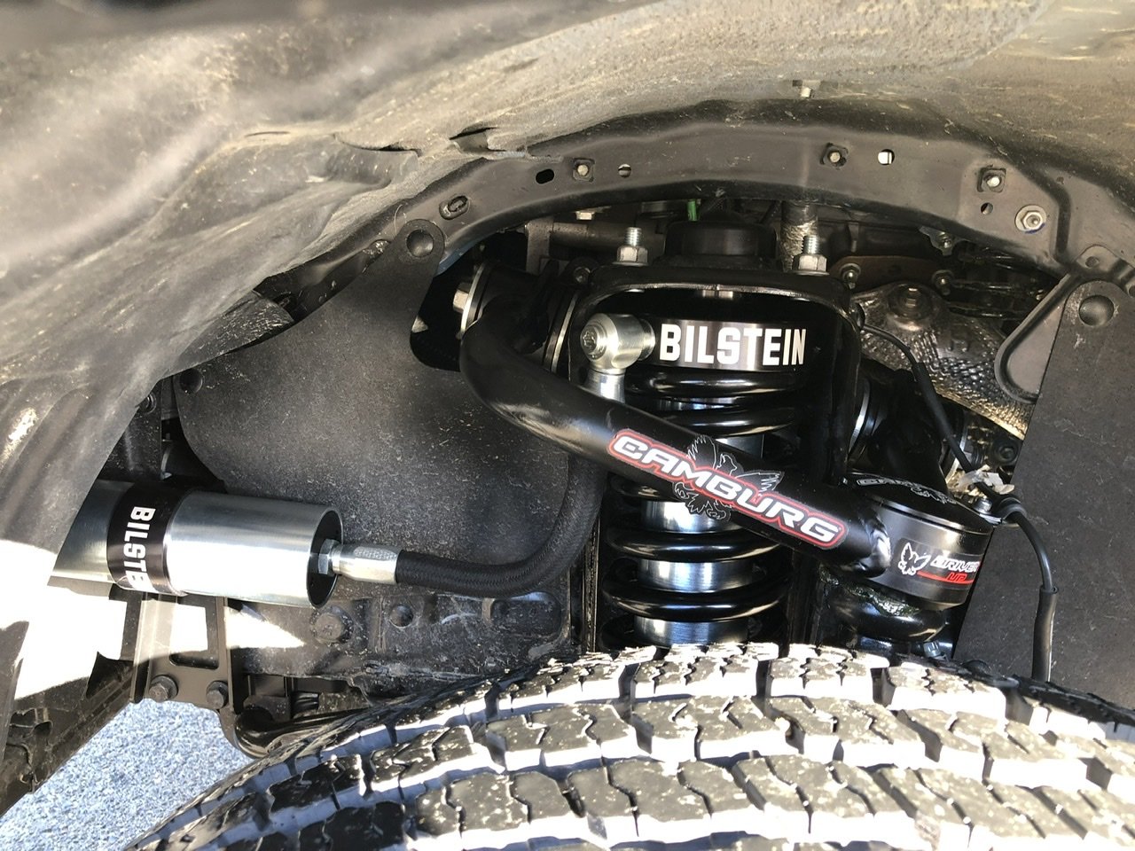

    As to the shocks... Remember that these suspensions are more finally tuned and sensitive than that ole’ 1970s Ford Bronco we both had. If you go up even 1-2” in height, you really should do upper control arms. Here’s some pictures of the Bilsteins with Camburg UCAs.

    Let’s start at the front: 8112s came with only 600lb springs originally. The lift was designed as 1/2”-2 1/2” lift. Bilstein techs used Camburg UCAs in their original setup and in their instruction sheet. 650lb and 700lb springs came later to accommodate lifts with lots of added weight. I don’t have any added weight up front and installed my setup last January. I am running 265/75/R16 Wildpeaks. My center hub to the bottom of the front fender is 22 1/4” on each side. Ironically, that’s the same height as Oscolivar1 with 650lb springs. My preload on the passenger side is the same at 1” and on the driver’s side my preload is a little more at 1 3/8”. Oscolivar’s truck sits higher at 38” to the bottom fender while I’m at 37 1/4”. My guess is this is due to tire size.
    I would definitely install UCAs, when you are deciding on which ones, the main difference is the ball joints. You need to decide which ones are right for you. The other consideration is the ECGS bushing. I didn’t do it, and so far no issues.

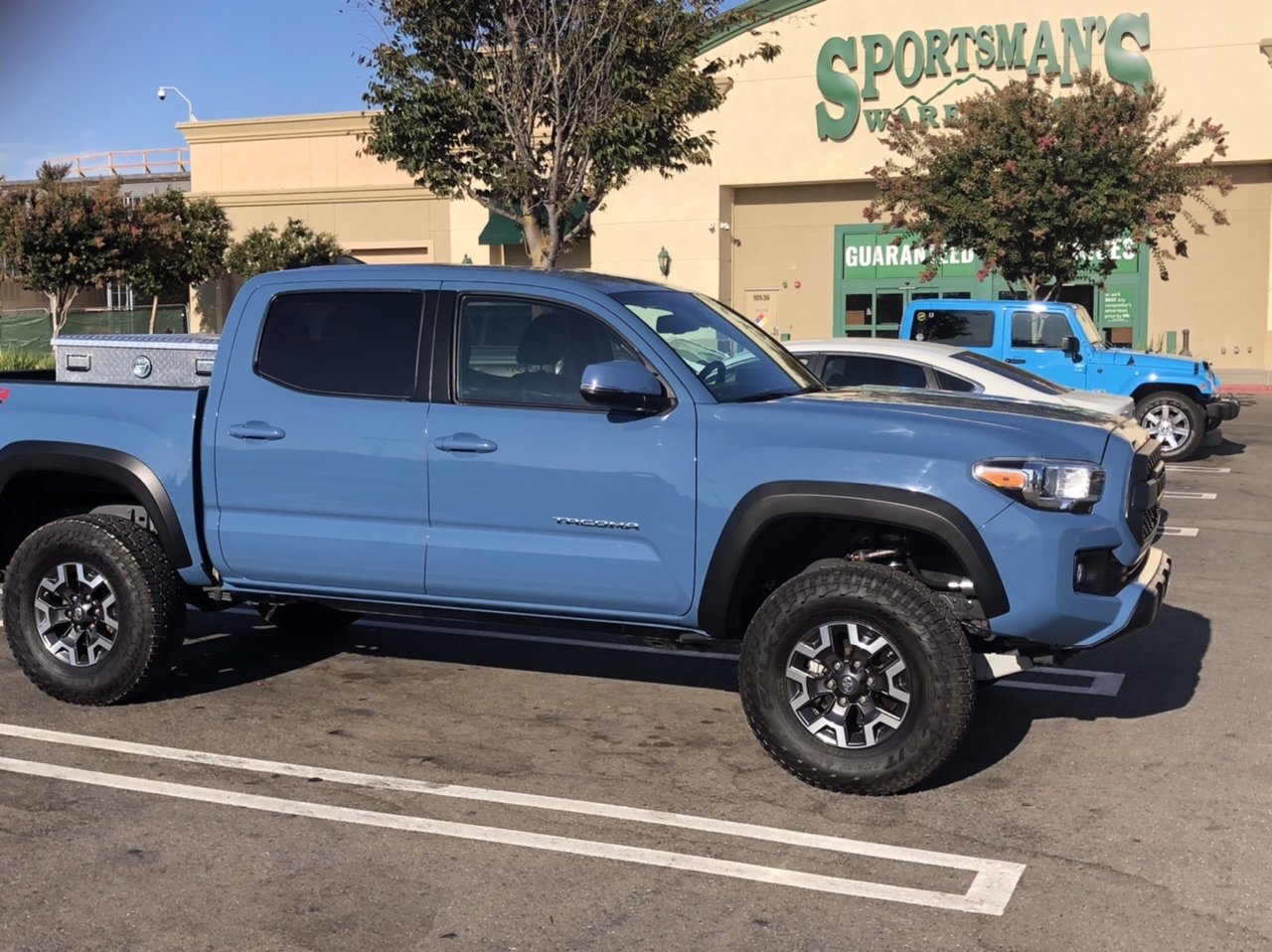

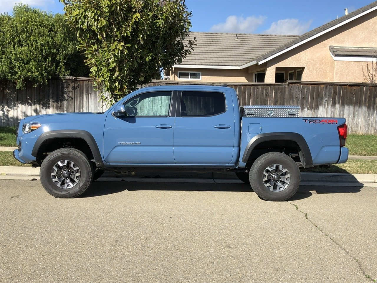

    So, here’s another thing to think about: perception and appearance, If you only go up 1”-1.5” and you run 265/75/R16s (like my truck) I don’t think you will really feel like your truck is lifted. In fact, I often feel like I’m at stock height like other DCSBs. It’s only when we park side by side that I notice a difference —and if I’m parked along side with someone with stock suspension and aftermarket wheels and tires the same as mine or bigger, I feel like their truck is taller. If you look at the pictures above, Rustytaco’s truck looks taller and beefy. But if you look at his space between the top of the tire and his fender well and compare it to mine, I think you will see I have more fender well showing. Some of that is offset and some of it is the lift. I like a little fender well showing —takes away some of the concern if and when I stuff a fender with a tire.

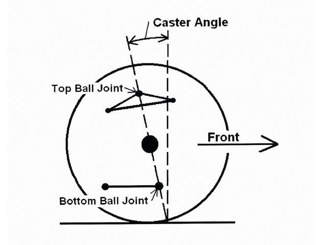

    And that’s where UCAs come in play. While you won’t “need” UCAs (just like Rustytaco), but what UCAs will do is actually move your wheel hub slightly forward so you won’t rub in the rear in reverse at full lock. Remember, you are changing the geometry of your truck. As you raise it —even just an inch— you unintentionally move the wheel hub (and therefore the tire) rearward. UCAs correct that and allow you to move the wheel hub forward and run an oversized tire without rubbing. Everything you do to the suspension affects something else in the suspension and drivetrain.
    New UCAs will move the position of the upper ball joint and increase your positive caster.
