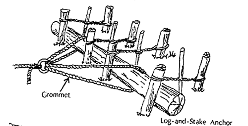

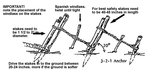

    In boy scouts we used to make anchors using a group of live tree limbs.
    You can even group them together with a log.
    If you have tons of time and nothing to anchor to, you can make as many of these as you need.
    http://pioneeringmasters.org/PM_anchors.php
