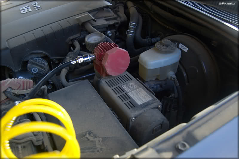

    they are one and the same..just branded slightly different.
    the one i had lasted well over 2 years and survived just about every weekend of use, and not only only inflating my tires but those who didnt have a compressor that was with us. not bad for 60 bucks at the time. it recently died from an eternal mechanical malfunction. i am not complaining and will be buying another for a replacement.
    i got tired of always unpacking/repacking the compressor i end up hard mounting the compressor inside my engine compartment..

    ^^ Oh, that's cool. Fits in so well, looks like it actually belongs in the engine compartment. All except the bright yellow (detachable) hose, of course.
