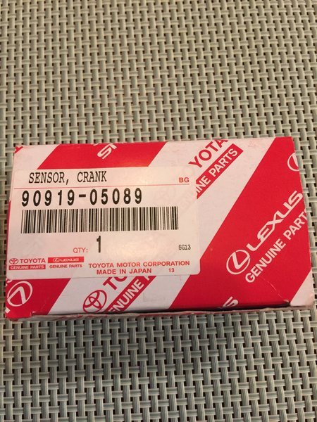

    With all this CPS discussion, I decided to go under my truck to pull it off after setting it up on some ramps. Just gave the rubber boot a quick squeeze as it has marks and a shape molded over the release tab to ease detachment. Pulled the 10mm bolt off and it pops right out.
    Mine has abuild date of 7/16/2016 and the factory sensor has the crosshatch marks as many have indicated as the superseded part. I had a brand new spare in the g-box that is identical to the installed one as "insurance" for the "just in case" moment. Bought before I actually checked it.

    Honestly, no. The sensors are made in Japan. But I remember another CPS thread that had a poll with the ability to track where it was manufactured and see which factory sent out more trucks with this "issue". Hard to trace accurate info as many Tacoma owners do not have accounts on this forum, if they have been affected by this CPS issue.
    I just put the info out for those curious and if it gets traced back to that poll thread. If you guys do eventually check, be careful with the boot and the heat shielding wrap. It can place a lot of strain on the connector joint if frustration sets in. It can be very easily removed if you can pinch the right spot. I remember an arrow indicator molded in the boot just above the connector detent. There is also a very positive and audible click when reinserting. Hope this helps.
    Not as daunting as it may seem, but wait for the engine to cool a bit as it literally sits a couple of inches from the catalyst.

    @over60 I will let you know if I decide to! Shipping to CA isn't cheap though. The dealers there don't have it?
    Just FYI, if you're curious about part number for the 3.5 V6. There are already part numbers out there, but redundancy never hurts especially if the thread gets deep. Here's the actual item...image.jpg
