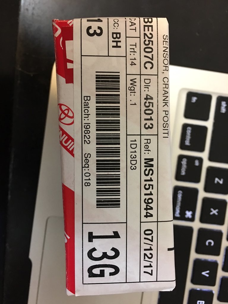

    I just ordered a replacement sensor for my '17 and it doesn't have the hash mark shown in the previous post. I bought it from McGeorge btw...Should I send it back? From the looks of the box, it appears to be made just last month.

    Is it part that ends in 98?
