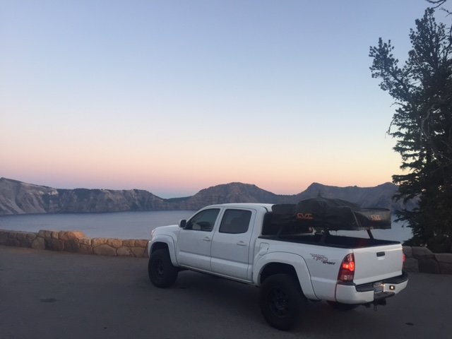

    Realistically anything over the roof is going to drag and make noise. A fairing would help you, how bout a lower bed rack? I forget it's there, quiet and no less mpg than usual road trips. I don't use my RTT annex and this works for me the best1443184872_8e8a9b2522172bf878b6a8139ac594adb270af08.jpg

    Very good setup if you do not have a Cap on the bed! :thumbsup:

    Thanks! At times I still want a cap but I like this set up more.
