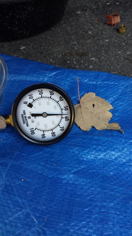

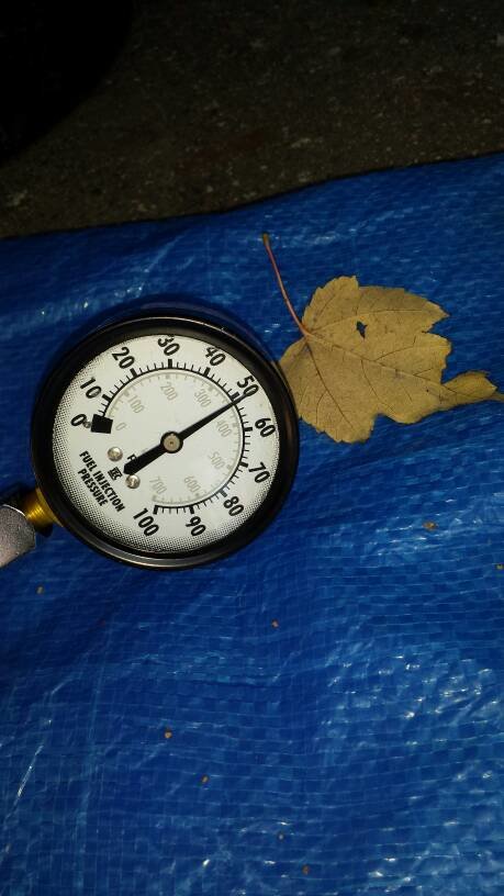

  13. Nov 30, 2014 at 8:28 AM
    #33
    Sandman614
    Oct 26, 2010
    #45273
    36,033
    Tim
    Garner, NC/Boone, NC
    '06 SR5 Off Road
    Just checked fuel pressure:
    Key on engine on
    Key on engine off
    Key off pressure drops back to 0psi
    Crom likes this.
  14. Nov 30, 2014 at 9:00 AM
    #34
    Torspd
    Torspd Tor-nication
    Sep 18, 2009
    #22958
    26,452
    Tor
    The Great America!
    MMVI 4.4L 4x4 Access Cab
    Torspd Custom Turbo kit [] Borg Warner 9180EFR Turbo [] Haltech Elite 2500 [] TiAL Q BOV [] TiAL V44 Wastegate @ 15psi [] CP Pistons [] CP Carrillo Rods [] ARP Head studs [] ARP Main Studs [] ARP Header - Head Studs [] Ported Heads w/ 1mm oversized valves intake/exhaust [] Brian Crower Forged Stroker Crank [] Darton M.I.D. Sleeved Block [] Kelford Camshafts [] Torspd 160* T-stat mod [] APR Large Fuel Rail [] Walbro 460 LPH E85 Fuel Pump [] FueLab FPR [] APR T56 Conversion Kit [] KP RACING Built T56 [] McLeod Racing Custom Twin Disk Clutch [] One Piece Aluminum Driveshaft [] MGW Shifter [] Custom lowering kit [] Ohlins Front Coilovers [] QA1rear shocks [] Custom Ron Davis Radiator [] Dual SPAL Electric Fans []
    That is much higher than it should be. 43.5 psi is where it should be around. Unless you have an aftermarket FPR, and have raised your fuel pressure.
    That is just strange.

  15. Nov 30, 2014 at 10:11 AM
    #35
    Sandman614
    Oct 26, 2010
    #45273
    36,033
    Tim
    '06 SR5 Off Road
    It should still be stock. That's measured just outside the tank where the URD filter is. I know the fsm says 40.8-41.7psi
  16. Nov 30, 2014 at 12:12 PM
    #36
    Ostrichsak
    Ostrichsak Don't taze me bro!
    Apr 5, 2012
    #76327
    9,122
    Jer
    Northern Colorado, USA
    Supercharged '10 Tacoma 4x4 TRD
    TRD Supercharger + too much stuff to list. Click sig pic
    If you're taking the measurement before the fuel filter and it's that much higher than at the rail (you did check it at the rail, right?) then it's the sign of a possible blockage or filter that needs changed. This points to that post I made about the OEM fuel filter versus traditional fuel filters. How many miles on that fuel filter?

  18. Nov 30, 2014 at 2:20 PM
    #38
    Sandman614
    Oct 26, 2010
    #45273
    36,033
    Tim
    '06 SR5 Off Road
    The filter and pump are brand new (couple hundred miles from PA-NC). I assume the original filter on the pump was clogged, that's what led me to put in the urd pump and external filter kit.
    I did not measure at the rail (lines on driver fender) because I damaged the rubber coating on the hard-line end of the quick connect. It still seals and I'm not taking it apart.
