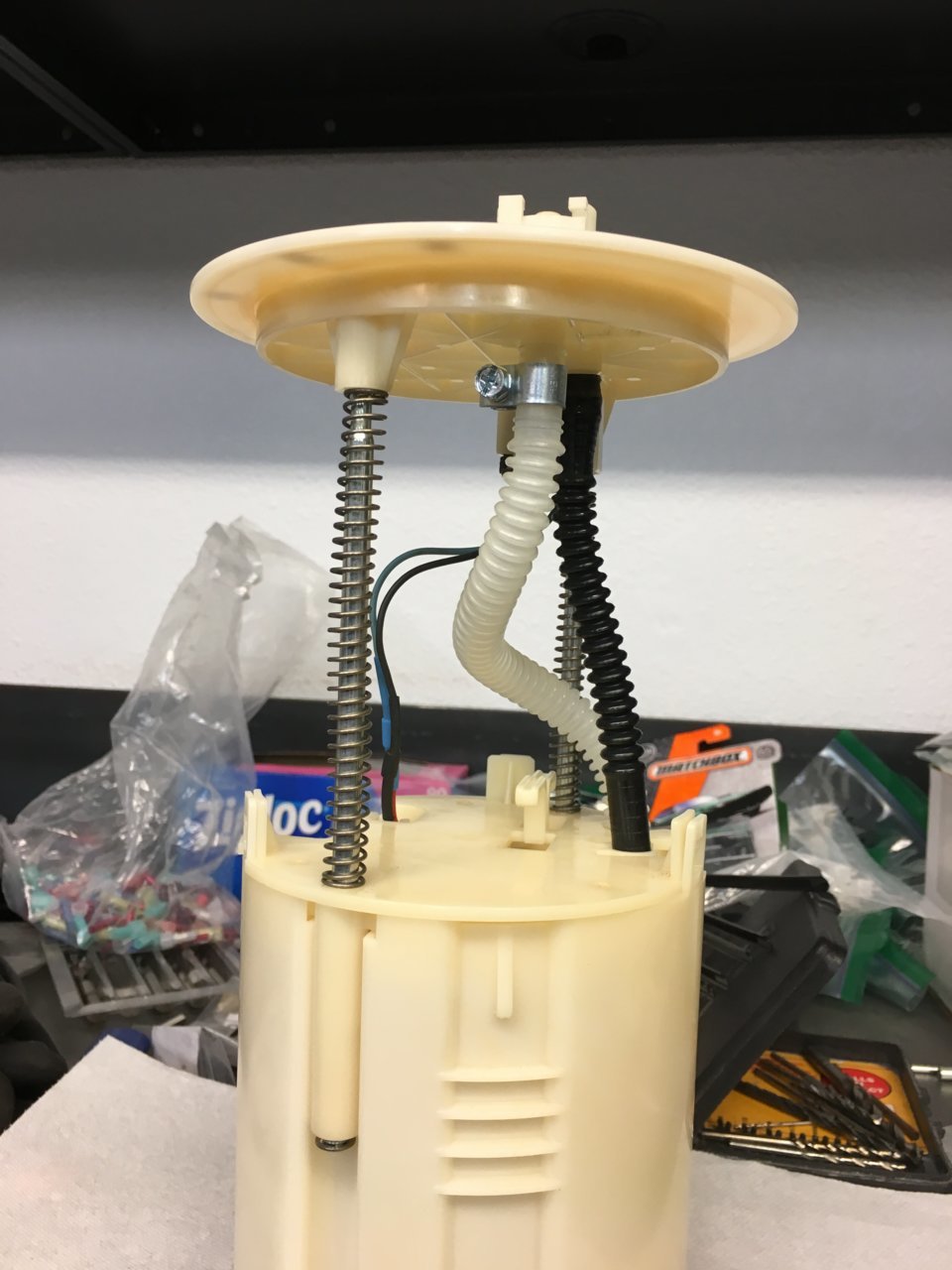

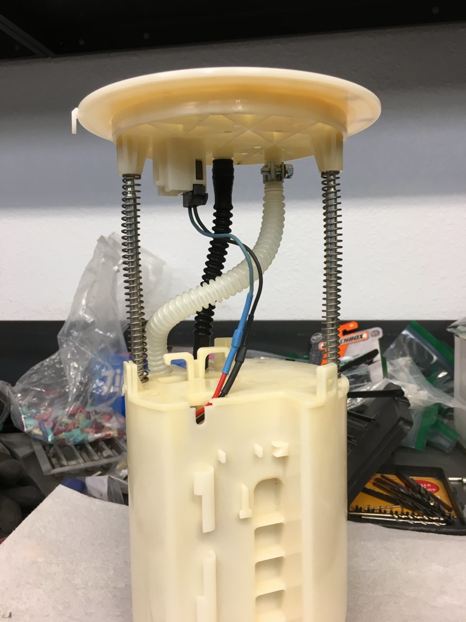

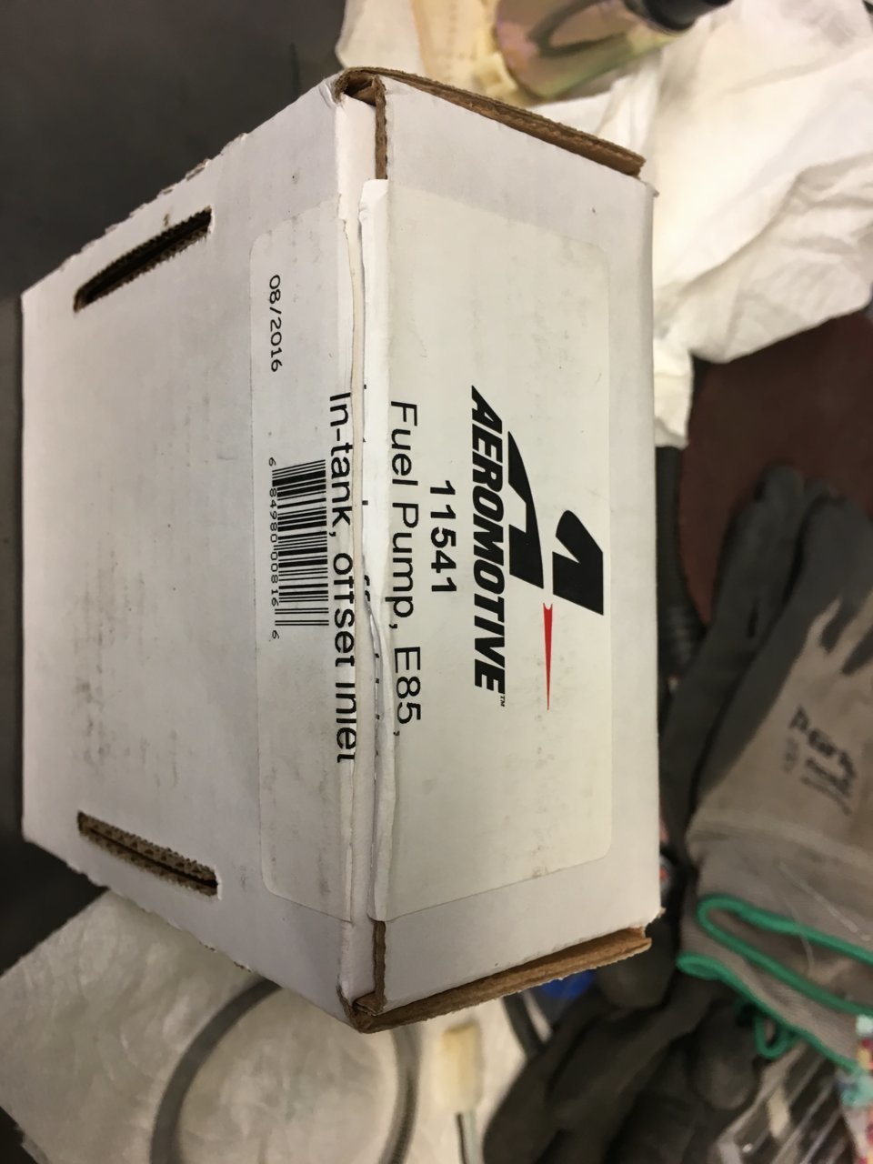

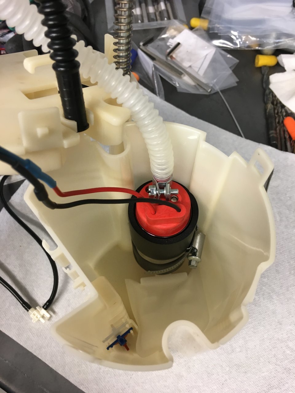

    FBD9E883-17AF-4875-A26A-FDD1795C47D8.jpg 4391CE0D-94C4-4900-8BE2-4705929FDEFB.jpg 97F076CE-5CC1-4262-BA92-32317C603047.jpg 3377680E-6528-4C98-90F0-CB7E2FCB8265.jpg 413FB4E5-54C8-475E-915D-107BFAF8D280.jpg E4A0FD25-E017-4D1E-80F3-ED390F205306.jpg 317FA742-5C75-4C08-BEFF-A951E918705B.jpg Pics always help.
    I’ll post up some pics of my filter setup soon.

    Bravo, with the accordion tubing. :thumbsup:

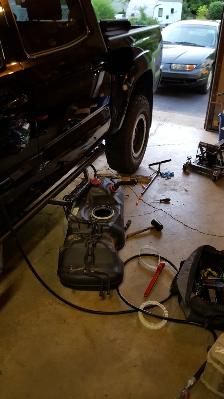

    Make sure you have something like this to disassemble, and reassemble the threaded nut that holds the pump filter into the tank. I didn't measure the diameter, but it is at least 8"....so, you need a minimum of 13" usable rubber strap. I didn't have one that large, so, I used 2 in conjunction to loosen, and then re-tighten the "nut". Other than that, it was super easy. I used the rubber hose that URD sends with the kit, but would much prefer the hard plastic hose mentioned early in the post. I have the band clamp on order as well, because I don't like zip ties for the long term to hold the fuel filter up. No transmission jack needed, just run your tank down to 1/4 or less and have some blocks or 4x4's to lower down the tank to...incrementally. Super easy swap. Not sure why I was timid.

    I used an oversized strap wrench I found at O'Reilly Auto, but it sucked because the strap isn't rubber so I ended up unscrewing the pump assembly retaining ring by lightly tapping the teeth with a screwdriver and rubber mallet. Came off pretty easy then.

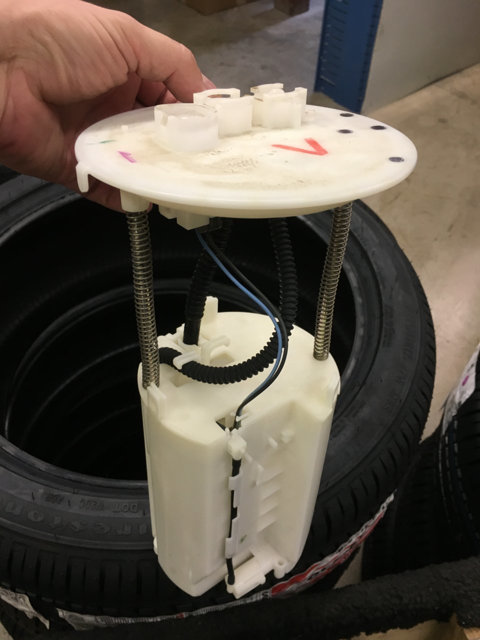

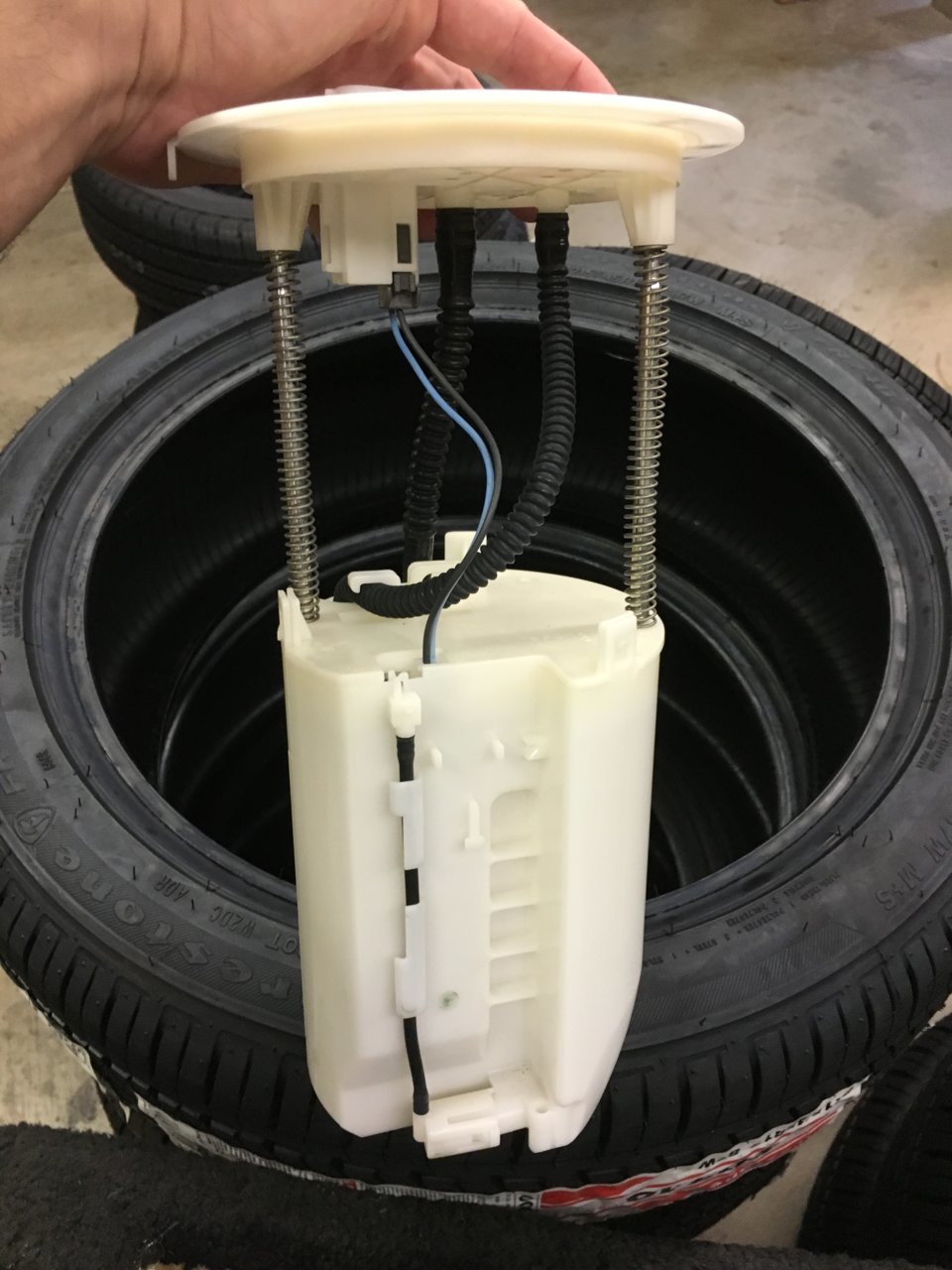

    Ok, I bought the stuff to do this upgrade back in December of 16. The truck was running great with the stock fuel pump. So, I was in no real hurry. The new pump languished up in my garage cabinets until April of this year. At that point I had stumbled across a Tacoma fuel pump module that I could modify and add the fancy new pump to. I posted pics of when I did that earlier in this thread.
    The idea was to minimize truck down time by having the new module ready to go. Just swap them out.
    This past Thursday night I finally dropped the tank, swapped modules and had it back in and running in about an hour. Having the pump module ready to go worked out perfectly.
    Anyway... What I'm getting at is that I've got this pump module that I removed from my truck sitting here. It's in perfect shape. You'll just need to transfer your fuel sender. I'd poached that off of it for @GT7 when he was trying to fix an issue with his. PM me if you're interested.
