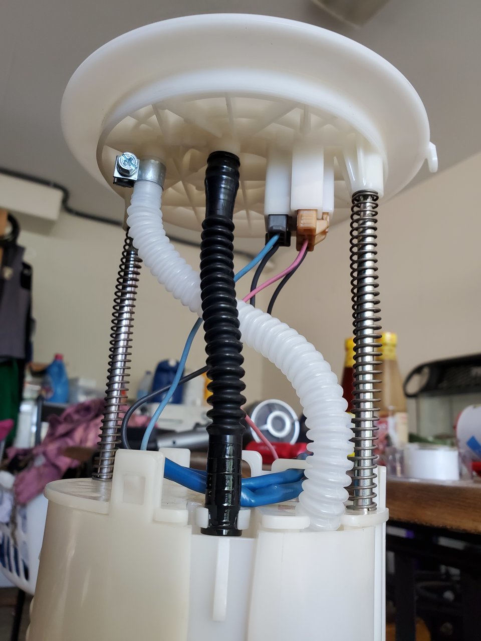

  7. Jan 10, 2020 at 6:22 PM
    #107
    lemon177
    lemon177 Well-Known Member
    Feb 17, 2012
    #73005
    887
    Matthew
    Oahu
    09 tacoma 4x4 sport pyrite mica
    TRD supercharger, URD 2.85" stealth pulley, TRD exhaust, TRD intake, DTLT headers, URD y-pipe, TRD boost gauge, PLX DM100 touch with OBDII and SM-AFR modules, 885 OME 3", Icon UCAs, Satoshi grill, Solid rear window, SCS stealth 6, 285/75/17 toyo AT2.

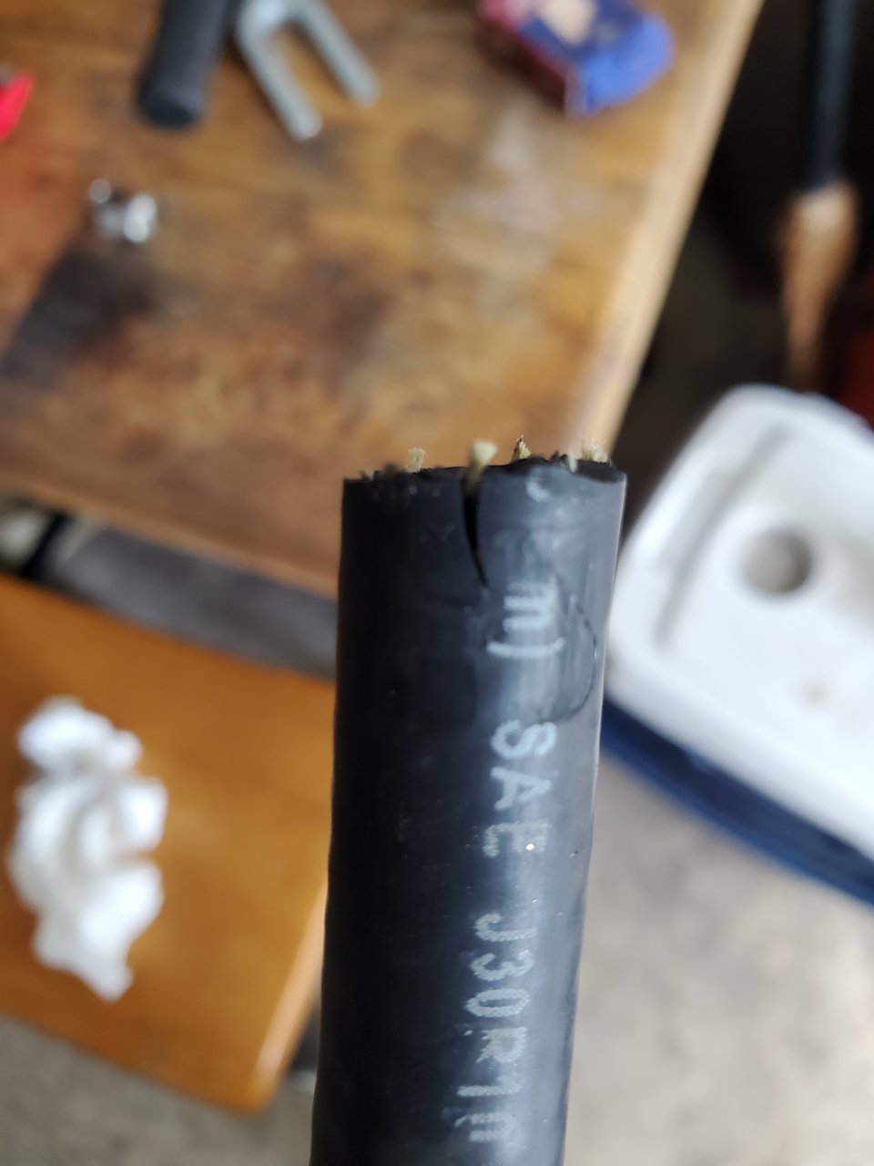

    So it took another 9 months for the hose to split again, and this time i was ready with appropriate fuel tube. You can see the minor crack on the fuel line starting up (i began to suddenly get the hard start problem).
    Kolunatic, jamesepoop and garciav like this.
  8. Jan 13, 2020 at 10:28 AM
    #108
    Torspd
    Torspd Tor-nication
    Sep 18, 2009
    #22958
    26,446
    Tor
    The Great America!
    MMVI 4.4L 4x4 Access Cab
    Torspd Custom Turbo kit [] Borg Warner 9180EFR Turbo [] Haltech Elite 2500 [] TiAL Q BOV [] TiAL V44 Wastegate @ 15psi [] CP Pistons [] CP Carrillo Rods [] ARP Head studs [] ARP Main Studs [] ARP Header - Head Studs [] Ported Heads w/ 1mm oversized valves intake/exhaust [] Brian Crower Forged Stroker Crank [] Darton M.I.D. Sleeved Block [] Kelford Camshafts [] Torspd 160* T-stat mod [] APR Large Fuel Rail [] Walbro 460 LPH E85 Fuel Pump [] FueLab FPR [] APR T56 Conversion Kit [] KP RACING Built T56 [] McLeod Racing Custom Twin Disk Clutch [] One Piece Aluminum Driveshaft [] MGW Shifter [] Custom lowering kit [] Ohlins Front Coilovers [] QA1rear shocks [] Custom Ron Davis Radiator [] Dual SPAL Electric Fans []
    All good now I take it?
    I still need to change some fittings on mine and add this hose. As well as the Holly hydramat.
    buyobuyo likes this.

    So far so good, buts only been a few days. I hope this is thee permanent solution, as i dont think im ripping the hose by going to tight on the clamp. I have the DW pump, so im looking at previous posts about the check valve add in

  10. Jan 22, 2020 at 12:36 PM
    #110
    jamesepoop
    jamesepoop Well-Known Member
    Feb 22, 2017
    #211394
    1,117
    California
    2007 Fj Cruiser

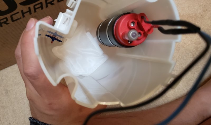

    I'm at a 175000 miles, 07 MY, but just barely getting broken in.. did anybody replace both tubes or just the fuel pump assembly hose? Is the tube fairly durable that I wouldn't have to worry about the other corrugated hose?
  11. Jan 22, 2020 at 12:42 PM
    #111
    BassAckwards
    BassAckwards Well-Known Member
    May 3, 2016
    #186002
    27,954
    2009 Tacoma AWD Turbo 2TR-FE
    Full-time AWD & BorgWarner EFR 6258
    I replaced both, but only bc i fcked up and cut the return hose instead of the high pressure lol. I used the racetronix hose for the high pressure and then used the URD rubber fuel tubing to make another return line
    Torspd and jamesepoop[QUOTED] like this.

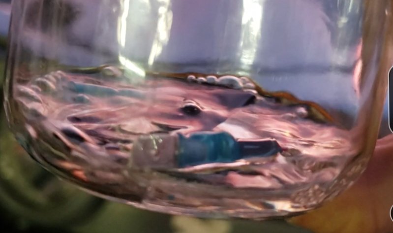

  12. Jan 27, 2020 at 4:48 AM
    #112
    jamesepoop
    Feb 22, 2017
    #211394
    1,117
    California
    2007 Fj Cruiser

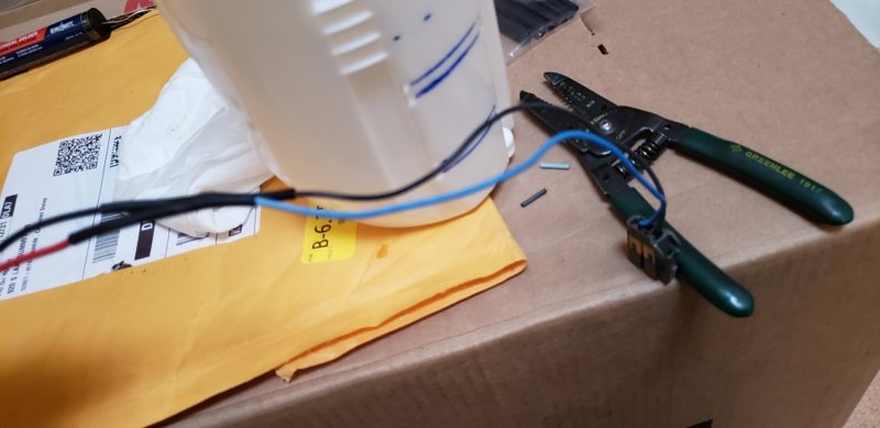

    Just finished the wiring today but I think I need to use butt connectors for longevity. Did anyone use heat shrink with any success or do I need fancy raychem dr-25? Any suggestions
    Torspd likes this.

    Regular heat shrink, if memory recalls correctly, has failed to last.

    Thanks. Changing it out today to those heat shrink butt connectors, dense plastic I think.. we'll see what the electronics store says.
  15. Jan 27, 2020 at 5:56 PM
    #115
    buyobuyo
    buyobuyo Read The Fucking Manual
    Jan 24, 2008
    #4417
    6,291
    Jeremy
    Camden, AR
    08 PreRunner SR5, I4, Manual, Silver
    A thing or two...
    When dealing with fuel you need to make sure whatever you're using is fuel resistant. McMaster has fuel resistant shrink tubing. https://www.mcmaster.com/heat-shrink-tubing/=ae2e93ca1f924877b453c3acc0051115k5x89eb4
  16. Jan 27, 2020 at 6:28 PM
    #116
    jamesepoop
    Feb 22, 2017
    #211394
    1,117
    California
    2007 Fj Cruiser

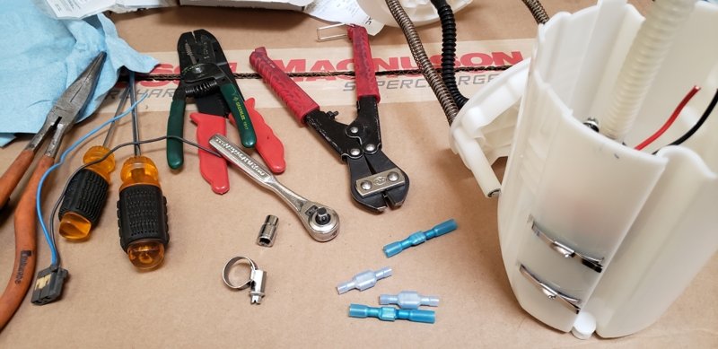

    Several brands will list as fuel/oil/solvent resistant, but that doesn't actually confirm fuel submersible. A good example is that you can't use standard fuel injection hose in the in the tank for the feed line or there's certain degradation and compromise. I've narrowed it down to two:
    -nylon (which is highly resistant against fuel and used on the stock corrugated in-tank tubes) or
    -heat shrink insulated connector that looks like some poly type and has a inner adhesive lining. It seemed to hold uniform while sitting in gasoline for the past few hours... if only I could see in the future.
    Mech_Eng and Torspd like this.
  17. Jan 29, 2020 at 12:55 AM
    #117
    jamesepoop
    Feb 22, 2017
    #211394
    1,117
    California
    2007 Fj Cruiser
    Thanks for your help. Just went with nylon insulated, the obvious choice and most resistant. Thought the wiring needed to be heatshrunk for safety but not so. It's just to keep them from shorting out. I didn't notice any change in the heat shrink submerged in gas but the insulated heat shrink connector has a liner that helps seal the moisture away. Well the gas dried it up so that was no good. I'd test any and all heatshrink. Thank you OP for sharing the fuel tube!
    BassAckwards and Torspd like this.

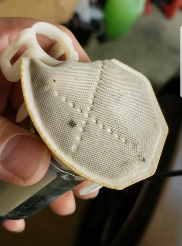

    How many miles were on the old pump, and noticed any seat of the pants improvements yet?
  19. Jan 29, 2020 at 5:58 AM
    #119
    jamesepoop
    Feb 22, 2017
    #211394
    1,117
    California
    2007 Fj Cruiser
    When I got the car, it was at 125. I've put about 50k. I have no reason to suspect it has been changed so my thought is that it is the original. The filter sock didn't look terrible. I've heard that the feeling of a new pump was like driving a new car but haven't noticed lol. I'll try to hammer it today. Installed a aeromotive pump in anticipation of a Maggie s/c.
