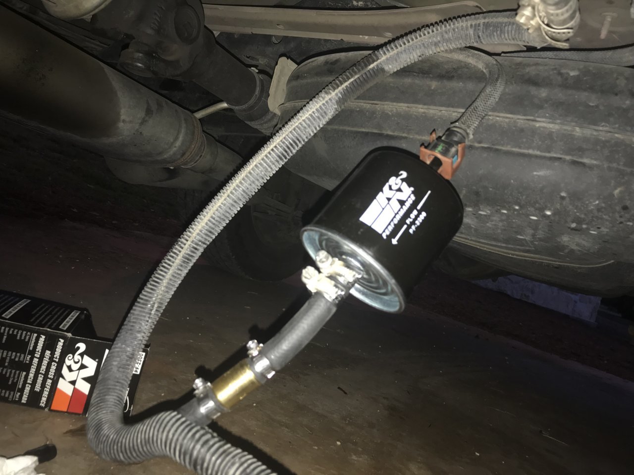

    Where abouts do we add the check valve? I picked one up just in case. Figure with the tank dropped swap it in.

    Check valve can go on the external line near the external fuel filter. I think pix were posted somewhere in this post

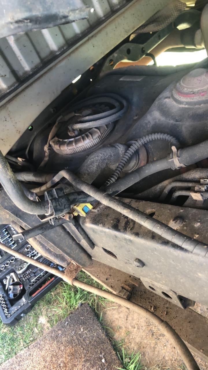

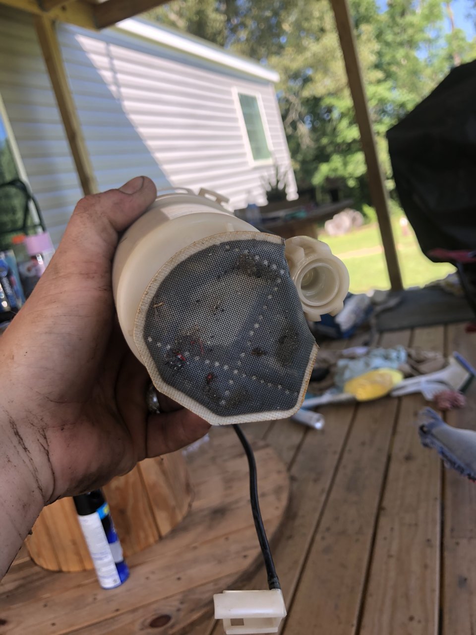

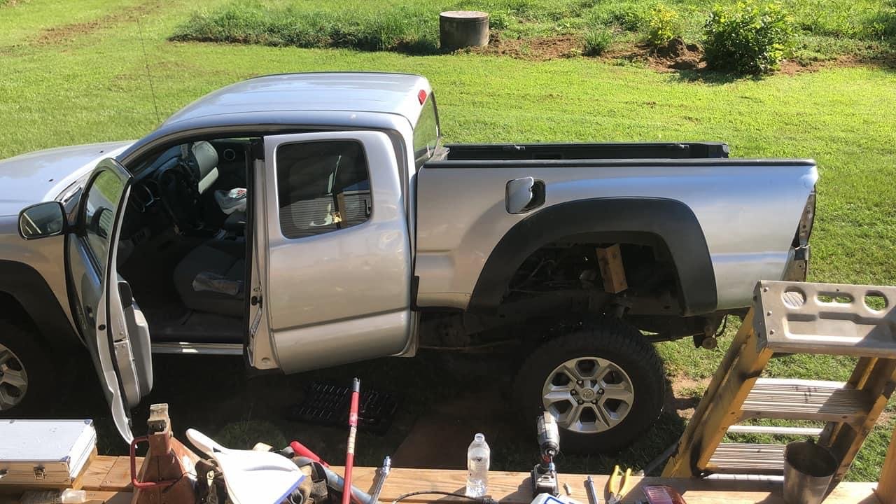

    FBB0BB7B-65CF-4304-ABF7-84B9A72C9983.jpg 898F774C-D7DA-4E1C-8AC7-45950613166C.jpg 6B86A4F5-FA3B-432D-8519-633E38AB01A2.jpg Just an update I did the swap today at 255,000 miles along with the urd tcai. I’ll know more tomorrow with the 100 miles round trip to work but so far it feels great. I won’t say it’s an improvement but I actually feel like I’m getting 100% all the time. I did go ahead and put the check valve and the upgraded summit fuel line.
