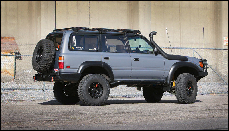

    well I sold the truck last summer, but the intake was not noticeably louder than stock with the way I finished it off inside the fender. When it was plumbed into the cab, it was unbearably loud for a daily driver. I never had a deckplate mod on that truck.

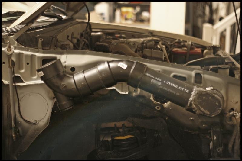

    Take a look back at how I finished mine. I left it routed inside the fender so it wasn't so loud in the cab. Better location than the stock one. You could easily have it still come out of the fender and put an inlet on it that about hood height but IMO if you're doing that you might was well do a regular snorkel.

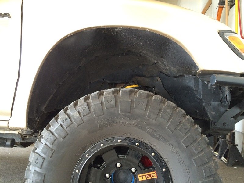

    @Box Rocket , I could be wrong but I've been trying to figure out a way to do something like this(& need to soon) but it seems like water would hit the fender and drop down into the tube?

    Not sure what you mean? The top of the fender is protected. If you don't use an inner fender then I guess you risk throwing water etc into the top of the fender and maybe into the snorkel. That's why I made an inner fender. It's also the reason that the piece I used for the opening is a Y with a lower opening at a low point so that any moisture that gets in will drain out and not drain down the snorkel.

    I thought you were running it without a fender liner so it makes more sense now… I thought about building a liner but not sure I want to bolt anything to fiberglass. :ballchain:

    Yeah, an inner fender is a good idea if you're doing this type of snorkel.
