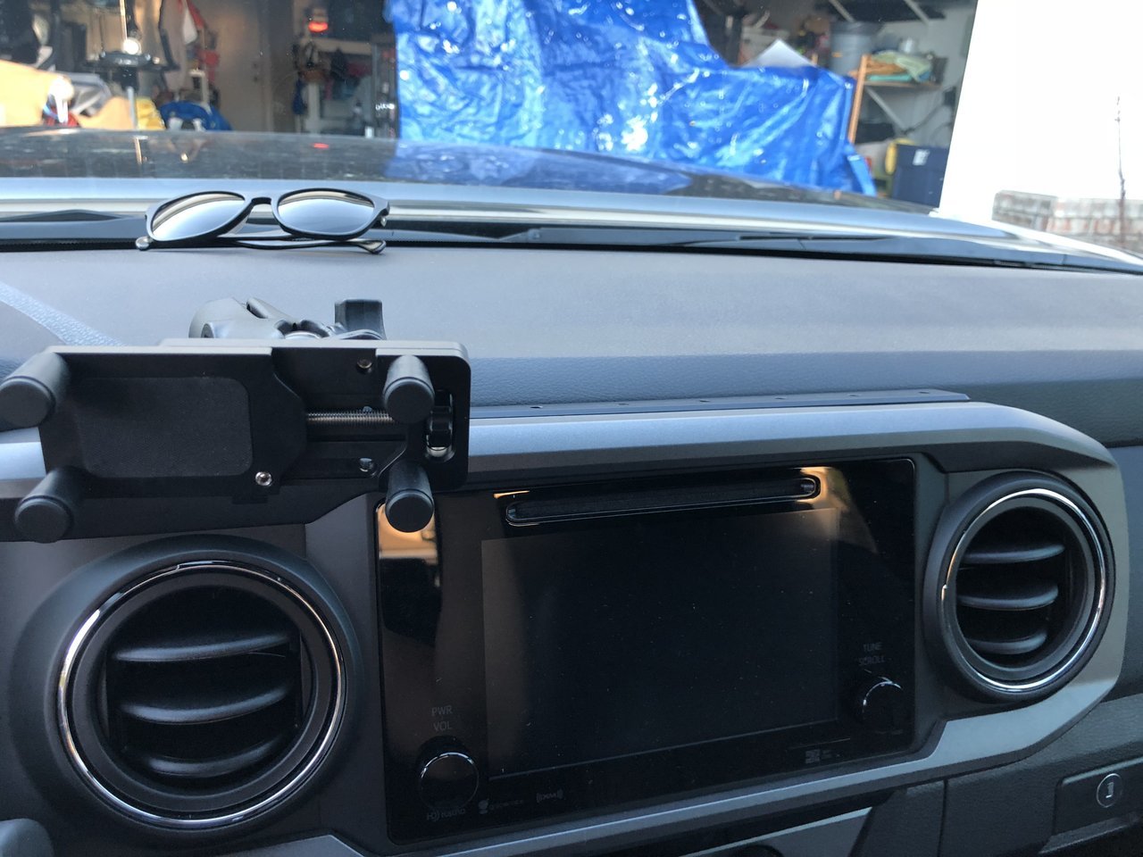

    Installed mine today!
    Pro tips:
    1) To remove the dash trim, start at the right and gently but firmly pull the trim away from the dash about an inch (not more or you'll damage the clips on the left side). This will release the clips on the right side and allow you to slip your fingers between the dash and the trim on the left side. Pull the left side away, being careful not to damage the head unit screen.
    2) Use a 3/16" drill bit with a couple wraps of masking tape to mark the holes for drilling. The tape will give the drill bit a snug fit in the pre drilled holes in the accessory mount. Give the bit a few twists with your fingers to mark the holes.
    3) Use brad point drill bits for more accurate holes. 1/4" or slightly larger will do ya. Slightly larger will be better if your holes are not perfectly located.
    4) I used the mounting holes in the instructions and found that the dash trim has a slight curve making it appear like the accessory mount is bowed slightly up at the ends. Initially, I thought moving the mounting screws further apart would reduce this effect and give you a much cleaner look. However, I discovered today that you cannot move the mounting locations outboard any further because the clips are in the way. Instead, I added a few layers of electrical tape under the mount in the middle and slightly toward the left. This gave the mount a much more level appearance and now it looks almost like a factory option.
    Here is a quick video to make you jelly of my dual magnetic setup.
    Edit: Walked back what I said in #4. You cannot change the mounting points.
