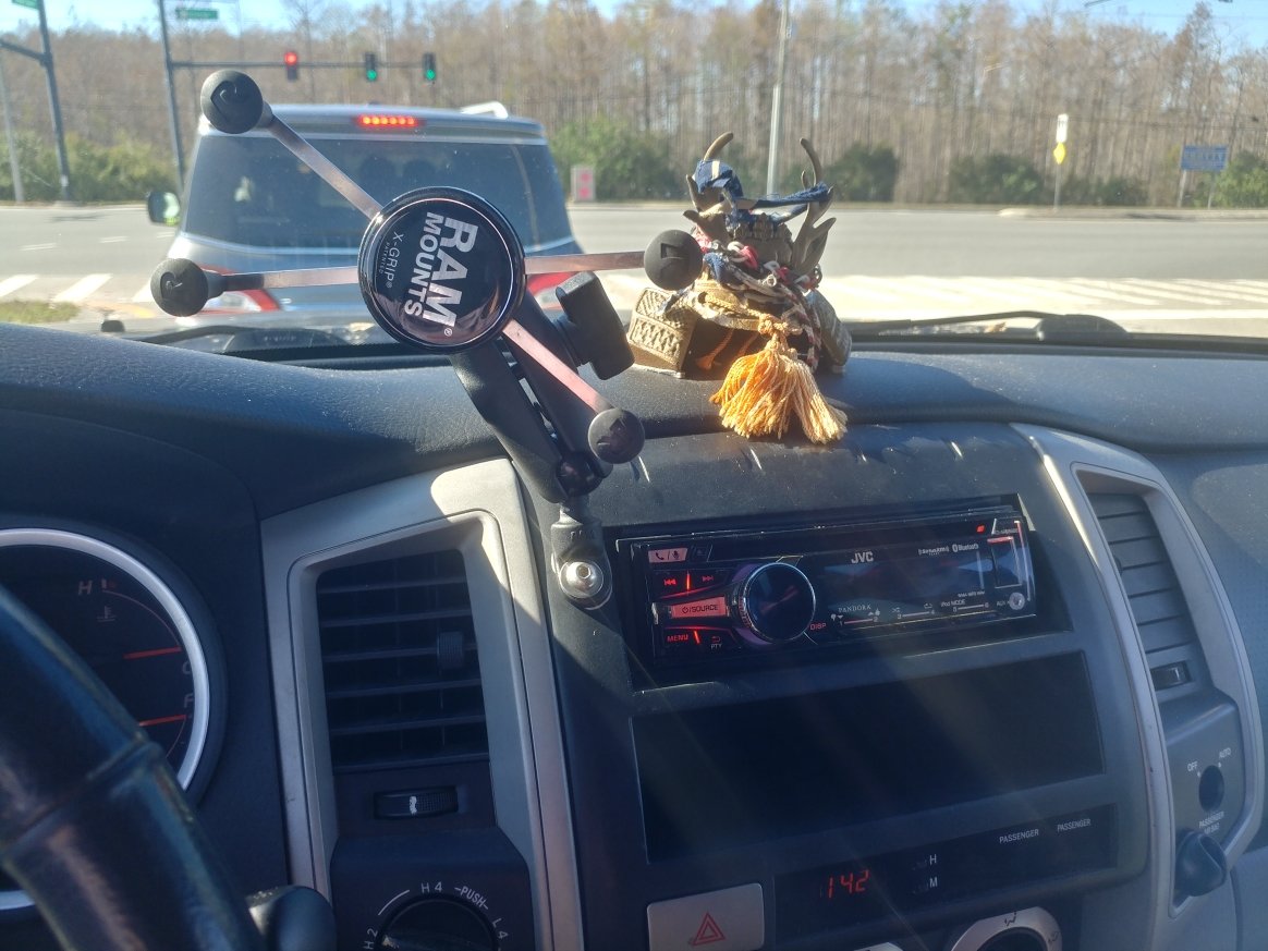

    I didn't think install of one was too bad. :D
