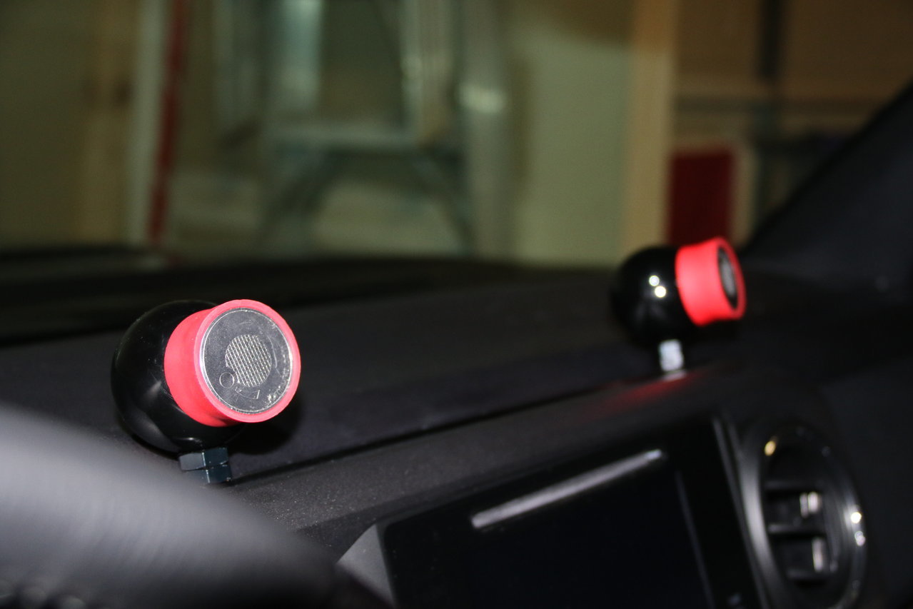

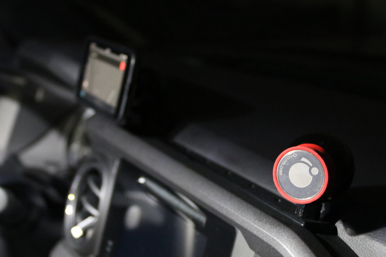

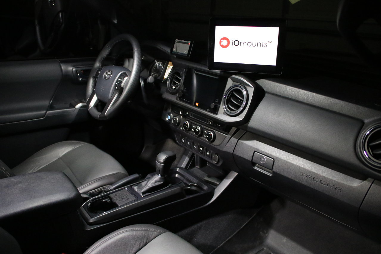

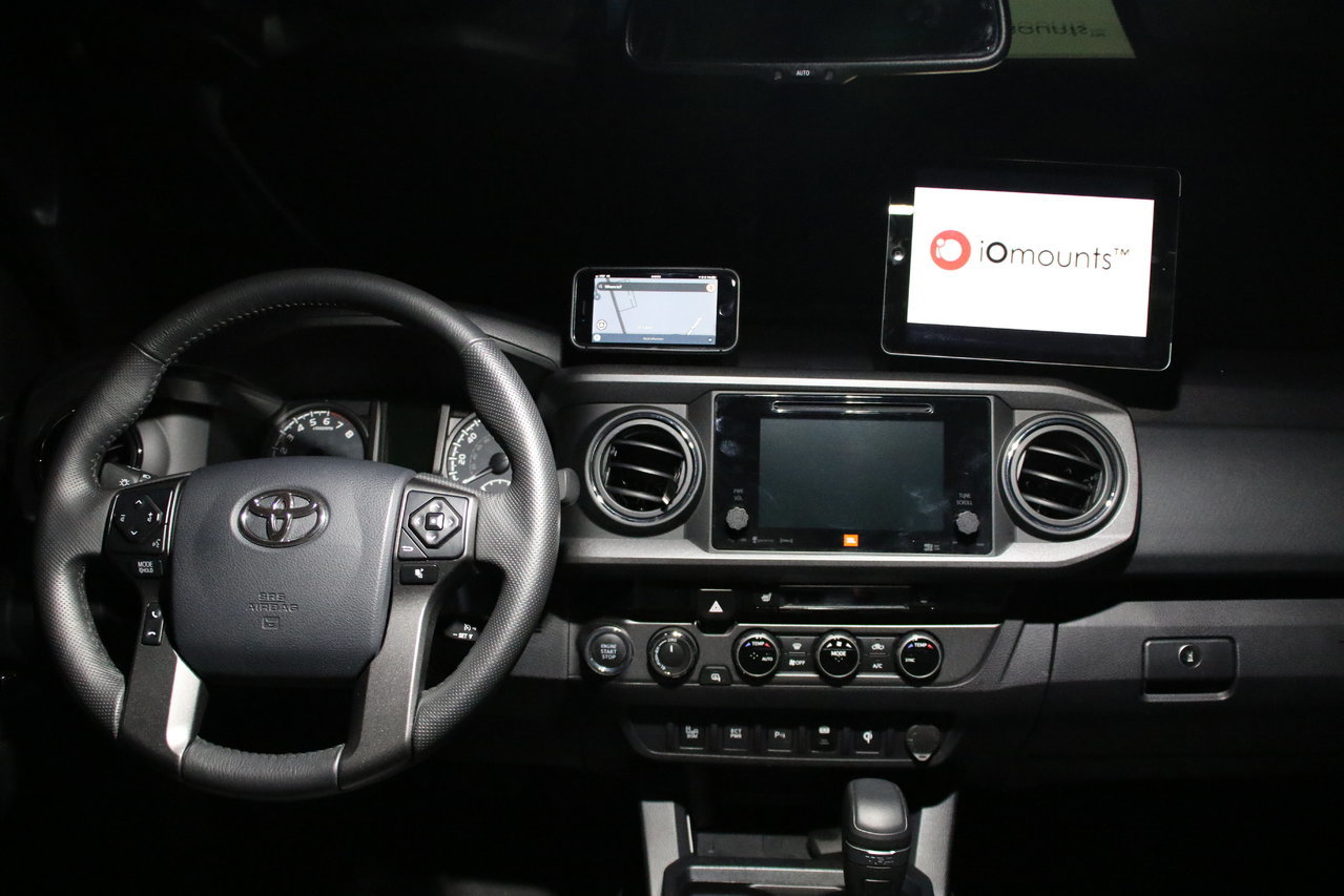

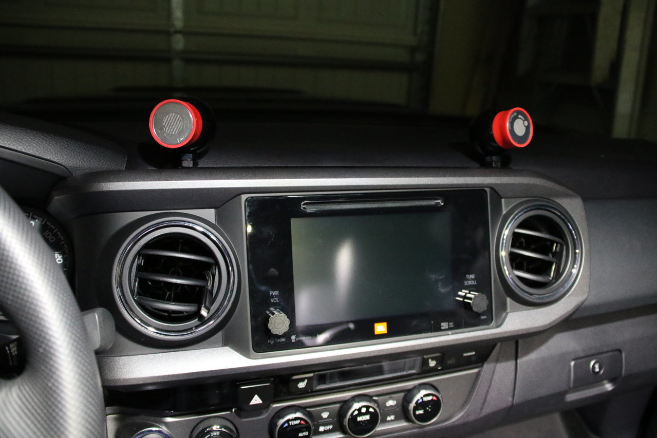

    So after a week running around, still happy with the stability of this setup. Took a couple of more pictures for @iOmounts .

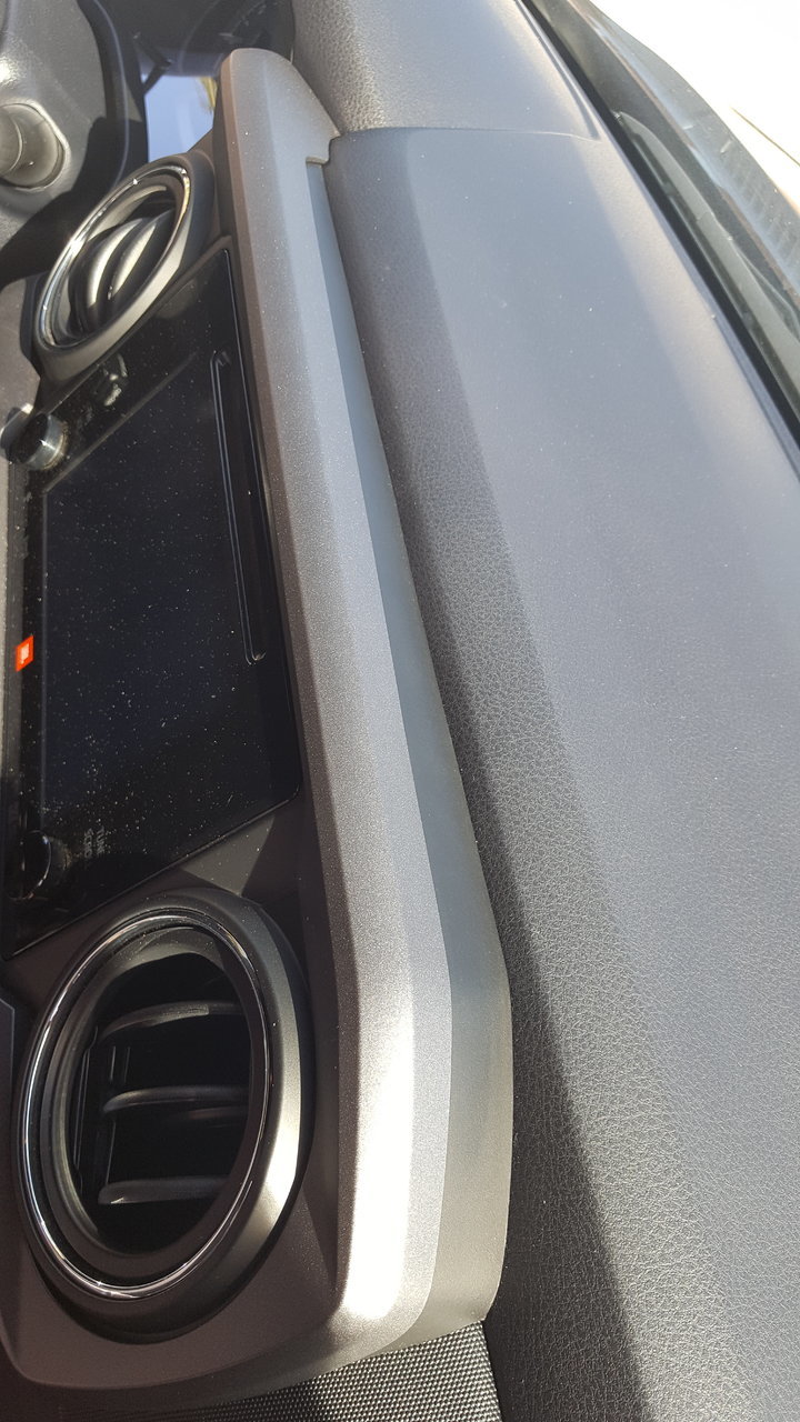

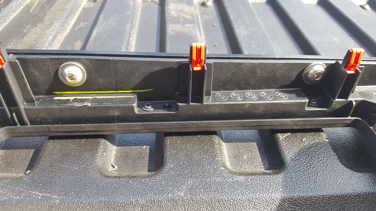

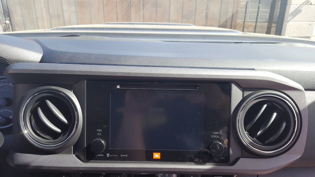

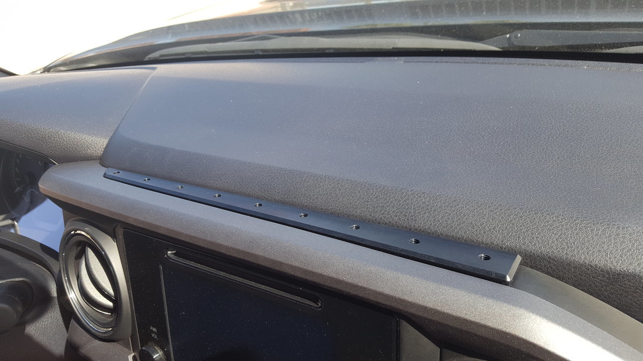

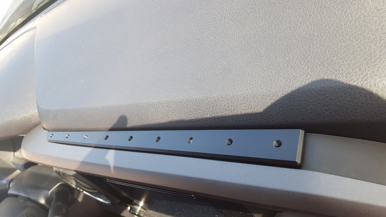

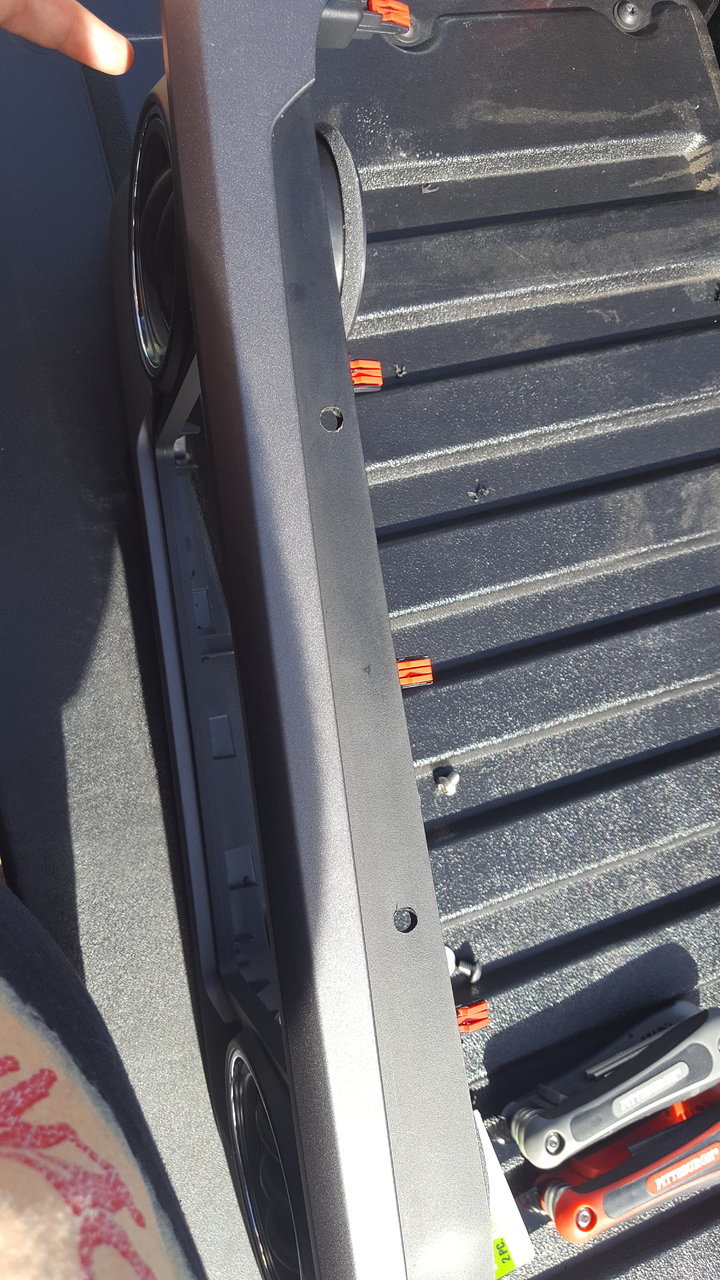

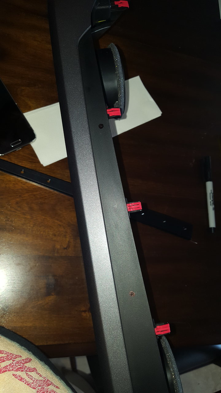

    Hey guys i got mine in cant find my Ram mounts but heres what i got and how it was done..
    Here's before..
    Now Place the mount and mark the holes 3rd from the right and 3rd from the left so the screws will be placed in the middle...
    Now drill 2 holes where it was marked with a 17/64 drill...20180211_121718.jpg
    Put the bolts with washer20180211_123242.jpg on and your good to go..
