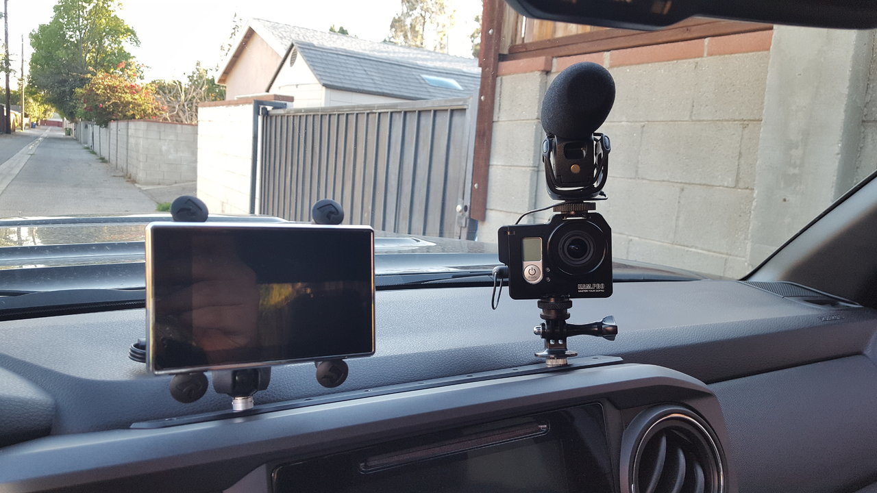

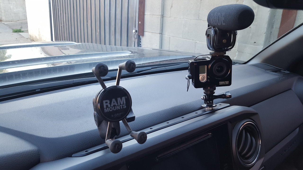

    So i mounted my Ram mounts for a monitor and a gopro... heres how it looks

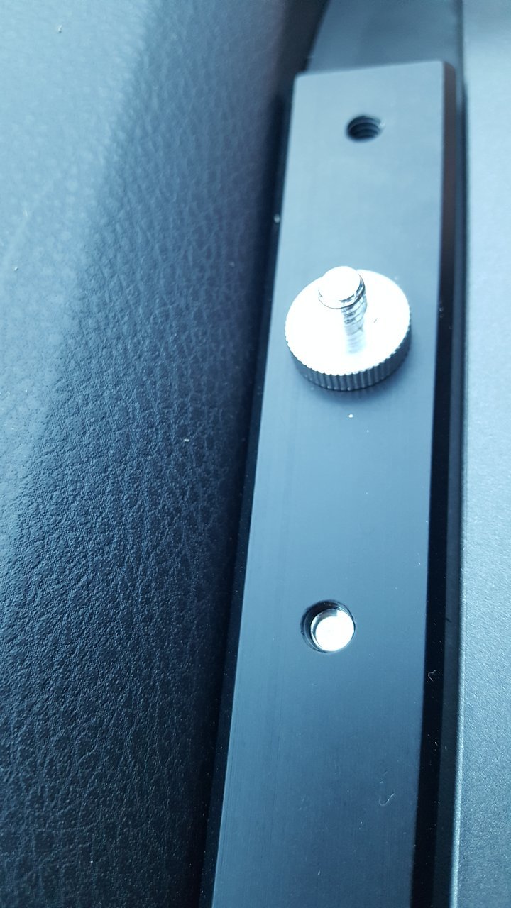

    @TurdOR89 - what is the thread on your Ram balls? 1/4 or M10 x 1.25?

    Thread is 1/4 typical camera tripod mount thread size.

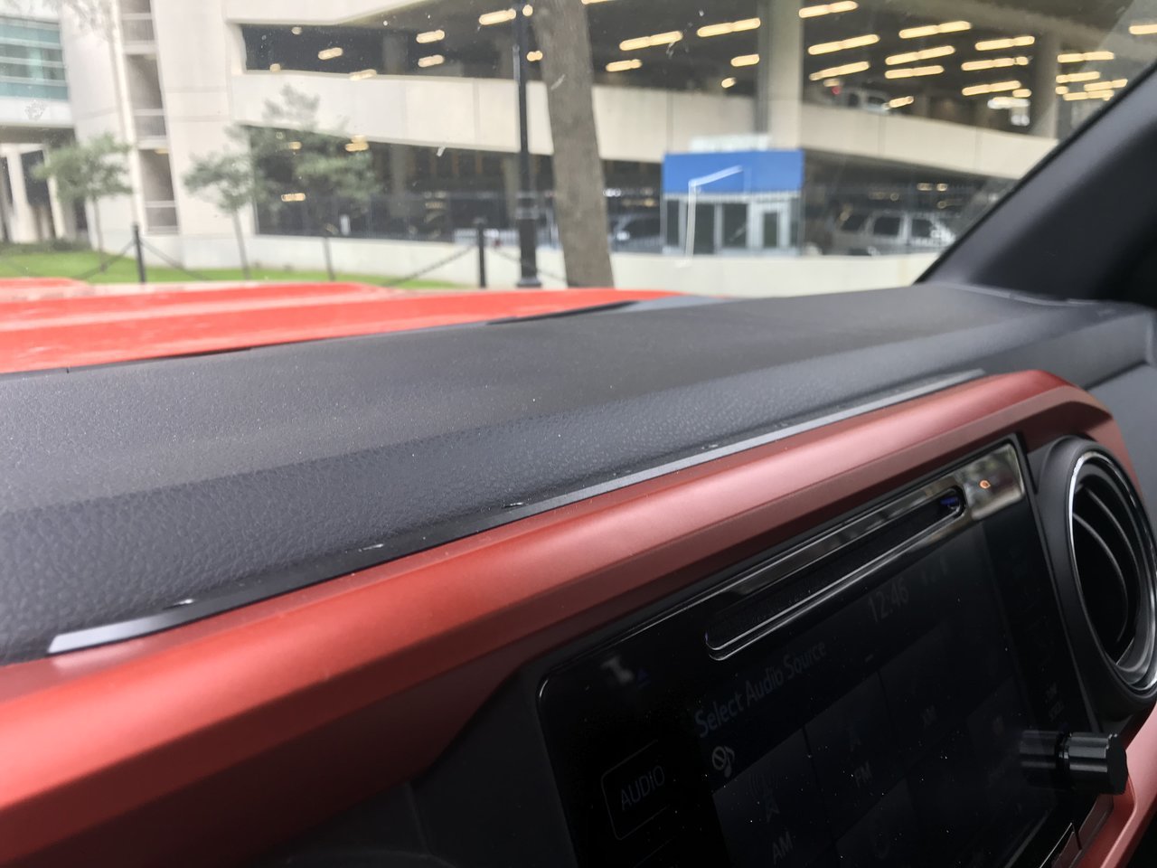

    Thanks @Lostsheep. I finally got this mounted. It’s a beautiful piece.
    I will probably move my holes that I made in the plastic. I think there is a bit of arc to the plastic so I will bolt down the ends of the bar, so it will sit perfectly flat.

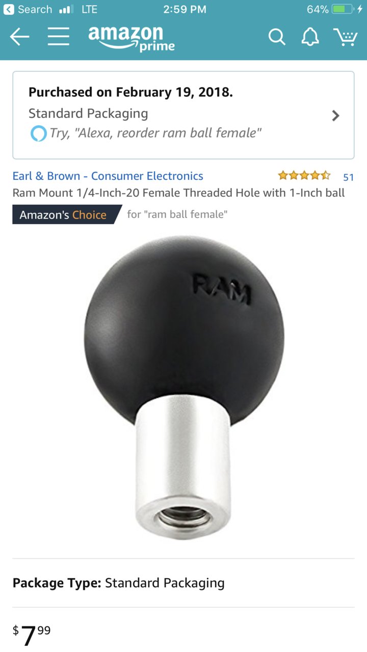

    I plan to get two screws 1/4x20, 1/2” longer than the ones provided. I will screw from underneath the far driver & passenger holes so that the screw sticks up 1/2”. The. I will
    Screw in female RAM balls. This will enable me to use the two outside holes for a mount while still having them hold down the bar.
    Will post update pic when the balls come in.
