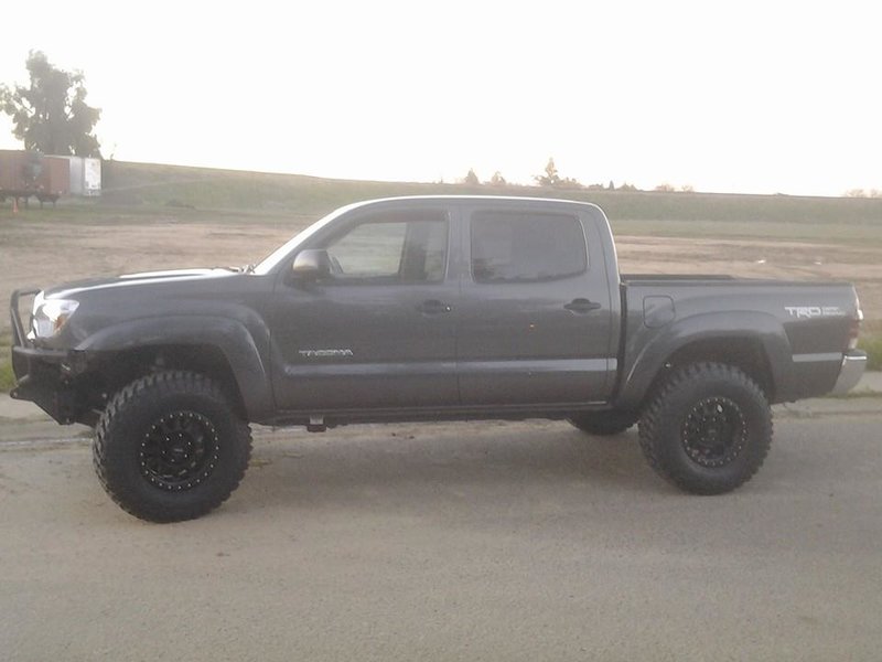

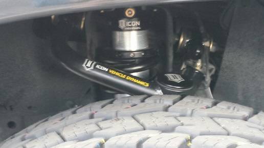

    [​IMG][​IMG]Finally got a chance to throw up some pics of my truck.
