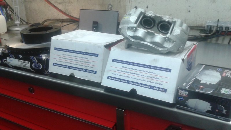

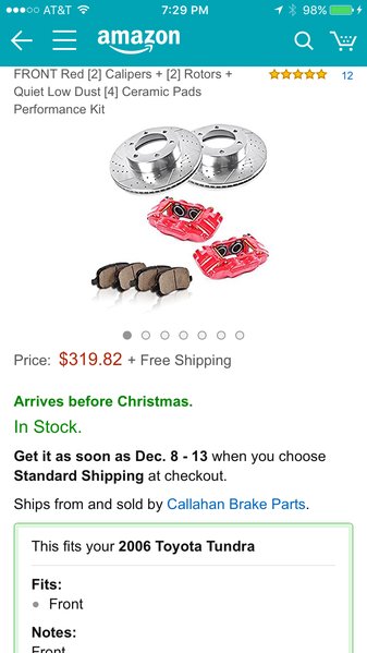

    I'm looking to do the upgrade as well. I just called NAPA and the quoted me the following:
    1. NAPA 13WL Calipers $98.99 Each x 2 = $197.98
    2. Akebono Pads = $79.99 for the set of 4
    3. Standard Rotors $57.99 x 2 / Premium Rotors $98.99 x 2
    The SS lines from Wheelers would be $72.
    Sounds about right?
    Here's a quick update I got from calling a different NAPA and checking their site in more detail. I got different numbers, but I did get part numbers for the calipers at least, so I'm more confident with this bit. Just for reference in case any of you case can find this useful:
    p.p1 {margin: 0.0px 0.0px 0.0px 0.0px; font: 12.0px Helvetica} p.p2 {margin: 0.0px 0.0px 0.0px 0.0px; font: 12.0px Helvetica; min-height: 14.0px}
    Calipers: 13WL CAL SE3263 Left Front / CAL SE3264 Right Front - $54.49 ea + core ($108.98)
    https://www.napaonline.com/napa/en/p/SEBSE3263/SEBSE3263_0206293132 and https://www.napaonline.com/napa/en/p/SEBSE3264/SEBSE3264_0206250247
    Rotors NAPA Premium - 12.55” - $74.99 ea x 2 ($149.98)
    Akebono Pads $54.49

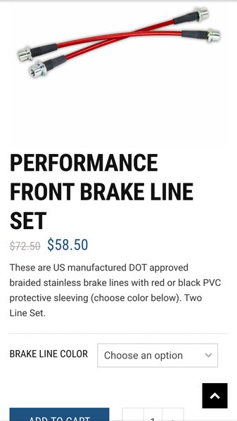

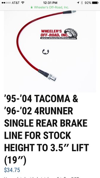

    I'm ordering the Wheeler's lines. But since I'm doing Tundra brakes, I'm not sure if I should order the Tacoma lines or the Tundra lines. Lol

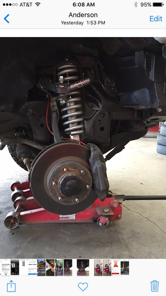

    As i previously mentioned i installed the tundra 231mm brakes on my 04 taco, the 199mm on my 00 4runner and i just installed this 199mm tundra kit on my wife's 02 4runner.

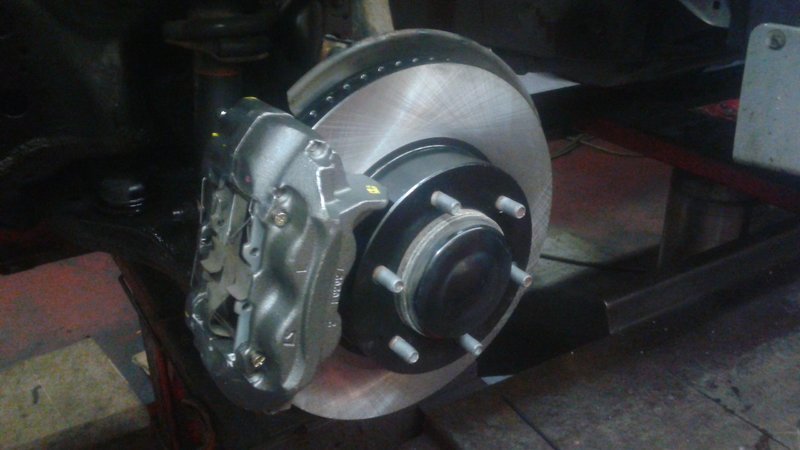

    Finished product on my 04 Tacoma. Didn't have time to paint Calipers. It was a 108 degrees the day we did the upgrade. Way bigger than my stock Tacoma rotors & Calipers
    68dave likes this.
