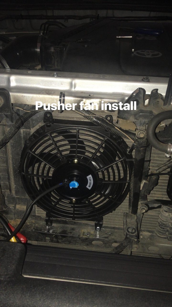

    My gf has similar health conditions that are heat related
    I just installed a pusher fan. Seems to help a bit at idle and slow speeds
    Do you know what your vent temp is ? Mine gets to 42 degrees

    You could add an electric pusher style cooling fan in front of the condenser. It would increase air flow at idle, but not make a much difference on the freeway.
    You can also install a remote start system so that the a/c will run for a bit before you get into the truck and it will be cooler when you get in.

    Got a part number to that pusher fan?

    Like this? :D

    That looks awesome! How did you with it?

    How did I what?
    Yeah mine runs 42 while driving but was 55-60 at idle which is why I installed the pusher.

    Improvement after the pusher fan?

    Sorry for the confusion, how did you install the fan?

    I made custom mounts for it.
  19. Jun 20, 2018 at 4:00 PM
    #19

    Added one of these in my Amazon cart. Houston heat sucks ass I typically let my truck run for 15 min before getting in and going home
