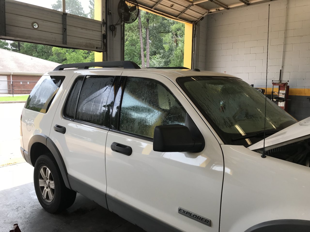

    I had this one in here the other day. Had 34 degree air after an evap core replacement. Ambient temp was around 93 degrees

    ^How have you done this.....what is this sorcery?
